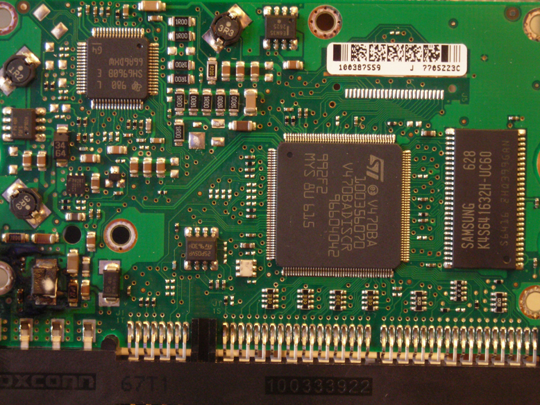

customer plugged in the wrong power adapter(laptop power adapter) to his external drive. wouldn't come up for him. i got it out of the case plugged it into our work station and got the pretty smoke cloud

this very simple.may be you change the diode will be fine.

sorry picture was on tinypic
anywho after browsing the forums, looks like i can just cut the tvs and image the drive.
correct?

Hopefully, Yes.

wahooo success thanks
