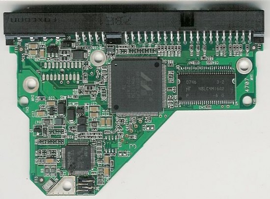

I am looking for an identical PCB. Mine is different from others I have seen posted here and does not have a U12 chip.

Rom is embedded into the CPU find exact match .

If I find an exact match, doI still have to transfer the ROM? If so, I think it's impossible because I can't desolder that CPU.
