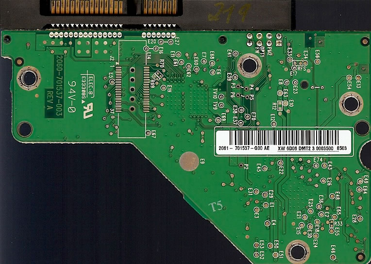

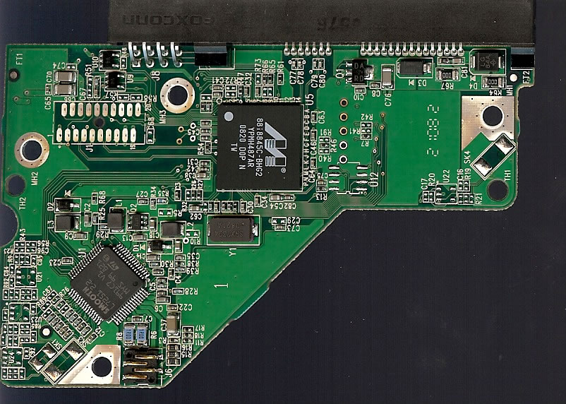

Need this PCB
Or way to repair it when i connect the PCB i have the ATA Error: ERR / ABRT

PCB is damaged... are U sure...?

Yes i am sure i make a hotwap
yes with other PCB the drive get DRD DSC.
It´s not 100% compatible because the model is the same wd1600aajs-xxxxxx ( this are different)
i try a hotswap, and i can test heads 100% ok.

Hi Mikippp,
You are right :) is not PCB problem.
Need ROM or the FW for this disk ?
Can you please see if you have it to share with me.

Pinnacle ROM

Yes the disk is from the Family Pinnacle.

rewrite ROM
