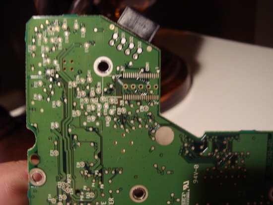

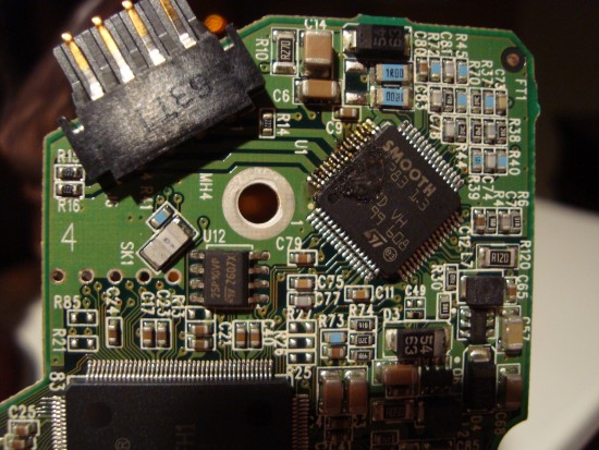

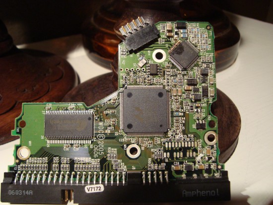

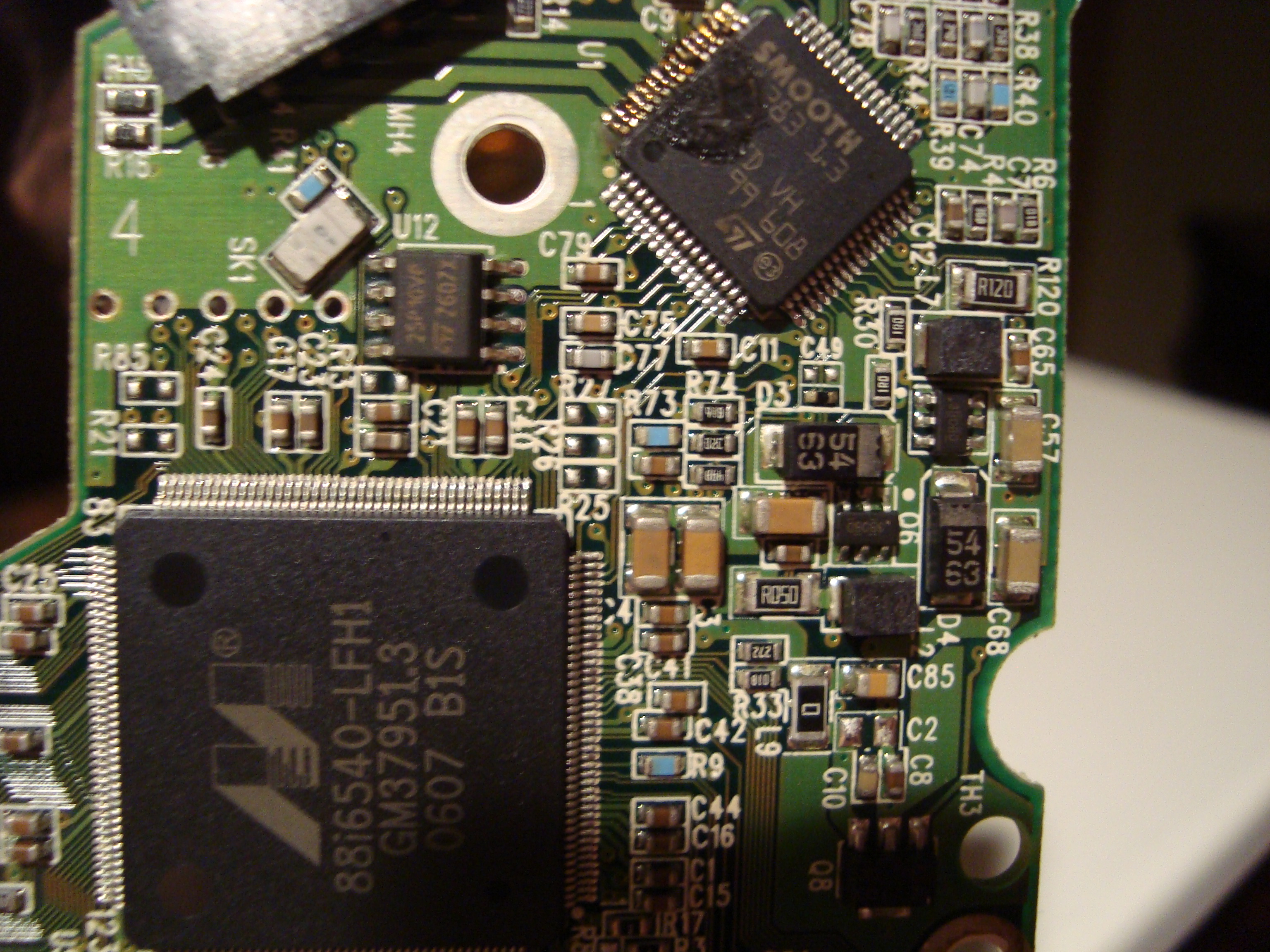

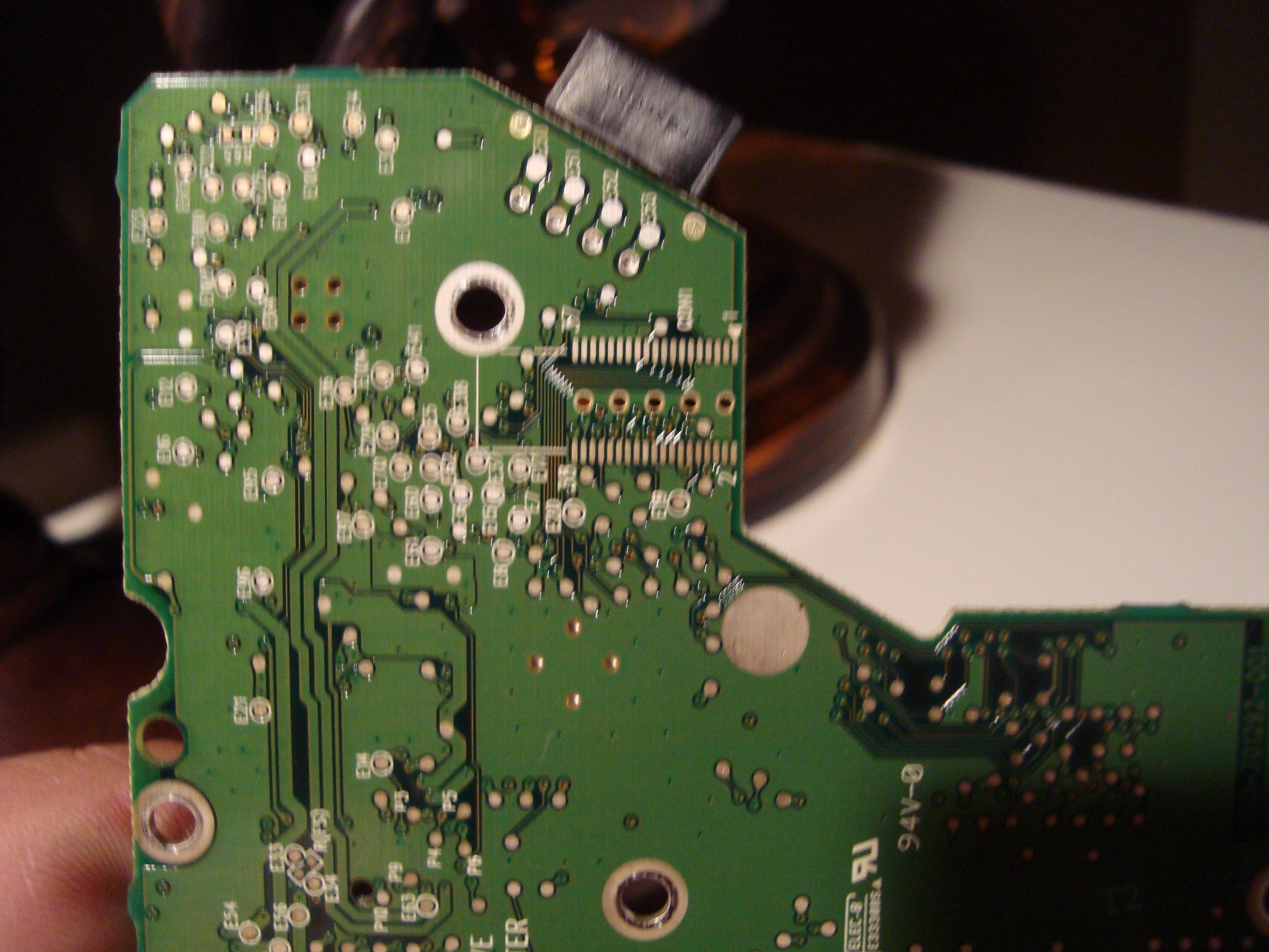

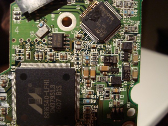

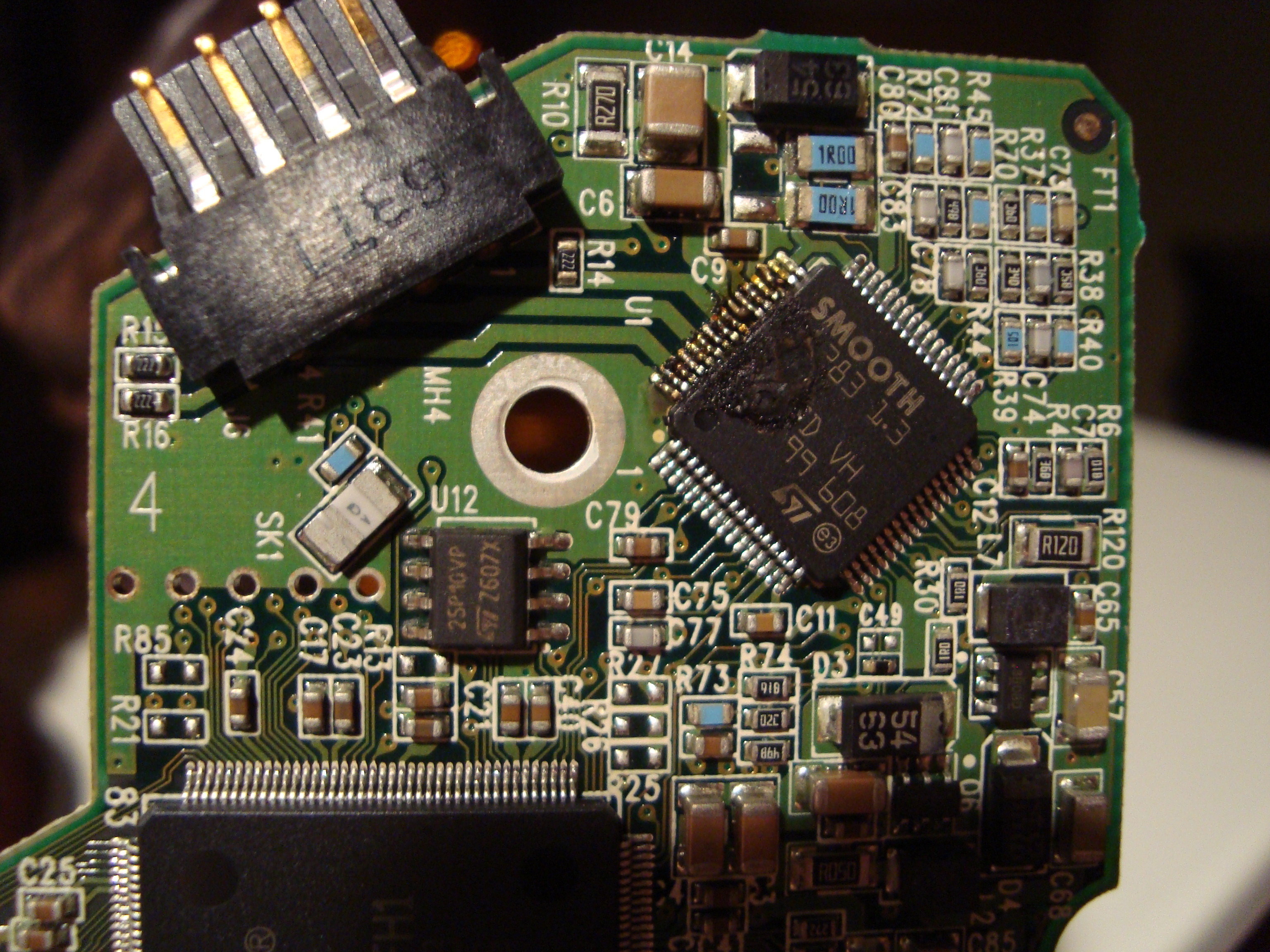

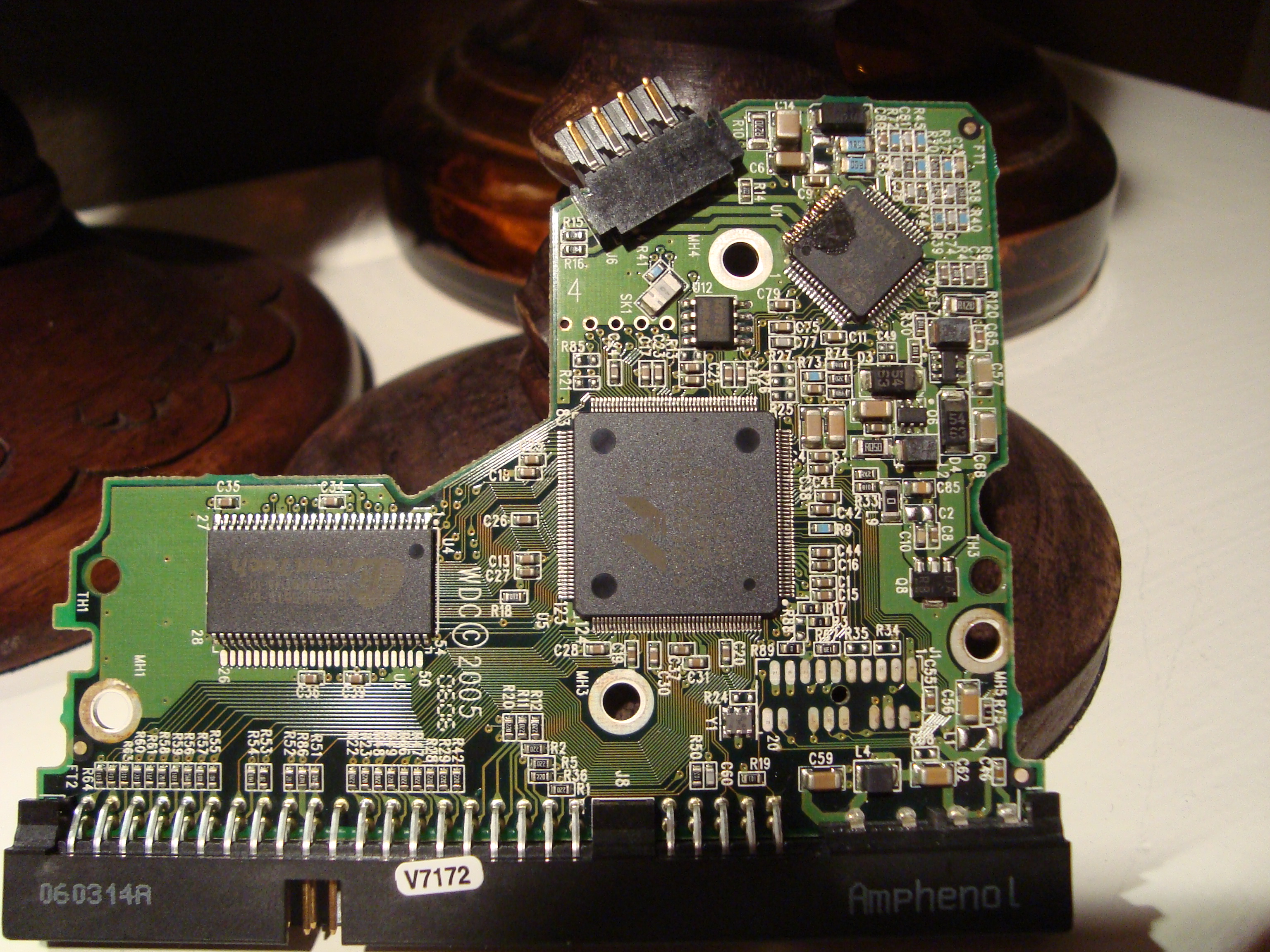

I was told maybe I should post a pic of my board. So here it is maybe it's not even savable!
File comment: Rear of board
File comment: Burnt Chip
File comment: Front View

The SMOOTH chip is the motor controller. I would check the motor windings for shorts with a multimeter. There appear to be three phases and a common terminal.
You will also need to transplant the EEPROM chip at U12 from patient to donor. This chip stores unique, drive specific calibration data.
