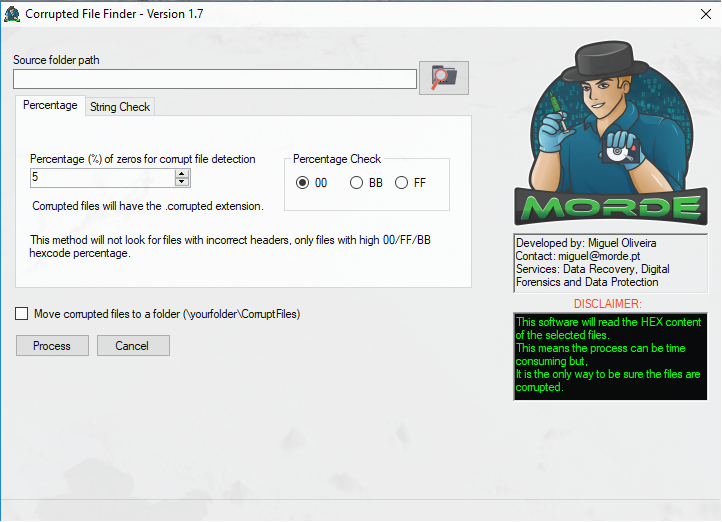

 Post subject: Re: Corrupted File Finder
PostPosted: November 23rd, 2018, 13:54
Posts: 413
Ok so.
Some bugs* were fixed and:
added suport for DFL default <unreadable>
added support for MRT fill !bad option
bugs*:
0KB files we're not being marked as corrupted.
Maintaining directory structure on corrupted files folder
Still on work:
Displaying file hex content on a box
Creating a Snap2HTML report of the corrupted files (still being considered)
I'm also open to sugestions from users as to other functionalities of this software so please be my guest and ask for it.
PostPosted: November 23rd, 2018, 16:01
Posts: 738
Location: Ottawa, Canada
Actually, I think <unreadable> is the Rapidspar fill pattern, but no matter.
PostPosted: November 23rd, 2018, 18:06
Posts: 413
LarrySabo wrote:
You are right, my typo. Fixed :)
PostPosted: November 25th, 2018, 20:49
Posts: 413
So, weekend updates:
Two kinds of operations:
Check for 00 or FF or BB percentage in a group of files
or
Do a string check:
User will input is string in hex and the software will run and marks the ones found with such string.
Working now on a auto-update feature so any changes will be made to all users.
PostPosted: November 25th, 2018, 20:54
Posts: 738
Does it scan folders and sub-folders recursively or does the user need to select each folder individually?
