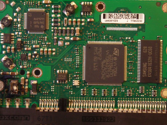

customer plugged in the wrong power adapter(laptop power adapter) to his external drive. wouldn't come up for him. i got it out of the case plugged it into our work station and got the pretty smoke cloud

 Post subject: Re: wtb seagate pcb st3160812a fw 3.aak date code 07065
PostPosted: October 27th, 2008, 0:08
Joined: September 28th, 2008, 0:30
Posts: 34
sorry picture was on tinypic
anywho after browsing the forums, looks like i can just cut the tvs and image the drive.
correct?
PostPosted: October 27th, 2008, 2:39
Posts: 935
Location: NJ
Hopefully, Yes.
 Post subject: [fixed] wtb seagate pcb st3160812a fw 3.aak date code 07065
PostPosted: October 27th, 2008, 16:56
Posts: 34
wahooo success thanks
