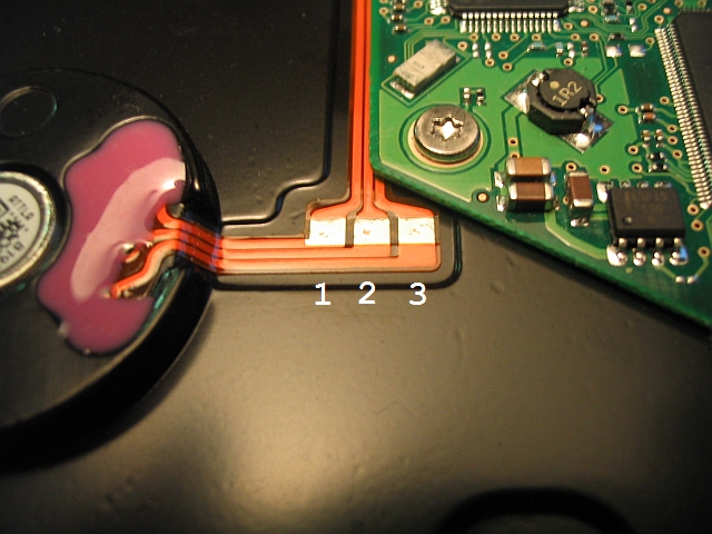

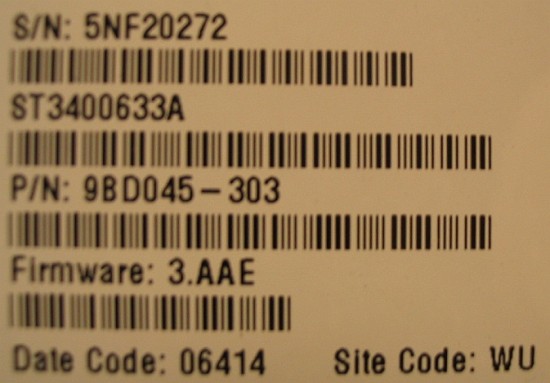

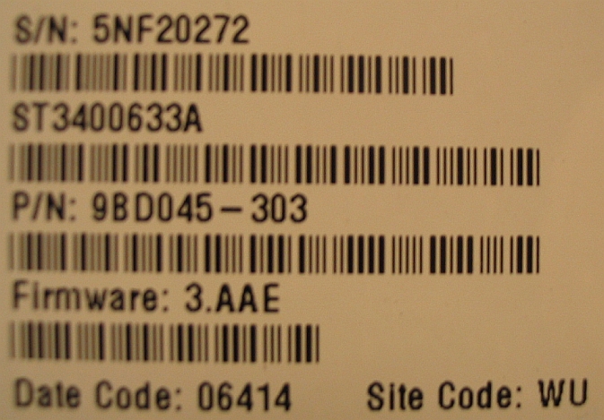

I recently did something very stupid and am trying to fix it. I accidentally plugged a molex connector in backwards with the computer running and smoked my friends hard drive. :oops: I know...never, never etc...I'm still kicking myself. A 400GB drive and it was packed FULL of data that he needs back. I think it was the 5V TVS diode that blew, but not sure. Do you think I did more damage than just the PCB? The drive spins up and is recognized by name when connected to a IDE>USB adapter, but doesn't show up in "My Computer". If someone has a matching PCB or entire drive, I'll buy it and give it a try unless you think it's a lost cause. Any help from the experts here would be GREATLY appreciated, as my friend is not very happy with me right now :oops:
Drive Info:
Seagate ST3400633A 400GB 7200.9
P/N 9BD045-303
Firmware: 3.AAE
PCB Info:

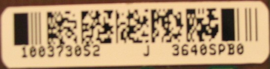

Board# 100368182 REV A
Sticker# 100373052 J 3640SPB0

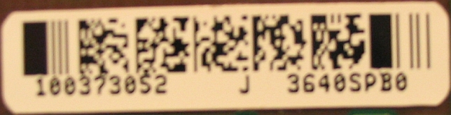

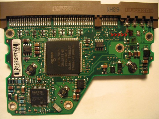

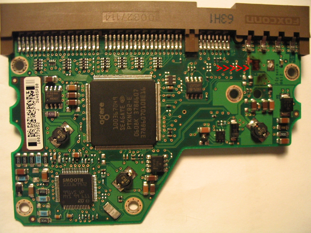

here's the pics, thanks guys
After pulling it from the dead computer, I've only tried it with the USB adapter. After seeing it being recognized as a working USB device, and then not being visible in My Computer, I stopped diagnosis right there. You see in the pics that it definitely needs a PCB anyways
sniff sniff ....... what's that smell???

 Post subject: Re: Wanted: PCB or whole drive - Seagate ST3400633A 400GB 7200.9
PostPosted: November 5th, 2008, 3:00
Posts: 1151
try to change the diode that your mention. must be carefully the plastic between the drive & PCB. check the chip temperature when power on :)

I'm afraid there is deeper damage on the PCB than just the TVS. I've seen other threads in this forum that mention not needing this diode for the drive to work, at least temporarily. You can see the exposed trace on the board. I'm afraid it got real hot there. I'm going to re-mount the PCB on the board and see if it works connected to an IDE controller (as magneto[b] suggests)[/b] on a working computer. (I also toasted his mobo :cry: )

The drive should work in this position .

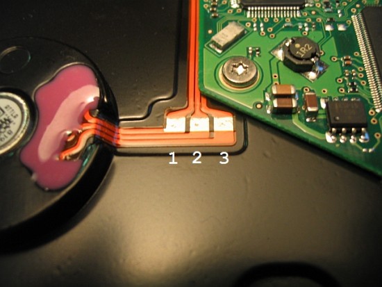

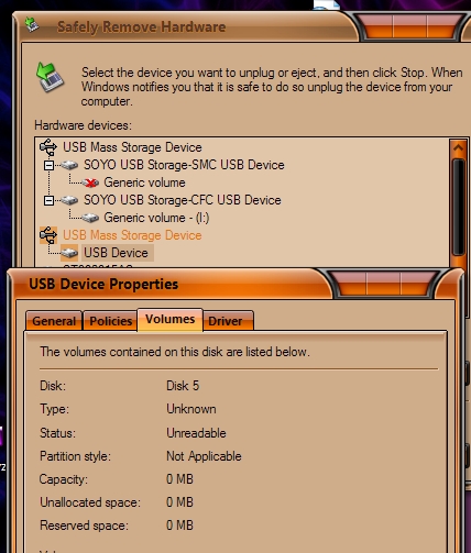

well, it's getting worse... I re-mounted the PCB on the drive and connected it to a working computer as a master drive on the primary IDE channel, powered up, entered the BIOS and saw no drives in the list. I removed it from the comp. and re-attached it to my IDE>USB adapter and did not get the same results as the last time I connected through the adapter. This time I only get the "USB device connected/disconnected" audio alerts. No balloon popups about Mass Storage Device, Disk Drive, drive name, or Device Ready to Use. Only those damned audio alerts and a listing in the "safely remove hardware" box (see attached screenshot) I listened with a stethoscope and never even heard the drive spin up. So, yeah, it's gotten worse... Maybe I damaged the PCB even more by removing/f***ing with it. Static maybe, who knows. Is there an easy way to test the drive motor to see if a replacement or repaired PCB is worth it?? I see three exposed metal pads embedded in the ribbon cable leading to the motor. Can I test the motors' voltage supply there, or even power up the motor manually through them?? I know how voltage can be present in a circuit, but the circuit has high resistance/poor connections and not be able to carry the intended load. If the motor can be tested there, can someone tell me which pads and what voltage to test for/apply?? (see other pic) I'm assuming 12V, but no clue on pad numbers.
Thanks again everyone, I appreciate the help :D

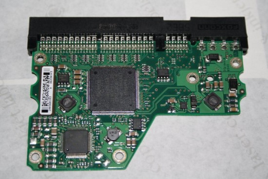

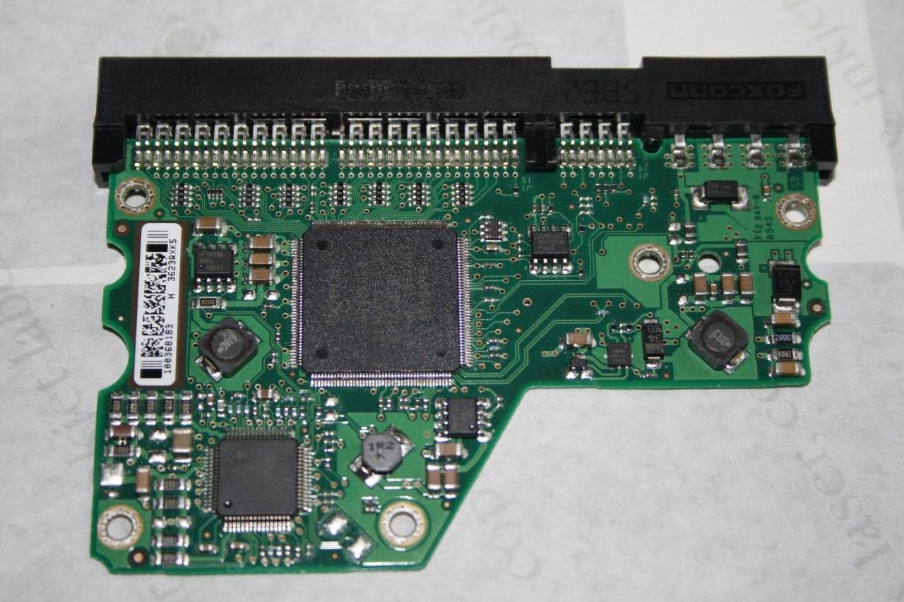

i have this pcb donor if you want. pm me pls
File comment: st3400633a
