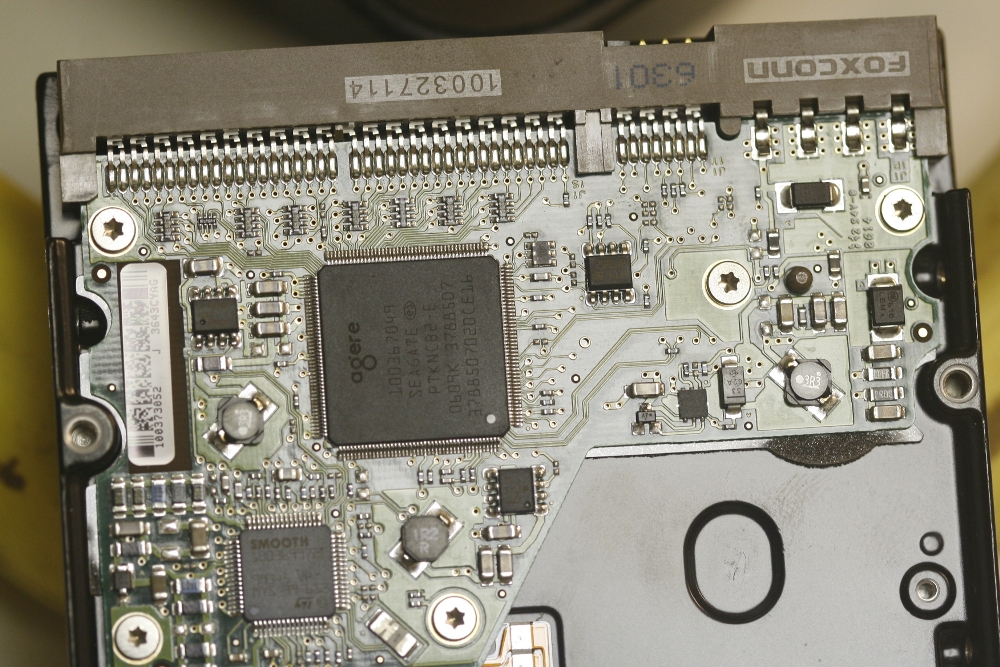

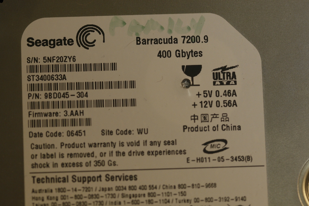

 Post subject: Looking for PCB for Seagate ST3400633A 400GB PATA drive
PostPosted: January 22nd, 2009, 23:48
Joined: January 22nd, 2009, 23:27
Firmware 3.AAH.

I have not opened the drive (yet), but I cannot access the data on it. When the drive spins up, it makes an intermittent 'click' sound about every 2-3 seconds. So I am looking for a replacement controller board as a last resort attempt to get the data from it. I sent the drive to a data recovery shop and they were able to access the data, but then wanted $2500 to recover it. That was more than I was/am willing to pay (although it may be a fair price from a market point of view).

I'm not sure You have not open this Drive... You can see the Screw label have broken...
Sorry to tell you clicking mean Head Problem. and PCB swap will not help you anymore...

Yes, it's head/platter problem for 99% sure. The DR shop MUST have opened it to change the heads and access your data.
$2500 seems a bit high, but $1000 is not unreasonable.
I would be at all surprised that now you have refused to pay for the recovery,even if the heads are changed, your data is no longer accessible.
