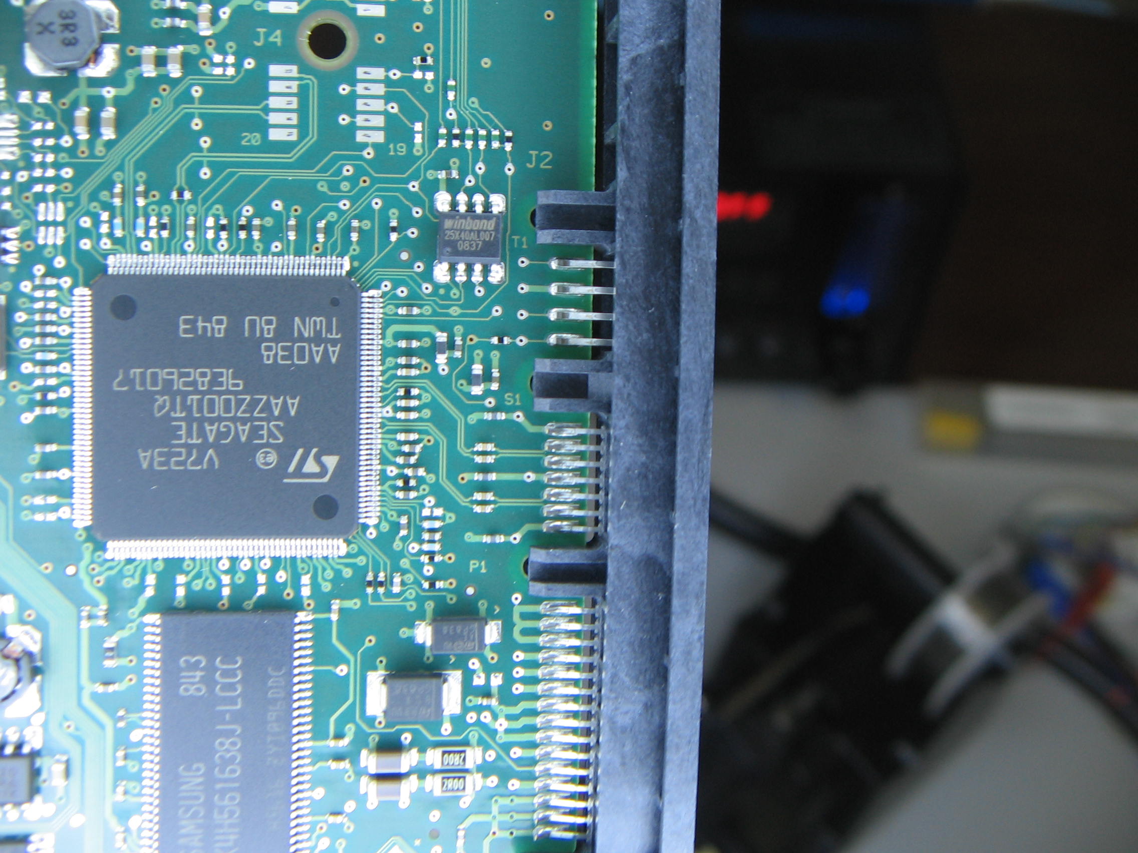

 Post subject: Seagate 1.5 terrabyte - looking for a pcb

The model # is ST31500341AS

You do realise a PCB swap won't work?
Unless you physically move the ROM.

PcImage - No, I didn't realize a pcb swap would not work. I've been doing some searching online to get more info about the ROM... do you have any sites you can point me to that explains more? Thanks

It's a 8-legged chip with p/n something like "25P40VP"

Looks similar to this
