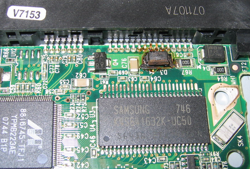

Exact info:
WD5000AAVS
WD Caviar GP
MDL: WD5000AAVS-00ZTBO
DCM: HBNNNT2CB
DATE: 11 DEC 2007
PCB: 2061 - 701477 - 200 AB XW 5W02 OR44 0005230 8235
Don't now why but it shorted and and smelled burned see picture.
I need the PCB but a complete drive with a working PCB would also bee nice!
Place to ship to: The Nethelands.
Thanks,
Simon

Dear Simon,
you can try to remove D3 & test again firt. please contact me by email if still no work. i have for sell. thanks.

networkpc3000 wrote:
Dear Simon,
Do you now where I can find the data to test the board when I have replaced D3.....

Hi, Simon
Pls try to remove D3 and see if your HDD work or not.
we have this working PCB, but for this new WD ROYL version, rom program have been joined with the main chip, it is hard to deal with by personal, so we suggest you to find a pro near you.
