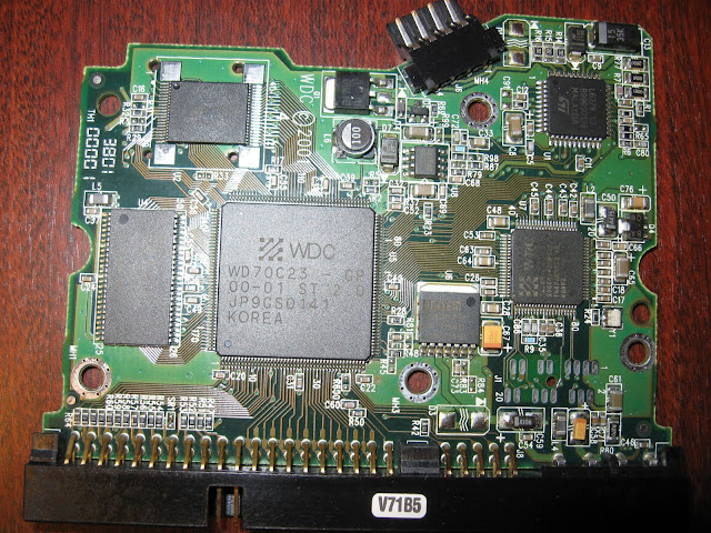

Here is a picture of my PCB. Wondering if someone could point out where the ROM chip is in case I need to a swap if I can't find a replacement PCB. Thanks!

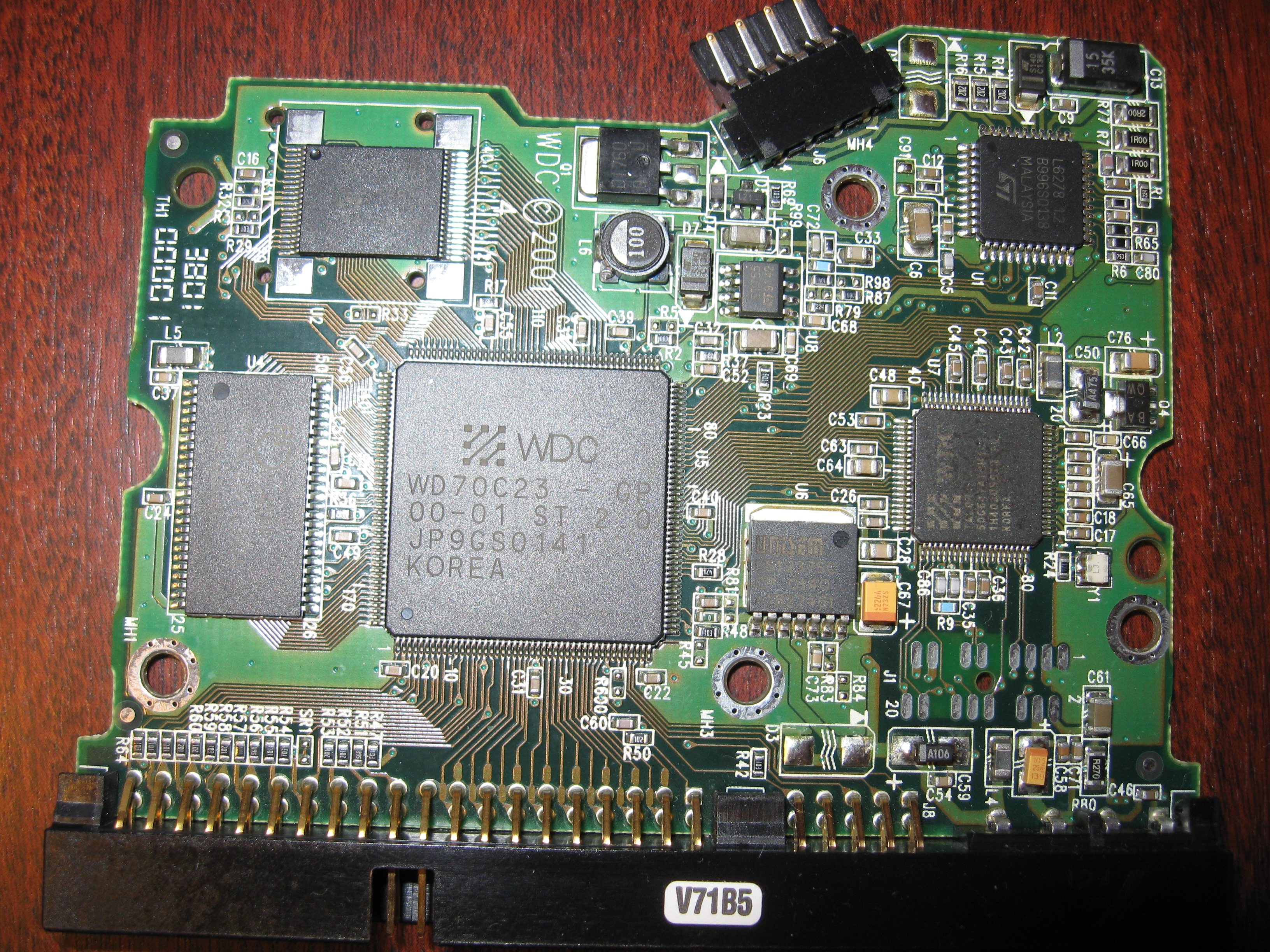

Hey guys I attached a picture of my PCB. I was wondering if someone could point out the ROM that needs to be swapped out if I I can't find an exact replacement PCB. Thanks!

Its U2.
