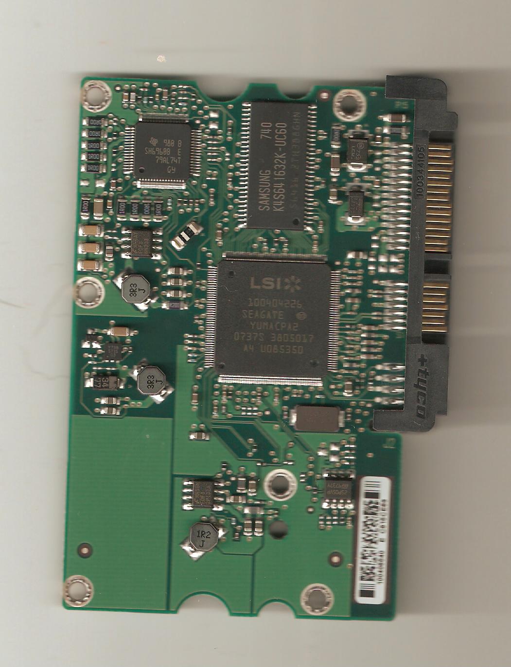

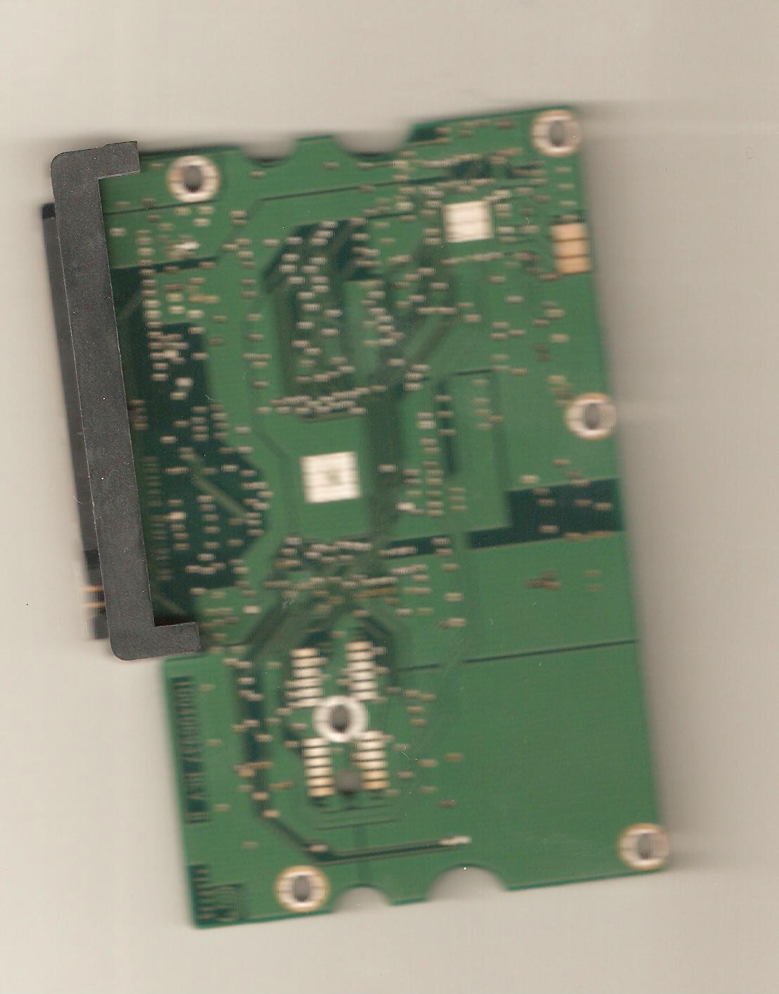

Hi.
the hard drive suddenly died, it beeps and doesn't works. could it be the pcb? or did i lost the hdd forever?
hdd info:
ST3500830AS
P/N: 9BJ136-224
FIRMWARE: 3.AAD
DATE CODE: 08176
SITE CODE: TK
pcb:
Thanks for helping.

The drive seems to spin up, i can feel something.
so, what to you guys suggest?
 Post subject: Re: Need Part for faulty HDD
PostPosted: October 29th, 2009, 15:38
If it spins and beeps, then a pretty good chance the heads are bad.
PostPosted: October 29th, 2009, 18:07
Posts: 1419
If you feel a little vibration and it beeps, it could be a siezed motor also.

and do i have any solution to recover the data? (that i can fix on my own, like replacing the pcb)
PostPosted: November 2nd, 2009, 17:26
Sorry, but in a word, no. :-(
PostPosted: November 3rd, 2009, 19:12
Posts: 1151
I think platters has been damage already.
