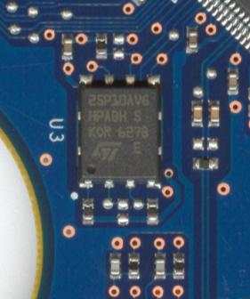

 Post subject: PCB Urgently required
PostPosted: October 30th, 2009, 12:35
From a Travelstar 7K320
First 2 lines of PCB....
0A57126
DA2357B
Cheers!!
Sean

In this PCB usually is used external ROM chip...
U can use any 7K320 PCB...

hi,
it had ROM. but still had to find match one.
