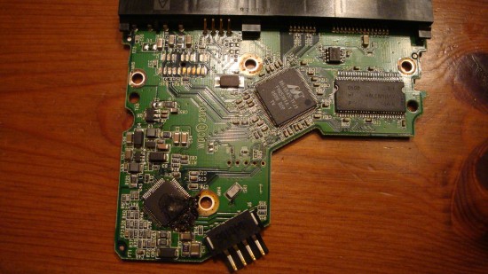

 Post subject: Re: Looking for PCB board for WD2500KS
PostPosted: February 28th, 2010, 22:54
Posts: 17263
Can you upload a detailed photo of the component side?
What is the failure symptom?
PostPosted: March 2nd, 2010, 21:46
Joined: February 28th, 2010, 17:18
Location: St. louis/Mo

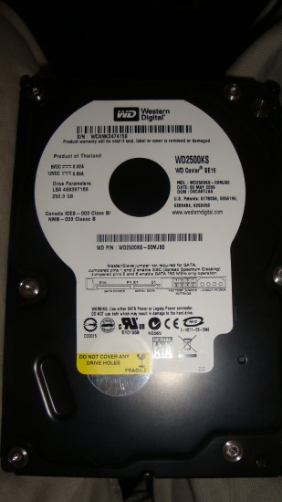

here is a pic of the board and the top of the drive.
the full number on the bottom of the drive is
2061- 701335-C00 AG XC 2W130N8S B 0004400 6404
File comment: board is burned bottom left
File comment: top of drive
PostPosted: March 2nd, 2010, 22:16
Posts: 17263
Your motor controller chip is damaged.
You will probably need to transplant the 8-pin serial EEPROM chip at location U12 from patient to donor. This is because it stores unique drive calibration data.

wont i be able to just swap in a new board?
PostPosted: March 3rd, 2010, 4:18
No, you need to transfer U12 also.
