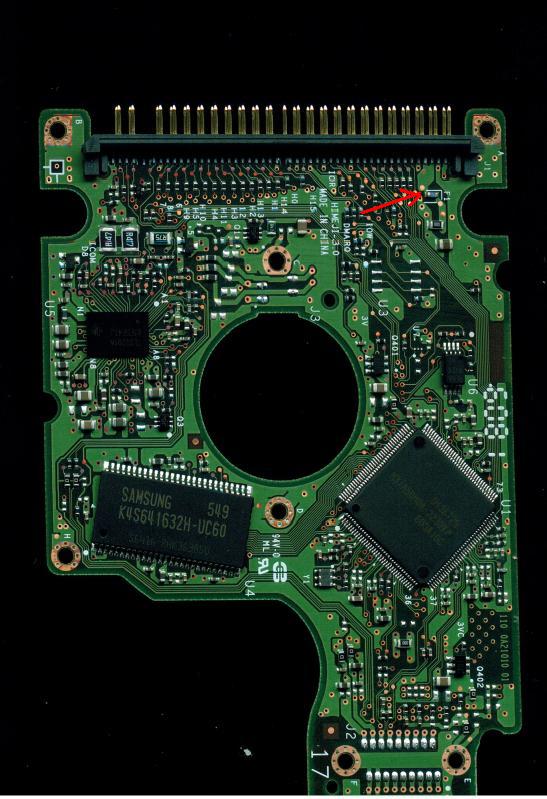

I have a Hitachi HDD, #13G1583, MLC# DL1175, serial XGGLNE1M, board part number 0A26798 Da1188A Xzz609 54VZ.
Basically, I removed this from a notebook in order to do a backup (oh, the irony, as you'll see). It was working fine just before this. It was getting pretty full and I needed to clone it to a larger HDD. For some reason immediately after this, I could not get it to read in the desktop where I do cloning, and no enclosure would see it either. I tried every jumper setting on my 2.5" to 3.5" adapters after this and tested known good drives with every adapter and enclosure I have (the known goods were fine). Frustrated that this drive wouldn't be seen in anything, I finally put the drive back in the notebook thinking, "Well it worked in there, I'll just put it back and see if I can just get an image from there", and then nothing. The notebook acts the same whether there is no drive there or if the drive is installed. No sound from the drive, no spinning, just nothing.
So, I'm hoping someone has this board available, but I'm definitely wanting to hear your professional opinions on whether you think this is what's needed, as I have almost no experience with board swapping.
Also, maybe some insight into what might have went wrong would be great. I'm really stumped as to what could have happened there.
Hope you can help and I very much appreciate all you might be able to offer.
Thanks very much!
-Rob

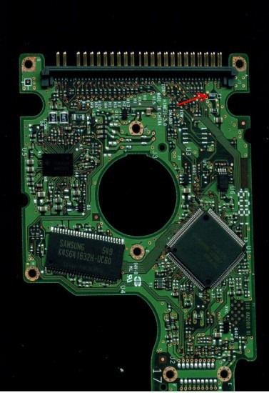

Sorry I had to add a second post. For some reason, I could not edit. Here's some pics of the drive.
-Rob

My apologies, I attached the wrong pics. Here are the correct ones.
-Rob

Hitachi notebook drives are not interchangeable, they have pretty-much unique info programmed into the PCB.

Well, the best way would be to seek pro help, it should be pretty cheap if it's "just" a PCB problem.
Or you could get a compatible PCB and transfer the NVRAM chip, but it's very tiny and if you mess it up it turns a $150 recovery into a $1,500 recovery instantly.

My wife and I haven't yet decided what to do with this drive yet, but just for curiosity's sake, since I finally got the correct size screwdriver bit to see the component side of this PCB (I had to at least know if something burnt out, and I don't see anything), what IC would I actually be taking from this and replacing onto a donor PCB? If it is indeed the PCB at fault, is this most likely all I'd have to do is swap the IC?
I'm a bit worried because they are all surface mounts, with only one little 8-pin IC even solderable with very specialized tools.
Edit: OK, I see 2 small 6-pin ICs too.
-Rob

1-U6
2-You have to search for TVS also, your PCB looks fine with no visible damage.
Good luck
 Post subject: Re: Hitachi 2.5" HDD #13G1583-other HDD part #s in body of post
PostPosted: May 12th, 2010, 1:41
Posts: 17262
I believe the arrow in the top RH corner is pointing to F1 which is probably a 2A fuse (does it have an "N" marking?).
The TVS diode is probably the horizontally mounted device just below it.

Yes, F1 does have a N on it. On the TVC, it looks like there's a 000 on it. Is this the one you are referring to?
Pardon my newb questions, but why would this need to be replaced too?
Thanks very much again!
-Rob
PostPosted: May 17th, 2010, 4:12
Joined: May 5th, 2004, 20:06
Posts: 2782
The SMD with N (Blue) is the fuse. Just below that is a Zero Ohm link (digits 0000 (Black)) and below that is probably the TVS (Brown) SMD. Check all 3 components
PostPosted: May 17th, 2010, 5:08
Posts: 17262
The brown SMD part appears to be a capacitor. If it were a TVS diode, it would be unidirectional, which means it would have some kind of polarity indicator, ie a stripe at one end.
I suspect that your board doesn't have any diode protection.
In any case I would measure the resistance of the brown component. It will at least tell you whether there is a short on the PCB. If a short does exist, then I would expect it to involve the motor control chip at U5 (TLSxxxx ???). Hopefully the other major components were protected by their respective stepdown regulated supplies.

rbudrick the brown cap is a bypass cap which is typicaly used to regulate the power. Basic idea is that it smooths out the supply to the electronics. So technicaly it's not a TVS.
As I have seen in the past "some" people connect the 2.5" adapter the wrong way round and kill the interface electronics (sending 5v down the interface pins)
PostPosted: May 17th, 2010, 9:50
Posts: 1729
@ rbudrick
You have to plug your drive and listen carefuly for any strange sounds.
I think the problem elsewhere not the PCB. Maybe heads stuck to platters ?
