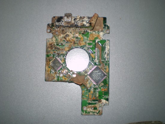

I need a exactly donor (Western Digital 2´5 HD) to change the platters. My PCB it´s burned but
not carbonized completely, but the ePROM doesn´t survive. I can read yet a part of the code.
PCB CODE: 2060-701615-003
I don´t know the p/n, firmware or the DCM codes. However, I suspect it may belong an HD of
the Scorpio Blue or Scorpio Black series like:
wD3200BJKT
WD2500BJKT
WD1600BJKT
WD3200BEKT
WD2500BEKT
WD1600BEKT
It has two pairs of heads and two platters and micro-USB connector located at the PCB. It hasn´t SATA neither
IDE connectors.
Please, answer the following questions as soon as posible:
Anybody has a similar HD with micro USB located at the PCB without IDE or SATA connections?
Anybody knows which would micro-USB connector be included at the PCB?
Anybody has seen a notebook with micro-USB connections exclusively to connect the HD´s to the mother board
directly?
Thanks!

Read the barcode on the drive chassis with a barcode scanner. This will give you the serial number. Input this to the WD warranty site and it will tell you which model it is. Thanks to a well known member for helping me with this recently :)
Based on the damage that you posted earlier, I agree with Dobre, I doubt this drive is recoverable.

it's looks should be WD PP hard drive.Image
would you like to post images of your PCB? may be i can help. i have some donors for it.

I think that's the PCB. I add the picture right now.

Only problem with this in this case is that since it is an external, I think the serial number will only get him the model of the external, rather than the model of the drive

this seems like the one im working on.
came from wd my passport WD3200ME-01 3110A. except yours is older
my info on it says 2061-701615 AD
DCM: HACT2AB
WD3200BMVU-1104S0 ( yours is older prob different)
