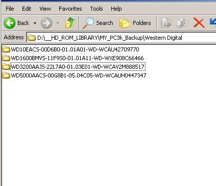

Drive needed just for the firmware, so it needs to be firmware version 000500E0. Please let me know if you can help.

have a look here and tel me which one works for u?

I definitely need it. Can't find this firmware anywhere, apparently not too common. I have corrupted modules on 41, 42, 43, 49, and 03. All of which are unique to the drive, but the deepspar folks said this family is usually ok to swap these modules, as long as the firmware is identical. Please let me know when and if you can upload.
Steve

Einstein,
I'm relatively new to this, so forgive my ignorance. I can't tell from your list which firmware is which. On Western Digitals I tend to just open module 11 and read the version number there. You do have a matching model number, including the last 6 characters, which I *think* means the firmware would also be the same, but regrettably I don't know for sure. If you do have that exact firmware, I'd love to get my hands on it.

Posts: 2854
BytesBack
well this is what i have for now, but if you wait for 2 days more i will update my library here coz have alot here, need to sort them coz took it from friend of mine

Posts: 2854
BytesBack
from the image i posted, tell me which one u wanted so i can attach here

Location: Northeast Ohio, USA
Einstein,
The one you had highlighted would be the one I need. WD3200AAJS-22L7A0. Providing it is that firmware revision of course. If you send it I can always check it out.
Thanks!
