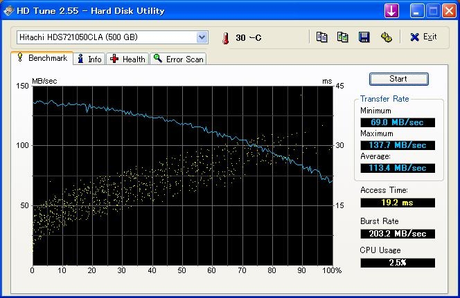

(b) HDS721050CLA362
Similary, the data rates for the HDS721050CLA362 are 138 MB/s and 130 MB/s, suggesting that the drive has a single platter.
http://bbsimg01.kakaku.k-img.com/images ... 6652_m.jpg
http://bbsimg01.kakaku.k-img.com/images ... 6986_m.jpg
