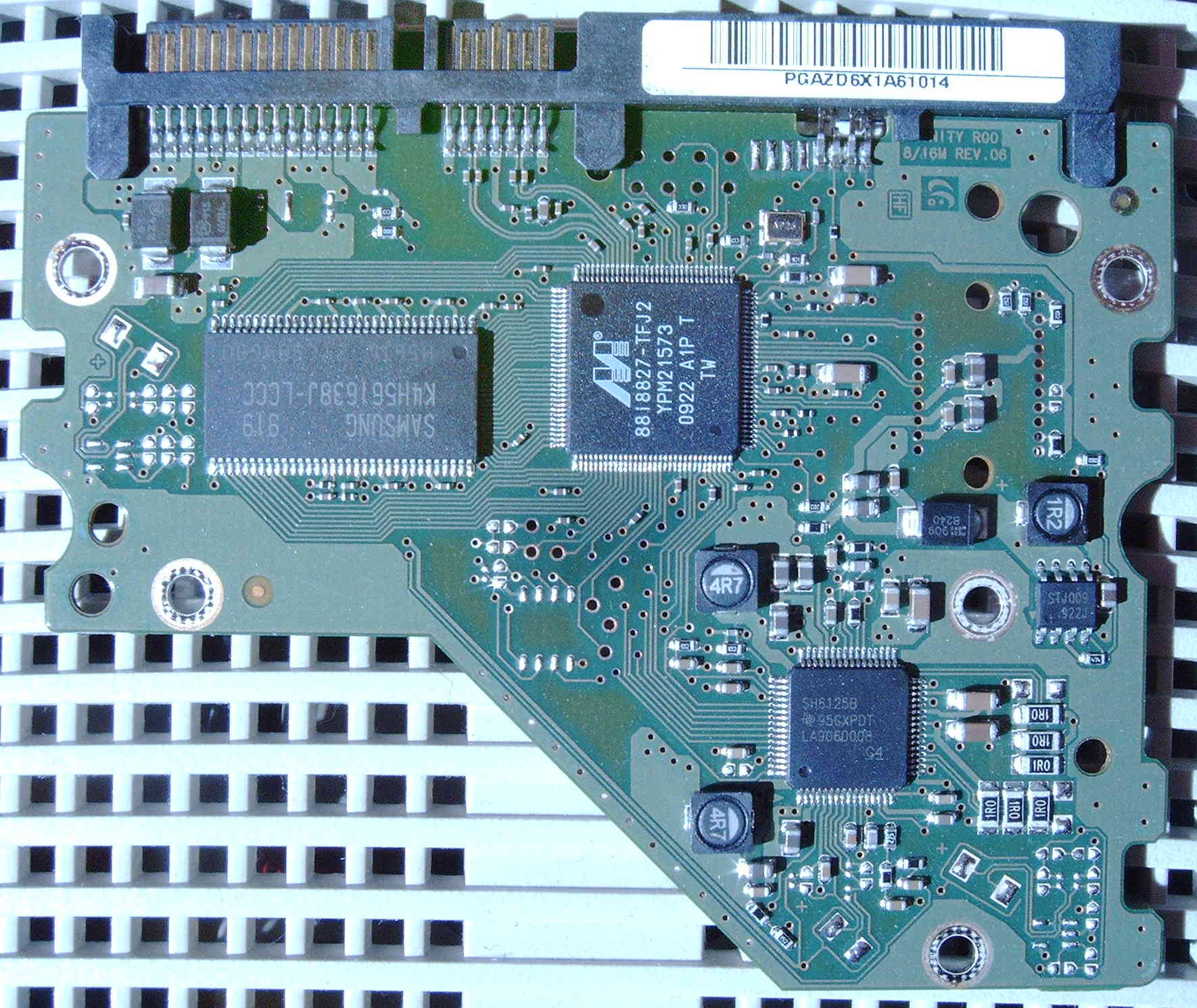

Im lookin for a replacement PCB for a Samsung Spinpoint F2 EcoGreen (HD154UI)
perhaps somebody can tell me where to get a replacement
any offers or helps appreciated
Every piece of information I could find on the HDD&PCB is down bellow
THANKS in advance, G
=INFO=================================================
Samsung Spinpoint F2 EcoGreen: HD154UI/Y 1,5TB/R54/32MB; REV.A
Main IC: 88i8827-TFJ2; YPM21573; 0922 A1PT; TW
RAM: SAMSUNG 919; K4H561638J-LCCC; H5616 8VC504GBU
other IC: SH6125B; 95CXPD7; LA960008; C4; TexasInstruments
HDD-Labels: P/N: 61831B761A0FHS
S/N: S1Y6J1KS711484; 1.???: (HD154UI); 2.???: SEC-HD154UI(B); 3.???; 4.??? 2009.07; 5.???
90522PD
HDD-printons: T4; 04; 1
BNT4; 0414
PCB-Label: PGAZD6X1A61014
PCB prin-ons: Trinity R00; 8/16M Rev.06
BF41-00284A 01
TS-M-8V02C SG; 94V-0; TOPSEARCH; 17934; 0905 D; SO-1 9

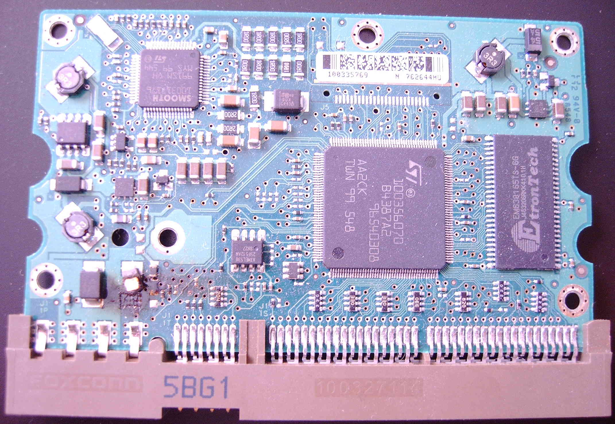

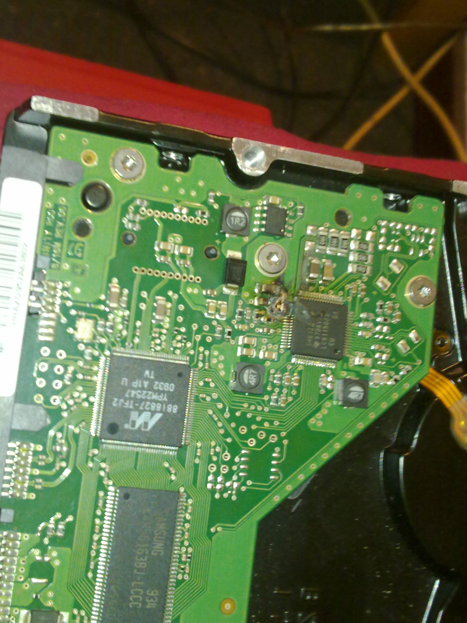

I was wondering if it might be possible to just sodder on a new dioe perhaps or what ever...
Ok, just to give you an "brief" history of my stupidity - it all started with undusting my old pc and doing so I must have given my old Seagate IDE HDDs PCB a static-shock - so when i turned the pc back on, some nice smell filled the air... :smoker:
Ok, so I thought it was just the Seagate HDD, and since i had a IDE-2-SATAconverter-controller and an external HDD with a SATA-Hitachie Drive inside, I quickly put that one in but even thought there was no smell or anything - didnt even spinn up - so i put i back in the external controller and even thought it was working before...:shock: nothing...
So allthough I had tried to be extra cautious, I still beleaved it was my fault shocking the other Drive as well -
So off to the store to get a brand new SamsungHDD - put it all back together - I didnt touch a thing and i earthed myself before ( as i always do... :?: ) - the same thing again.... :bebebe:
So I threw away the whole pc ( was a old 1.2GHz anyway) after I had discovered ----- it had also fried my CD and my DVD-Burner....... :twisted:
So I bought a new PCB for my SeagateHDD and it worked - so the internals were fine
So, now on the its old PCB - must be some kind of a Rectifier - so I guess its a Diode which is completly fried ( and i ripped it out in my anger... :buhaha: )
Now the thing is i dont know if it was the controller or the powersupply since i conneted the psu over an adapter as well...
Anyway, perhaps you go any suggestions - the pix are as good as i could get them with my old camera - if i go anycloser it cannt focus (and it focuses better with no zoom to start with - i really ought to get new hardware in gerneral....) - but anyway as far as i can see there's no damage to be seen.
Perhaps you know i which order i should try to replace the smd-parts
THANKS for any help in advance :please:

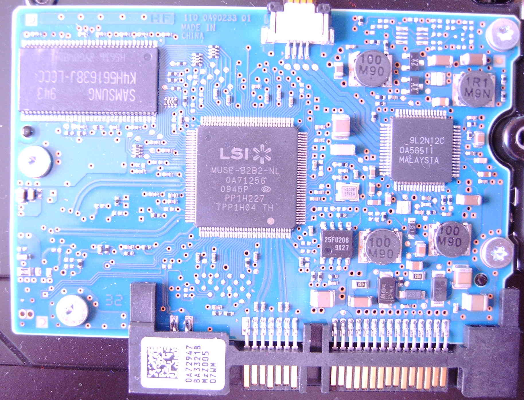

====INFO on the Hitachi HDD ===================================
HITACHI DESKSTAR 7K1000.C 1TB ( DS7SAC100 HDS721010CLA332 )
1TB 3.5" SATA2 7200RPM 32MB
--MainLabel------------------------------------------------------------------
0F10762JPT39C0C02
P/N: 0F10762
CAPACITY:1TB MLC:JPT39C FW:39C
LBA:1.953.525.168 SECTORS CHS:16383/16/63
MADE IN CHINA BY Hitachi Global E182115 CN
Storage Products(Shenzhen)Co.,Ltd. CN
RATED:5V 450mA,12V 700mA SATA 3.0 Gb/s
HDS721010CLA332 RPM:7200RPM
Type DS7SAC100 C P/N:H3D10003272S
MainIC: LSI; MUSE-B2B2-NL; 0A71256;0945P (e3); PP1H227; TPP1H04 TH
RAM: SAMSUNG 943; K4H561638J-LCCC
otherIC: 9L2N12C; 0A56511; MALAYSIA
==============================================================0

All drives will probably be OK with a simple, no-cost DIY repair.
Get hold of a digital multimeter (US$10) and measure the resistances of the 5V and 12V TVS diodes on the 200 ohms range. The diodes are the two largest components nearest the SATA power connector. The failed Seagate diode is obvious.
If any diode tests close to zero ohms, then it can be removed with flush cutters. The drive will work OK without it, but it will no longer have overvoltage protection on the affected supply rail. Be absolutely sure your PSU is OK.
For continued protection you can replace the 12V diode with an SMBJ12A, and the 5V diode with an SMAJ5.0A. Both are available from Farnell, Mouser, Digikey.
The following URLs should help you identify the components:
http://hddscan.com/doc/HDD_from_inside.html
http://www.users.on.net/~fzabkar/HDD/HDD_ICs.txt
http://www.users.on.net/~fzabkar/HDD/TVS_diodes.txt

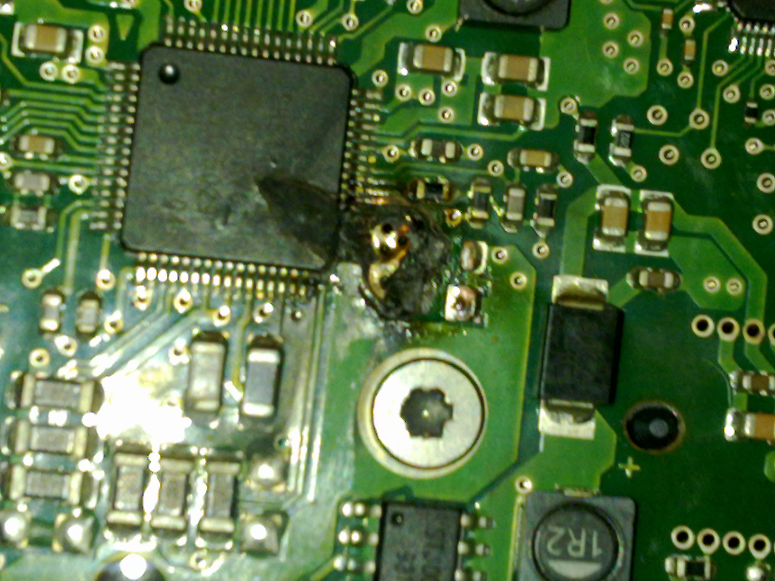

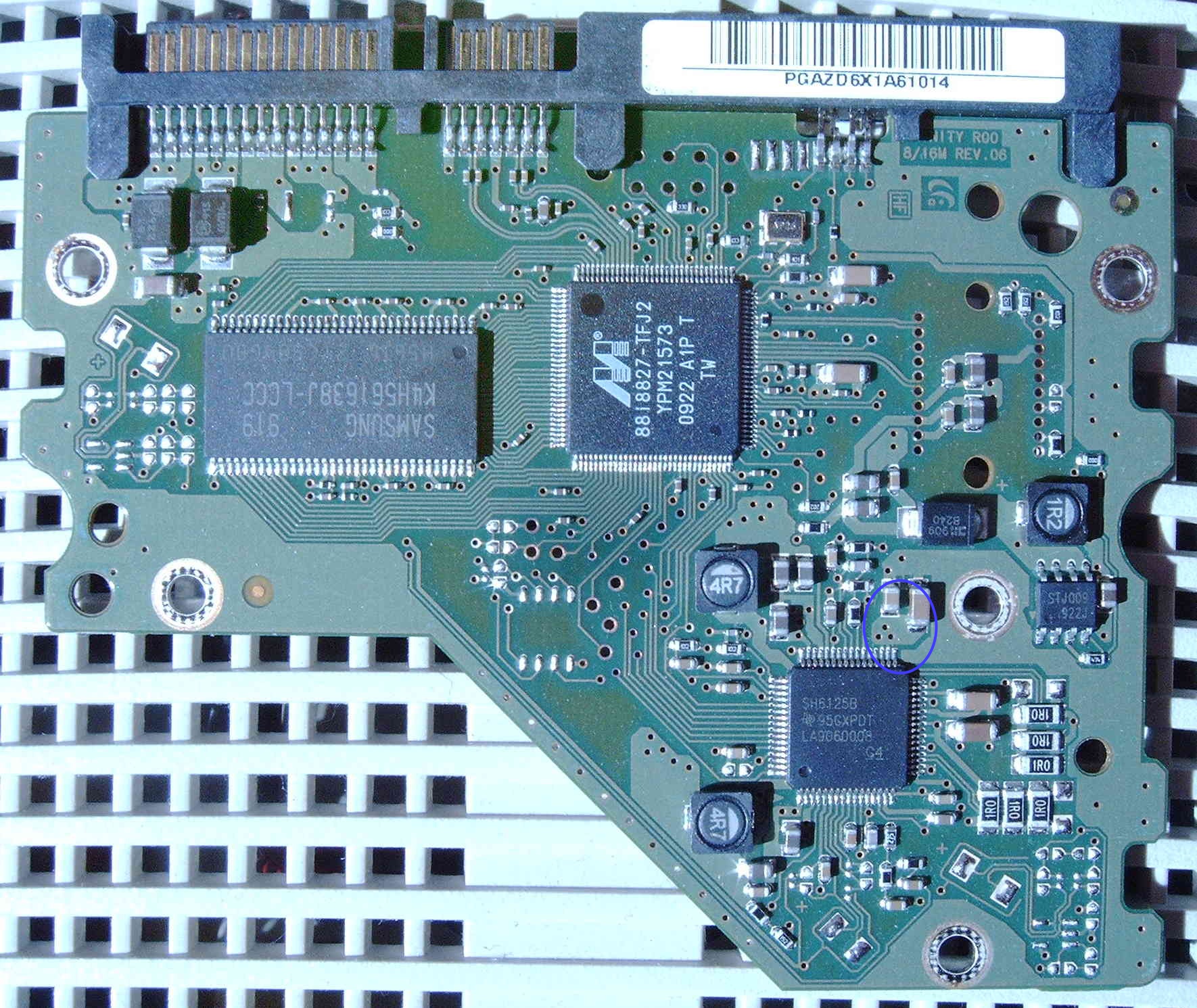

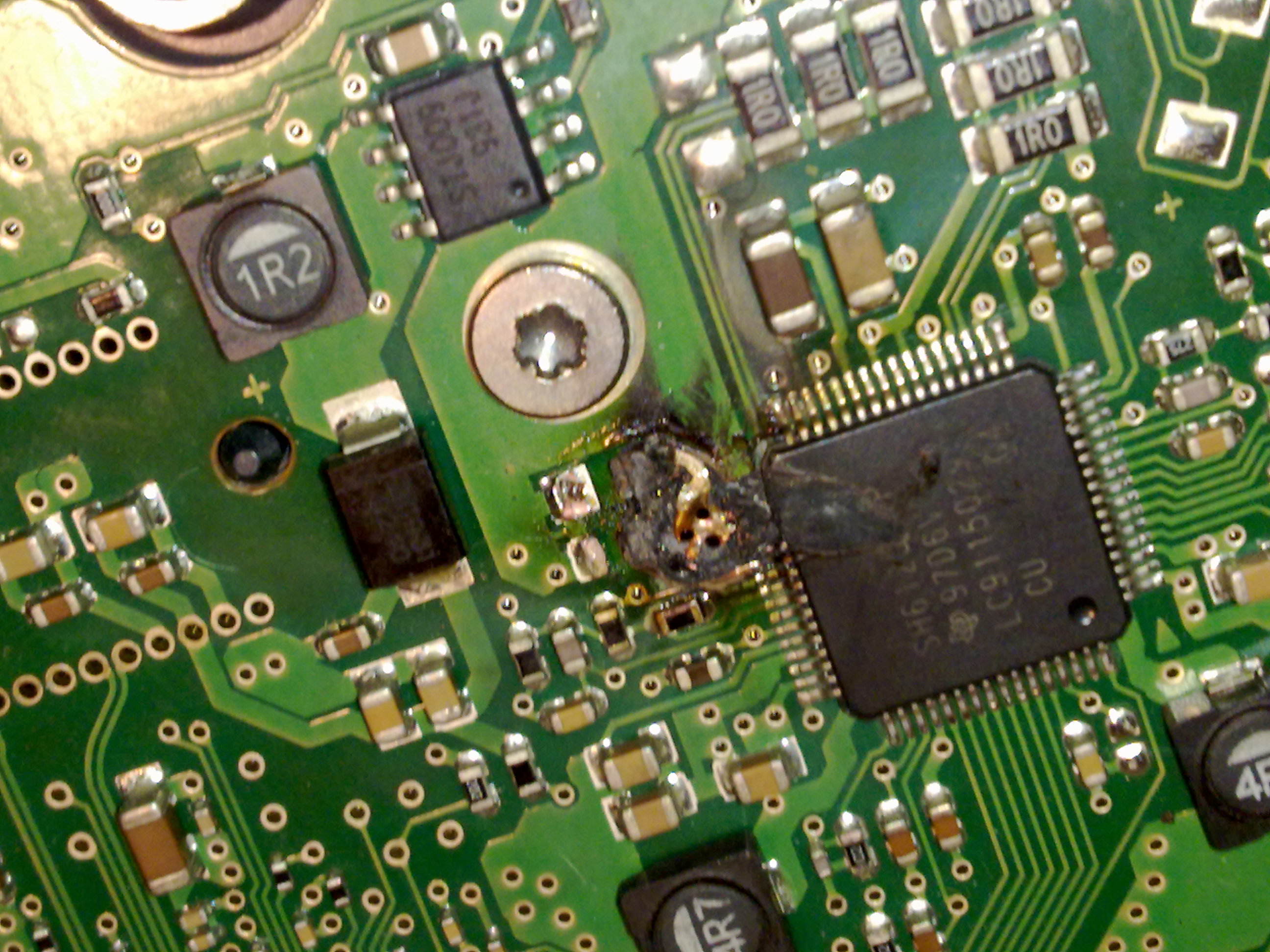

Hello there.
I myself have a similar problem. A short-circuit fried a part on the PCB which might be the 'safety fuses/diodes?' mentioned above. My camera is horrendous so I took the other chap's picture and circled in the burnt area and tried to take some pictures of the burnt area. The disk has the same specs, the PCB is also trinity R00 8/16M REV .06 but has a different PCB erm ID code? the label is:
PHAZD952A63802
The various IC's have also different values. But ok... to start this. It shorted and I am getting a replacement, thank god.. however I do not know if the new PCB will save the data on this one, which is 20 years of my life.. ye ye, somehow miraculously down the lane my data managed to keep with me from my dad's 4 MB drive to my 143 MB? drive and onwards, always moved it before they died.. but this one was just unexpected. In fact this one was a new 1.5 TB external which I used to pull of my data from my failed laptop disk this summer with testdisk etc.
Anyway, Just as I saved everything, the damn thing caught fire.. shorted... sigh.
Ok, so dug my head in the sand as normally I always have a solution over the years. This time.. looking bad I thought. Either way, the company were kind enough to send me a replacement but the PCB still is a big "probably not compatible" risk. I was teaching a bit at the local university in some other fields but we have a micro-electronics division (which I applied once for at Warwick or Durham too when in the old country haha). Thank god for customers I ended up doing something else.
Either way, so in one of the pictures you will see my burnt part.. the burnt 'fuse' (I will just refer to fuse/part and pardon my ignorance), and the one next to it are off. I almost get some hope when I read some that one could remove them and give it a try (which I won't). The problem is the larger IC next to it, I do not know what this IC does but as I was getting my coffee , finding it in flames, this one got scorched on the corner and has lost I don't know 5-7 pins of it?
The question(s) are:
In this order perhaps:
A. Go to my ME guys and ask em, can they verify the 'fuse' thing and /or solder them pins again (with their lil clean rooms and boojaa tools :))?
B. Trying the disk with switching PCB boards?
C. Plead with Samsung to send a PCB board or another parts place (with more specific identification data)?
or D. cry my arse off as my memories of my best years (plus a ton of writing incl. the soft copy of 2 books and short stories will still be held away from me? :(
The disk was purchased in summer and wa, I beleive produced in 09.2009, a replacement one is likely form a newer batch.. with luck it's still rev. 06 but you guys will know way better than me the likelihood of success) (someone mentioned ~1% as an example).
kind regards,
Solar
File comment: My sorry case of a soul
File comment: the OP's picture but with my burnt area encircled

Oh.. to add... the burn scar apart from on the pins on the IC SH1625b is it? seems to be 'superficial' ; although obviously I do not know if heat could of damaged it inside.
 Post subject: Re: HD154UI: Samsung Spinpoint F2 EcoGreen: PCB needed
PostPosted: December 22nd, 2010, 17:39
Posts: 17328
solar, your drive's motor controller IC (SH6125B) has failed. Unfortunately a board swap probably won't work because each board stores unique, drive specific information in flash memory. These data need to be transferred from patient to donor. In your case the flash memory is internal to the Marvell MCU (big "M" logo). :-(

Oh let me add, the burning happened on two small diodes, now missing from the picture (cross-reference, the other one.. this was due to me short cicruiting the disk inside a desktop). The burn marks on the chip you mention are secondary, came from the sparks/fire. In case that matters.
solar
PostPosted: December 29th, 2010, 11:31
The PCB can be repaired OR data recovered EVEN WITHOUT NATIVE PCB AT ALL - i.e. totally destroyed. Of course not everyone can. Just in case...
PostPosted: December 29th, 2010, 15:58
Posts: 17328
solar
The two small components appear to be capacitors, probably bypassing one of the supply rails. If you clean the area with a toothbrush and isopropyl alcohol (tape head cleaner), then the damage will be more apparent.
