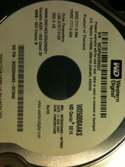

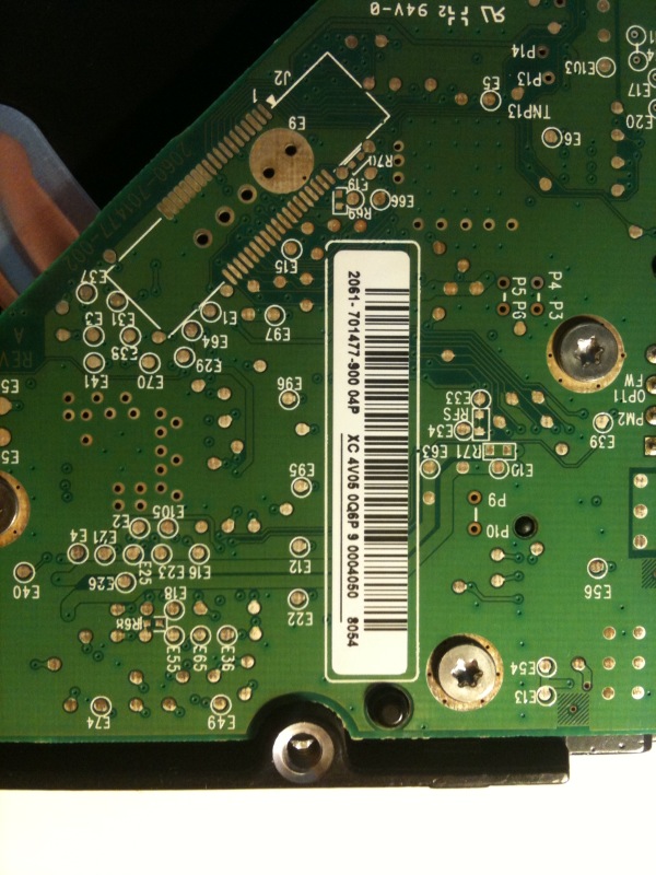

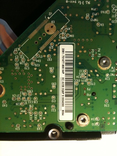

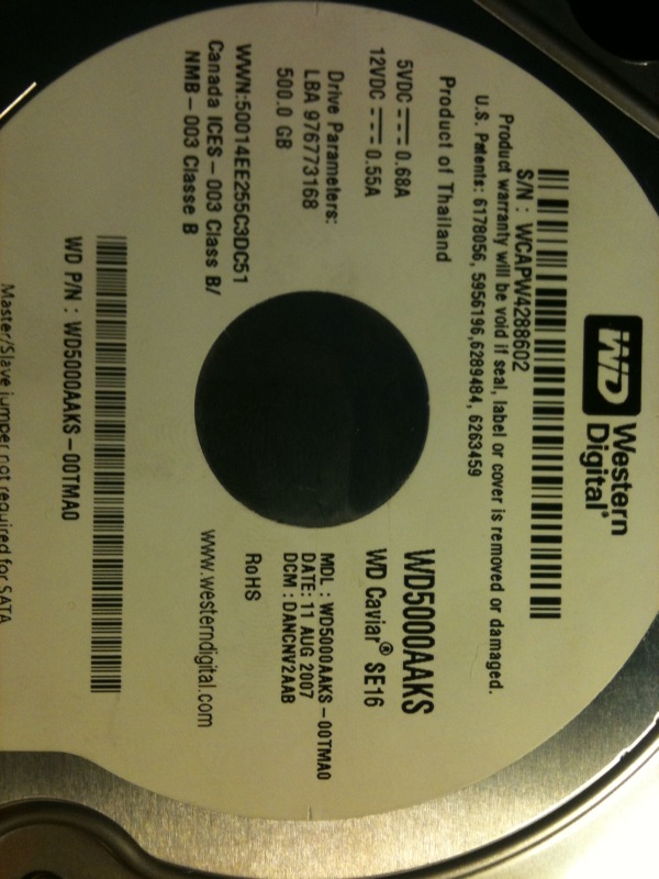

Hi AlterEgo,
the HDD inside my WD MyBook (the same as your model) it's broken.
After some test I came to the conclusion: the problen is the PCB of the hard disk.
Do you have available your old WD5000AASK hard disk?
Can you rent me?
I want only to recover my data, then I give back it to you.
All details are in attachement.
File comment: WD5000AASK HDD Back Details
File comment: WD5000AASK HDD Front Details
 Post subject: Re: Wanted : WD Mybook World Edition NAS : WD5000G032 : PCB Dead
PostPosted: April 29th, 2011, 3:58
Posts: 1151
i have this PCB in stock. it request to do firmware transfer. i can help you make it work again. please feel free to contact me by email or skype if need help. thanks.
data recovery service[/b]
PostPosted: April 29th, 2011, 8:37
Posts: 384
Location: China
Hi, We have this working PCB in stock for sale, however, for this kinds of PCB, rom have been integrated into the main chip, so I think it is little hard to manage by personal.
