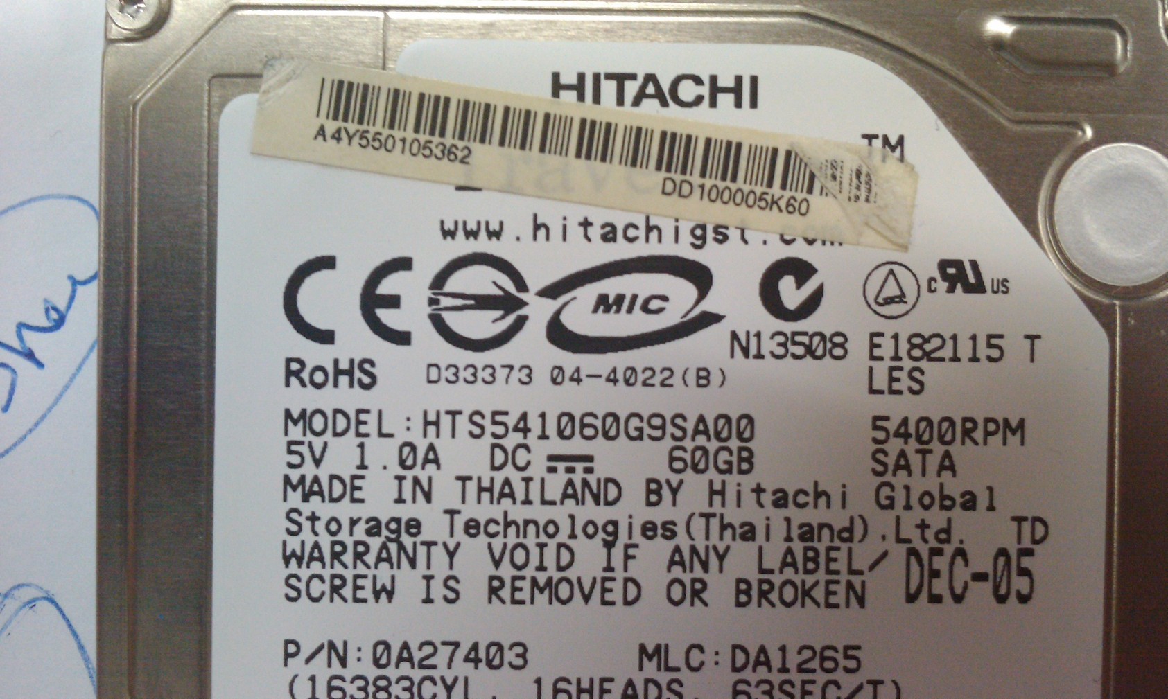

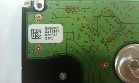

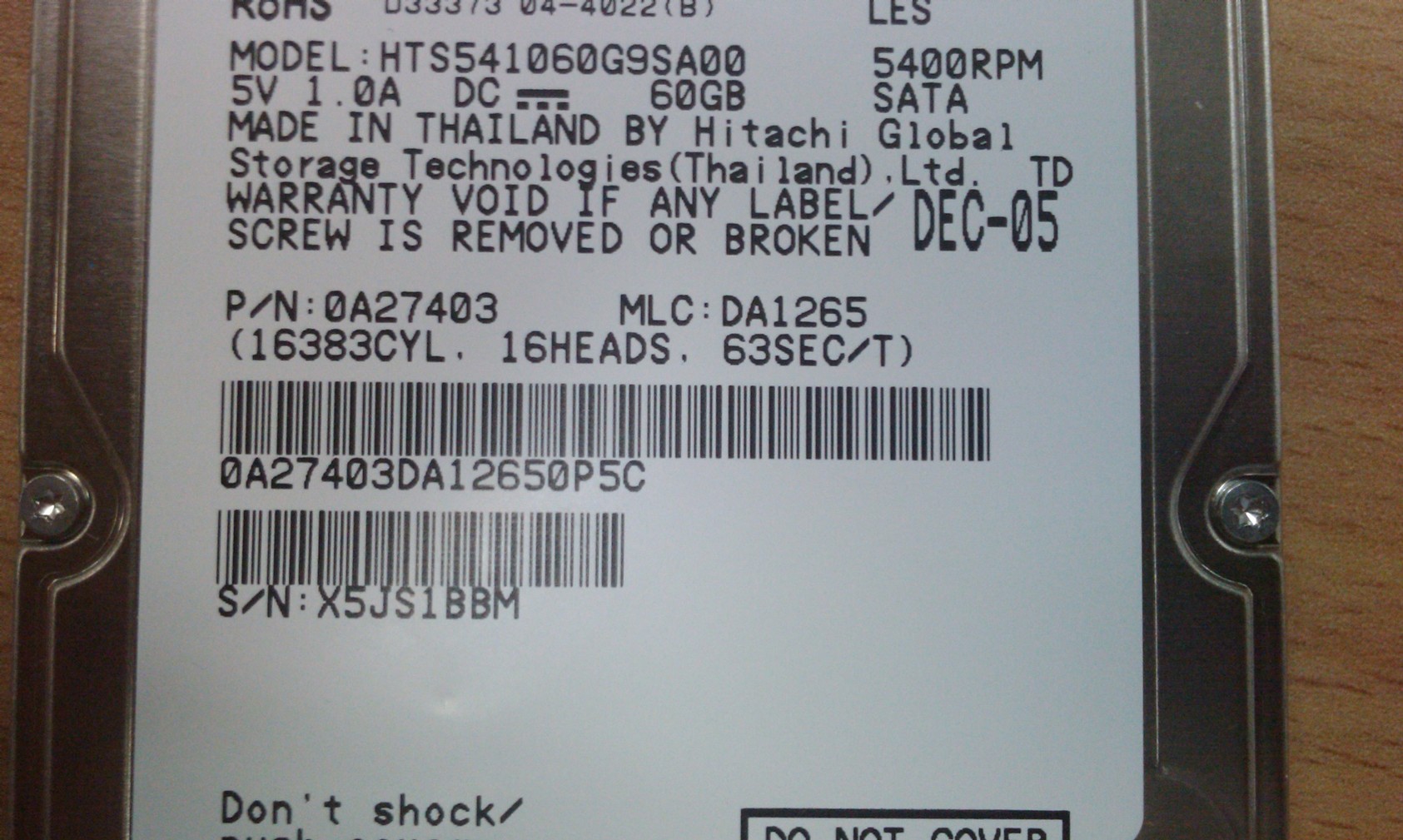

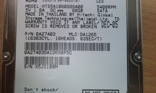

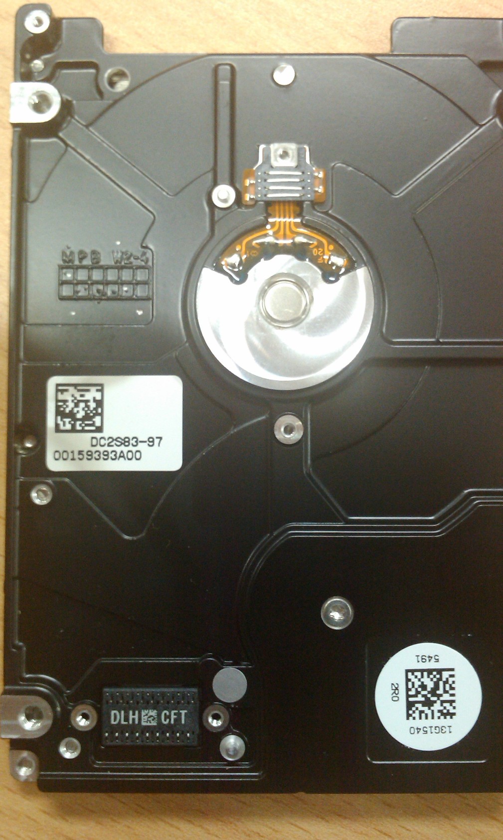

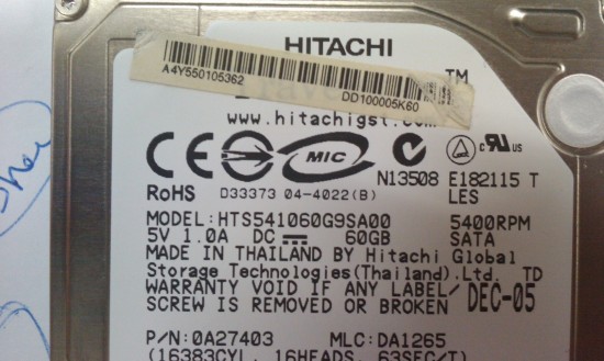

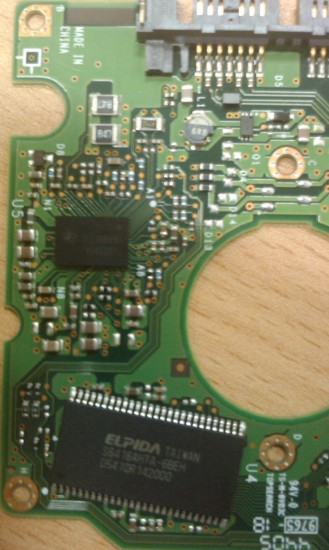

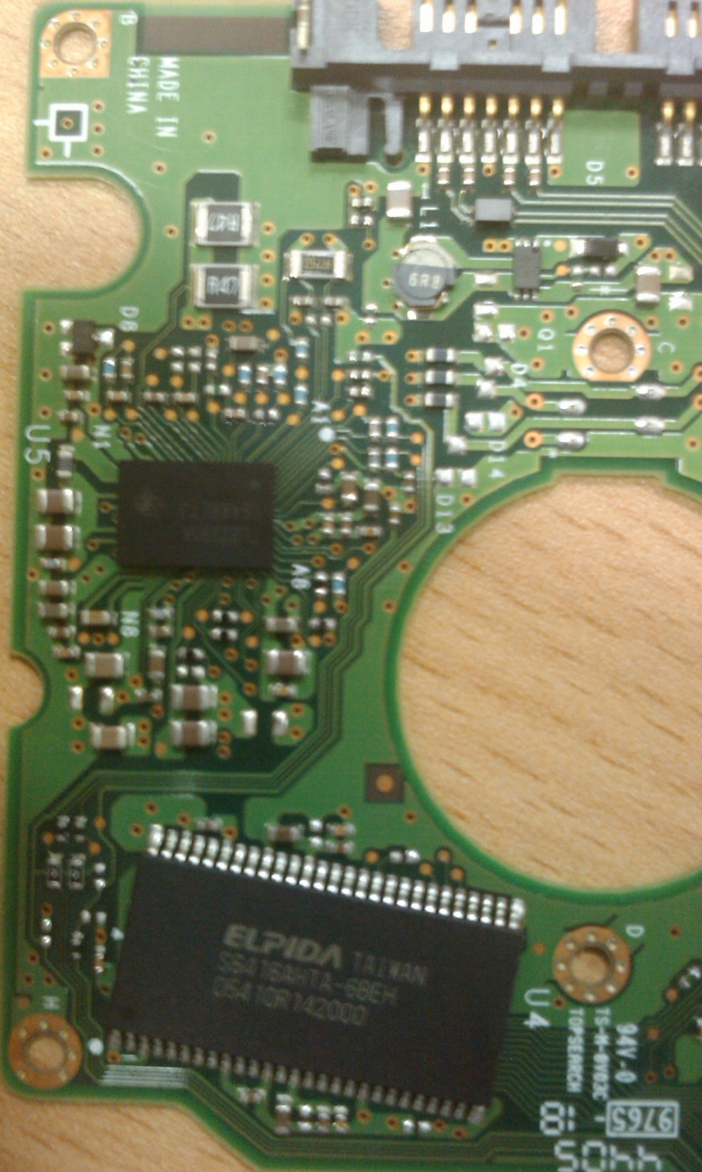

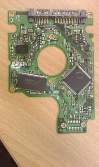

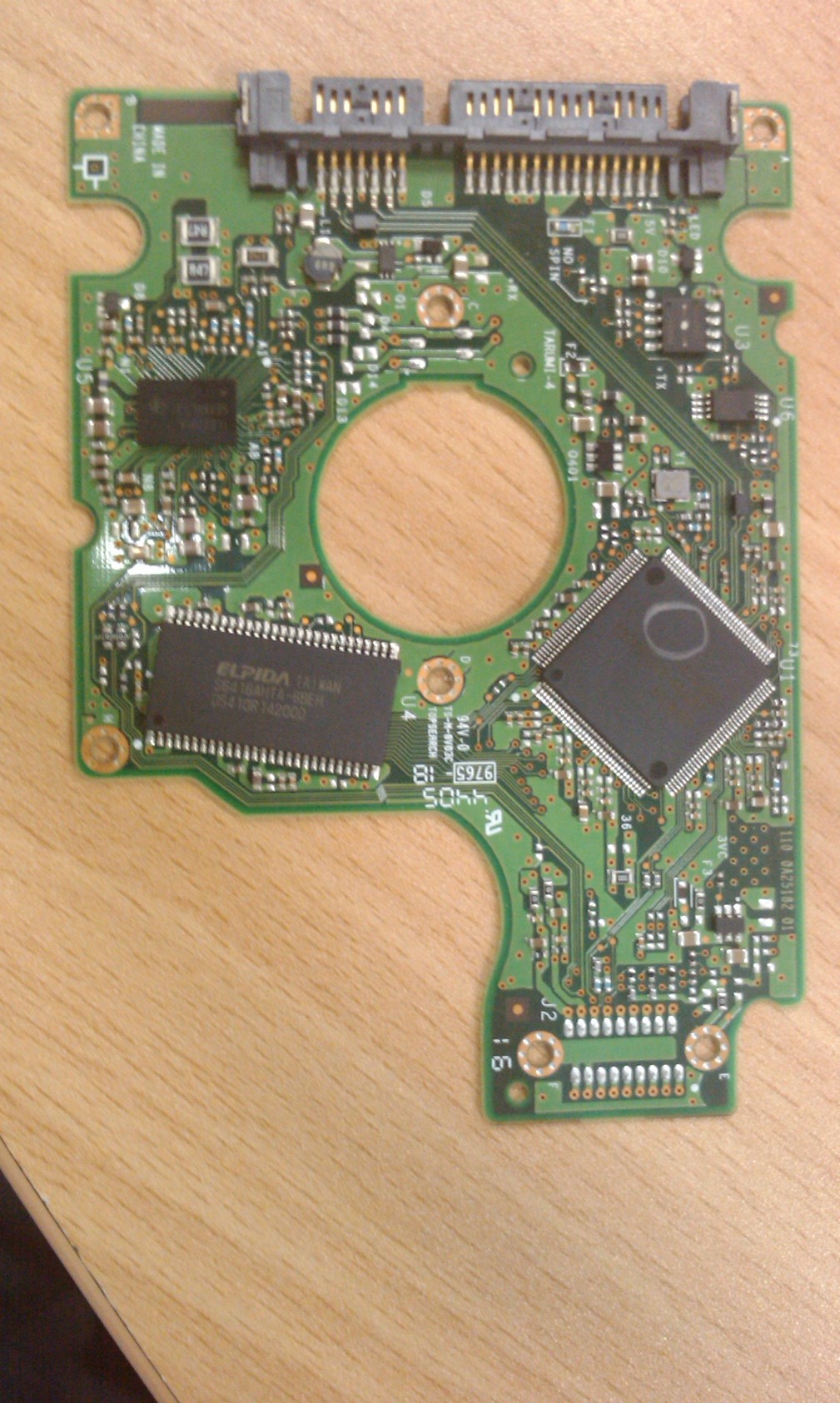

I send my HD to a data recovery after sudden power off. It was not able to be identified by windows on external enclosure, & the clicking sound will be heared for 10 seconds everytime i try to connect it.
The company's evaluation report mentioned that it's a PCB failure, & they requested 500 Singapore $, which i found too much :roll:
There is nothing crucial in this HD, just some family pictures i forgot to backup previously..... so i decided to dot it my self & try to replace the PCB.
PCB required:
Hitachi Travelstar
Model: HTS541060G9SA00 - SATA

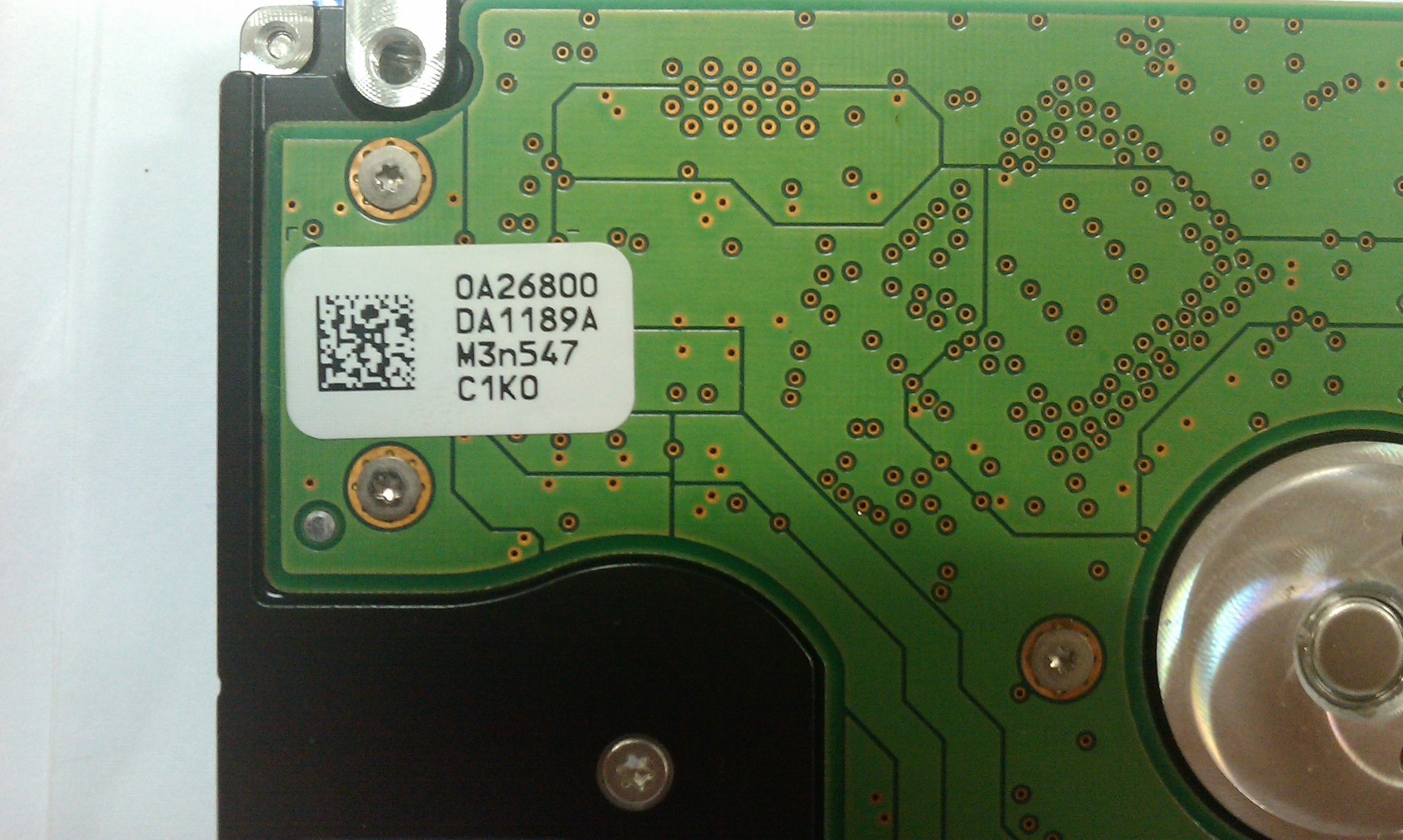

Boarad Label first two lines: 0A26800
DA1189A
Thanks In Advance

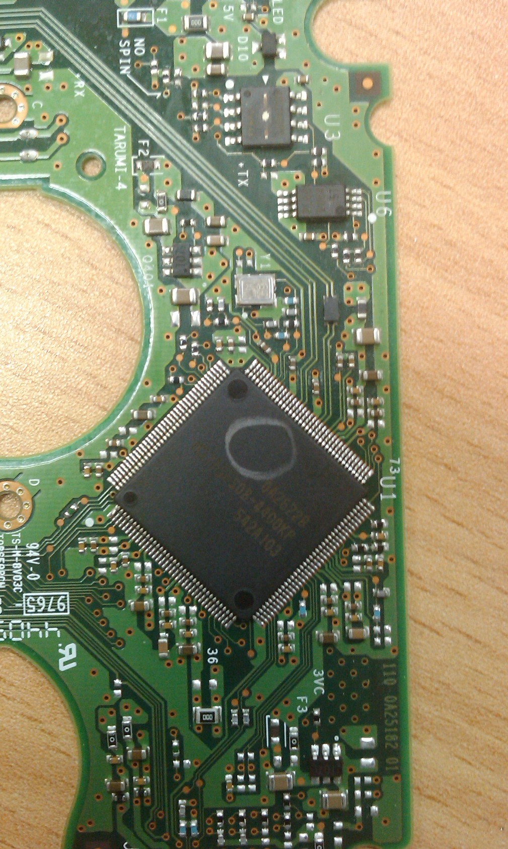

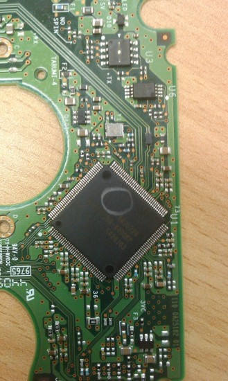

I'm not a DR guy, but if the drive spins up, then it doesn't sound like a PCB problem to me.
If you wish to replace the PCB, then you will need to transfer the 8-pin NVRAM chip, or its contents, from patient to donor. I can't see their markings, but U3 and U6 are the most likely suspects. Can you identify the part markings?
BTW, there appear to be 3 fuses on the PCB -- F1 (2A), F2, and F3.

thanks fzabkar for you prompt response.
I'm not an expert, but as per my basic knowledge that HD will not spin or click if its PCB issue.
U3: 25FV055T
5HN4K
U6:RL66
W684
5T
I hope this is the info you are looking for.

My understanding is that U6 is the NVRAM that needs to be transferred to your donor. Your supplier should be able to confirm this.
BR93L66RF-WE2, Rohm, Microwire BUS Serial EEPROM, 256×16bits, marking RL66, SOP8:
http://www.rohm.com/products/databook/g ... 76-w-e.pdf
http://www.rohm.com/products/databook/e ... r93l-e.pdf
U3 is a serial flash memory.
LE25FV055T, 512Kbit, 64Kx8, Sanyo, Serial flash memory, 8-pin:
http://www.semiconductor-sanyo.jp/ds_j/NA0447.pdf
