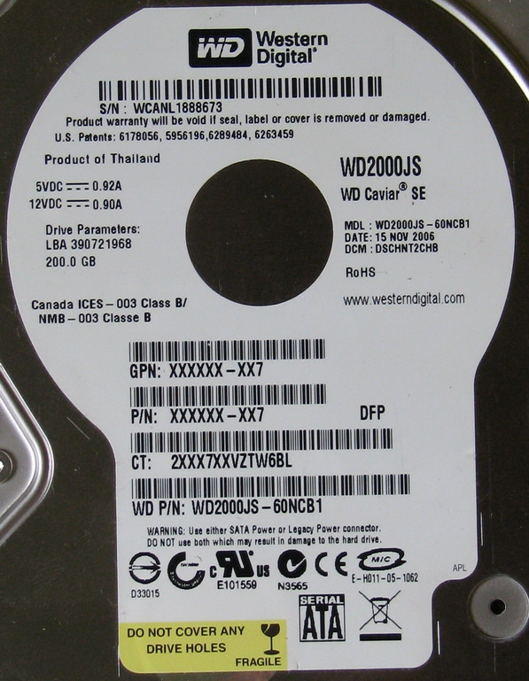

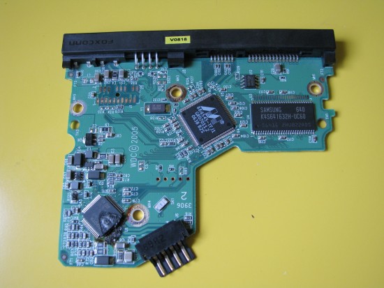

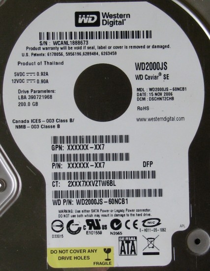

I'm looking for the WD2000JS-60NCB1 PCB.
These are the details of the HD:
File comment: HD
File comment: PCB
Thanks for any help

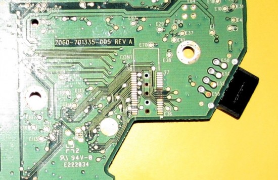

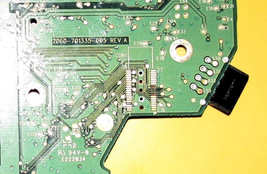

Just wanted to add the other side too.

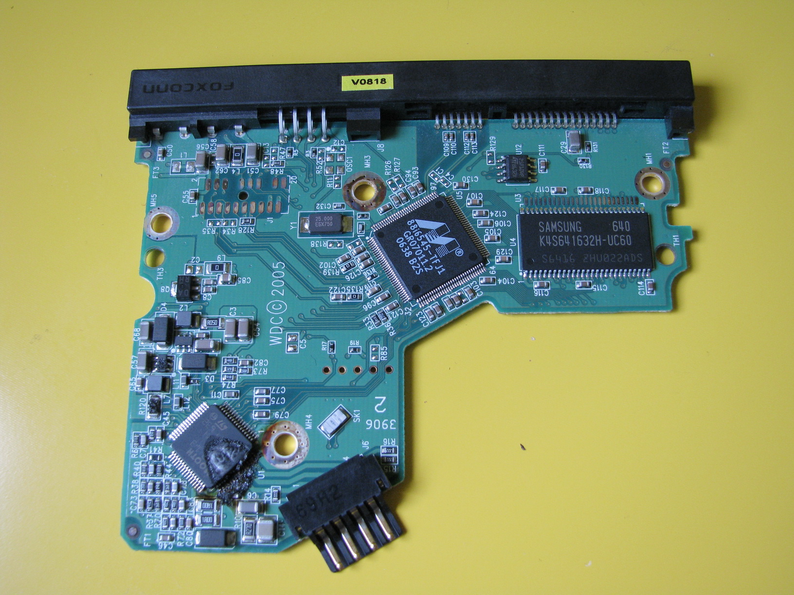

You need to move the 8-pin serial flash memory chip at location U12 from patient to donor.
The following board supplier includes a "firmware" transfer service:
http://www.hdd-parts.com/20091010.html
BTW, the damage to your SMOOTH motor controller IC suggests that it would be advisable to verify the resistances of the motor windings.
