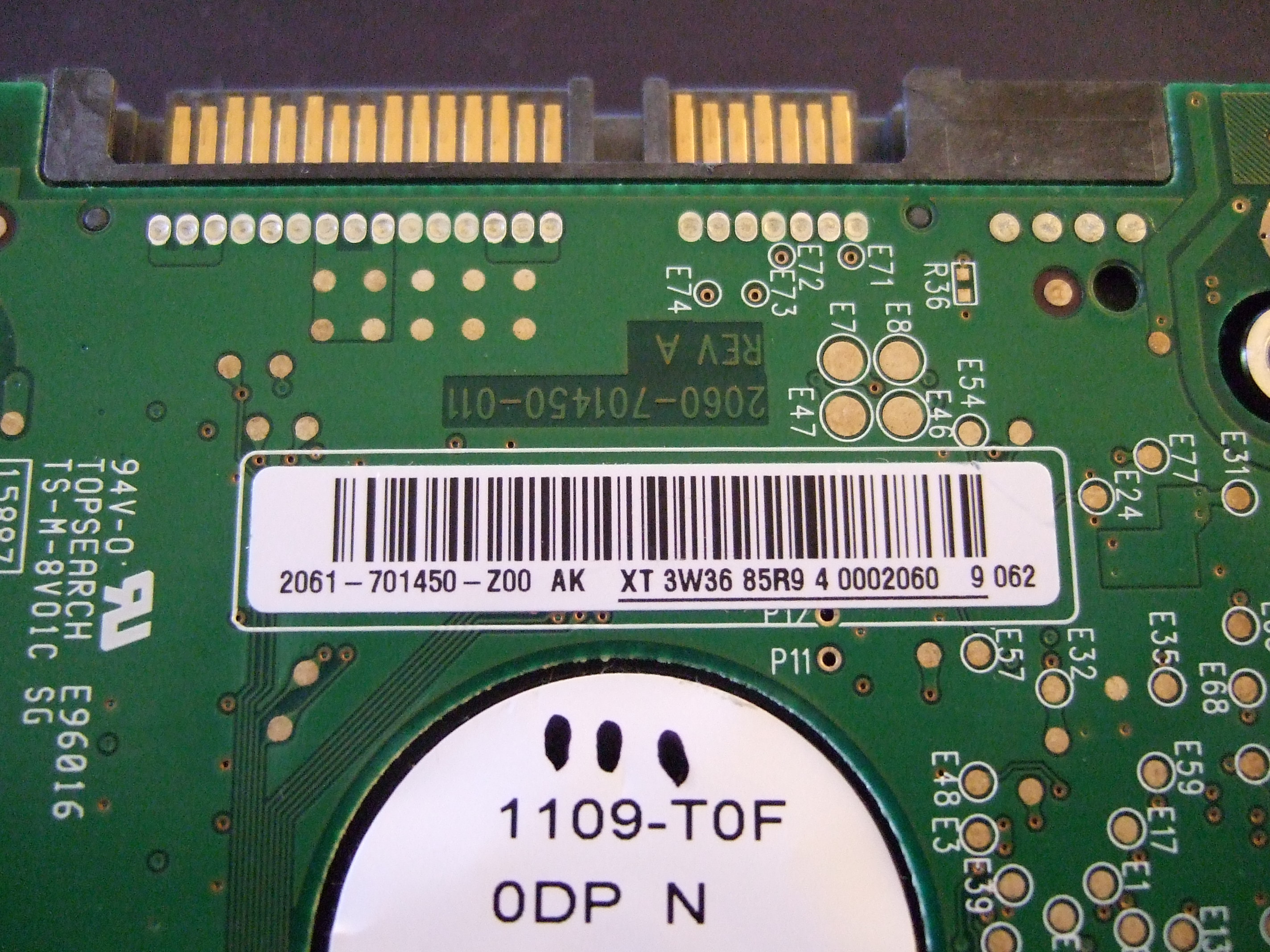

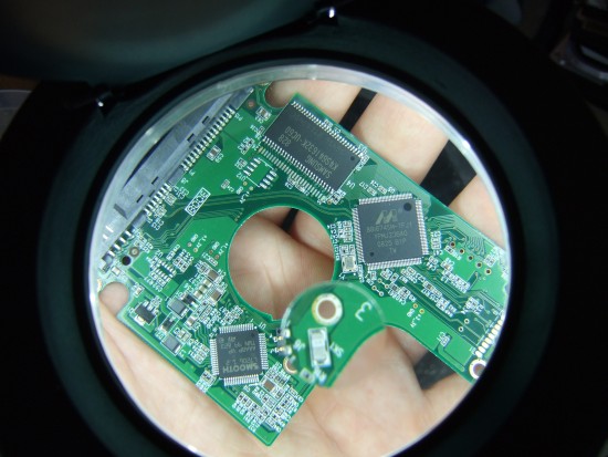

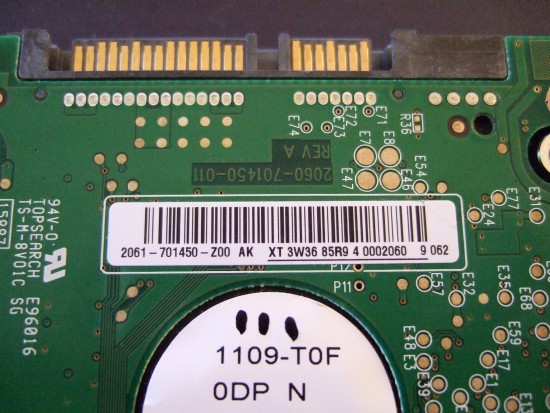

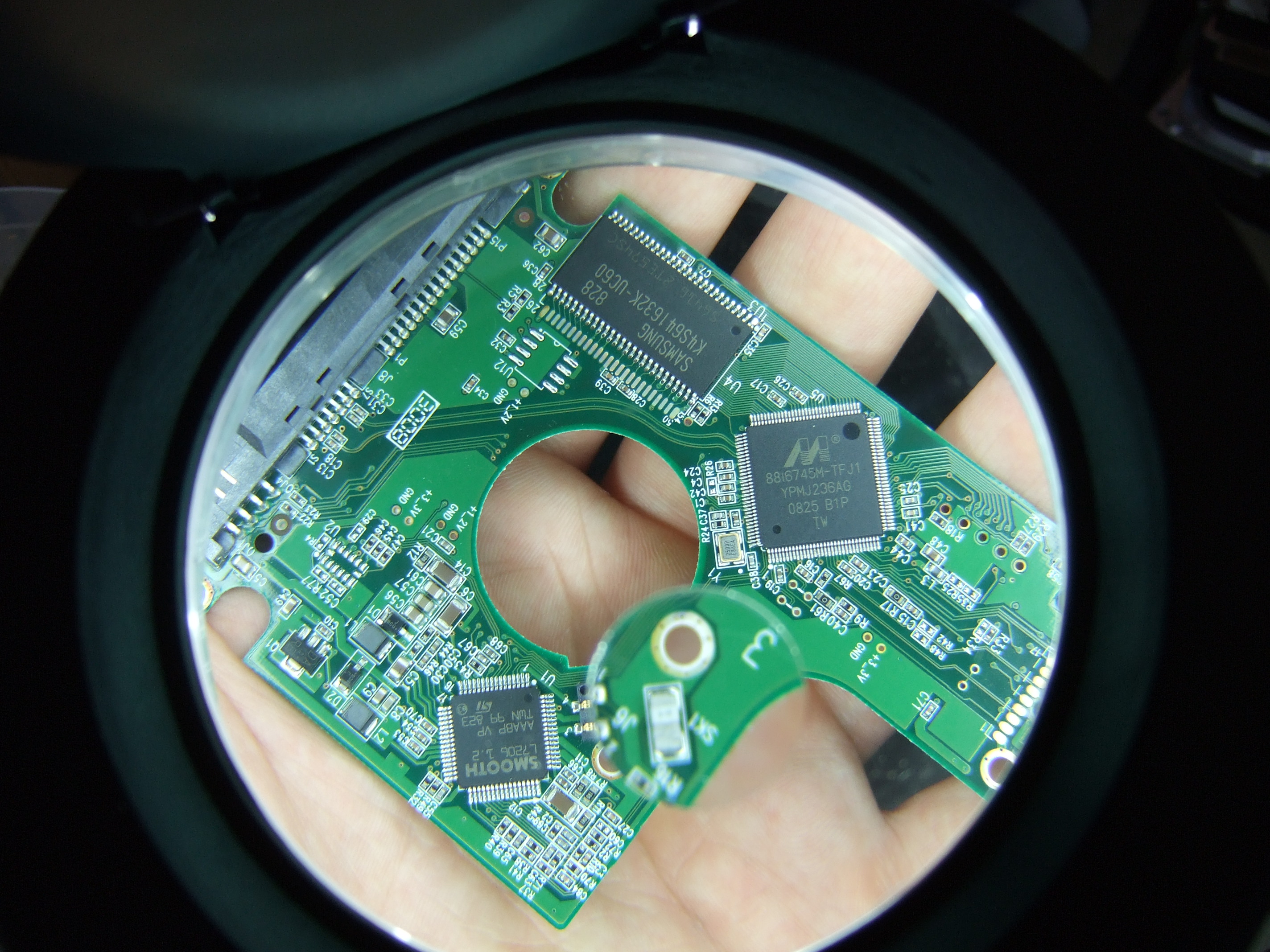

I have ordered a donor drive for my wd1600bevs, but there is no u12 chip on the PCB. The info is stored on the cpu of the board, and I do not have a pc3000 to transfer the rom to the new donor board.
Could someone in the US with a pc3000 do this for me? Please email me your price and turn-around-time.
Thanks,

What is the problem with the drive? There is more to reprogramming a donor than just owning PC3000.

The drive is not recognized in bios or DDI. It makes a few quiet clicks and powers off. I would like to swap the PCB with a donor PCB as my first step, but I cannot swap the rom because its stored on the processor on the board.

The PCB turned out to be ok. I replaced the head assembly with my donor drive and now the DDI is imaging it. Thanks for the input, I would have thought it was the PCB!
