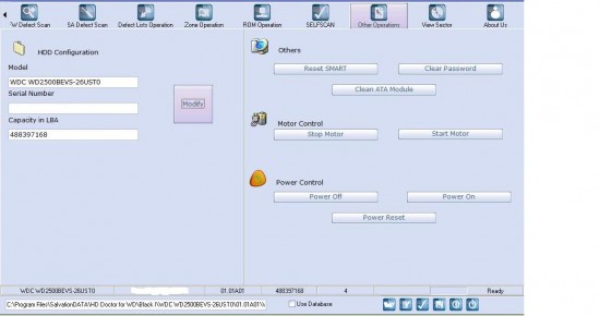

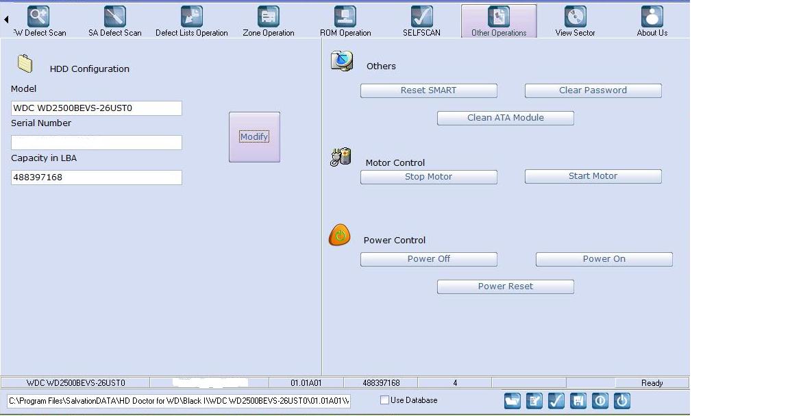

I had this one pass by for which I saved modules. Let me know if you think it may work. I know who has it. Details of SPT did not show up on SD software, maybe I can find in modules.
By the way, found this although you probably already checked, plus you need to verify SPT anyway, but maybe they can check.
http://www.donordrives.com/western-digi ... drive.html

 Post subject: Re: Looking for WD2500BEVS-??US??-01.01A01 with SA SPT 693
PostPosted: August 20th, 2011, 13:56
Posts: 2857
Thank you for checking.
Your tool is not so informative anyway. :roll:
Can you check the link table, ROM version, ROM generation values?
OR!
Save the service tracks!
The size should show the SPT.
Janos

Sorry N.C., software does not have those details. I dont have hard drive (could possibl get it for a while), and I have no tracks saved.

Details of SPT did not show up on SD software? :shock:
SquaL Choose Royl series before You "load from HDD" if You have that drive or "Load from file" resources choosing ROYL folder not a Black I folder :D
PostPosted: August 26th, 2011, 13:29
Joined: March 3rd, 2009, 15:27
Posts: 131
Location: Canada
Thanks Hary, sharp eye. This was done when I recently purchased the unit (and still learning). I notice the mistake a few days ago, when I checked firmware similar to what N.C. needs, posted on Slavation forum (sorted under ROYL), unfortunately the SPT does not match so I did not even bother mentioning it. I dont have drive (have resource file), but could get it. I will do as you mention with file.
