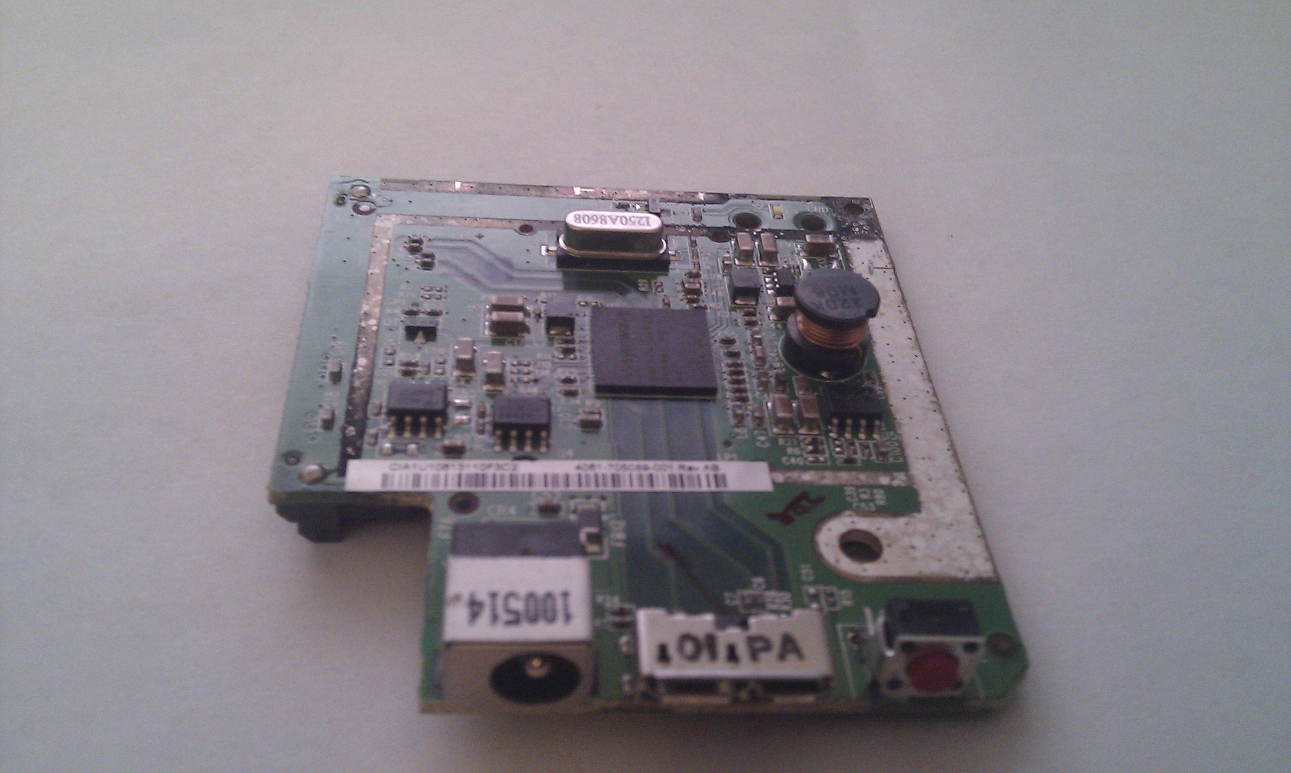

In need of a USB controller board for critical business data recovery.
Need exact match for
WD My book Essential 2tb 4061-705089-001 Rev. AB
PM me please, willing to pay top dollar

Post a good quality photo of the offending PCB please, and I'll see what I can find.

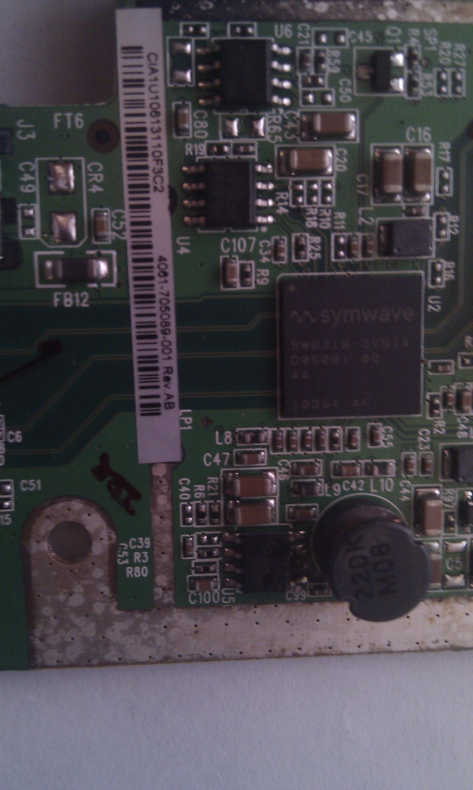

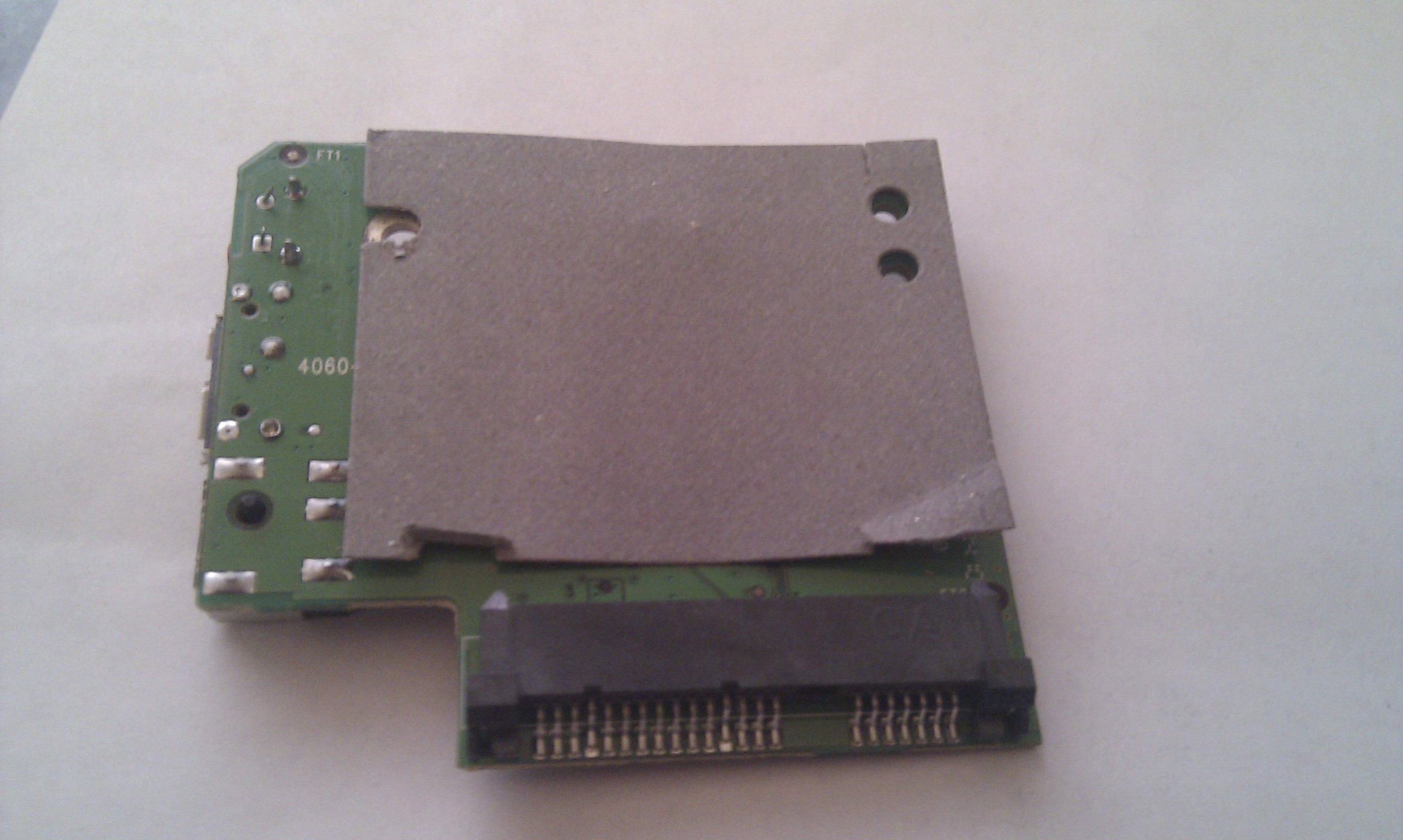

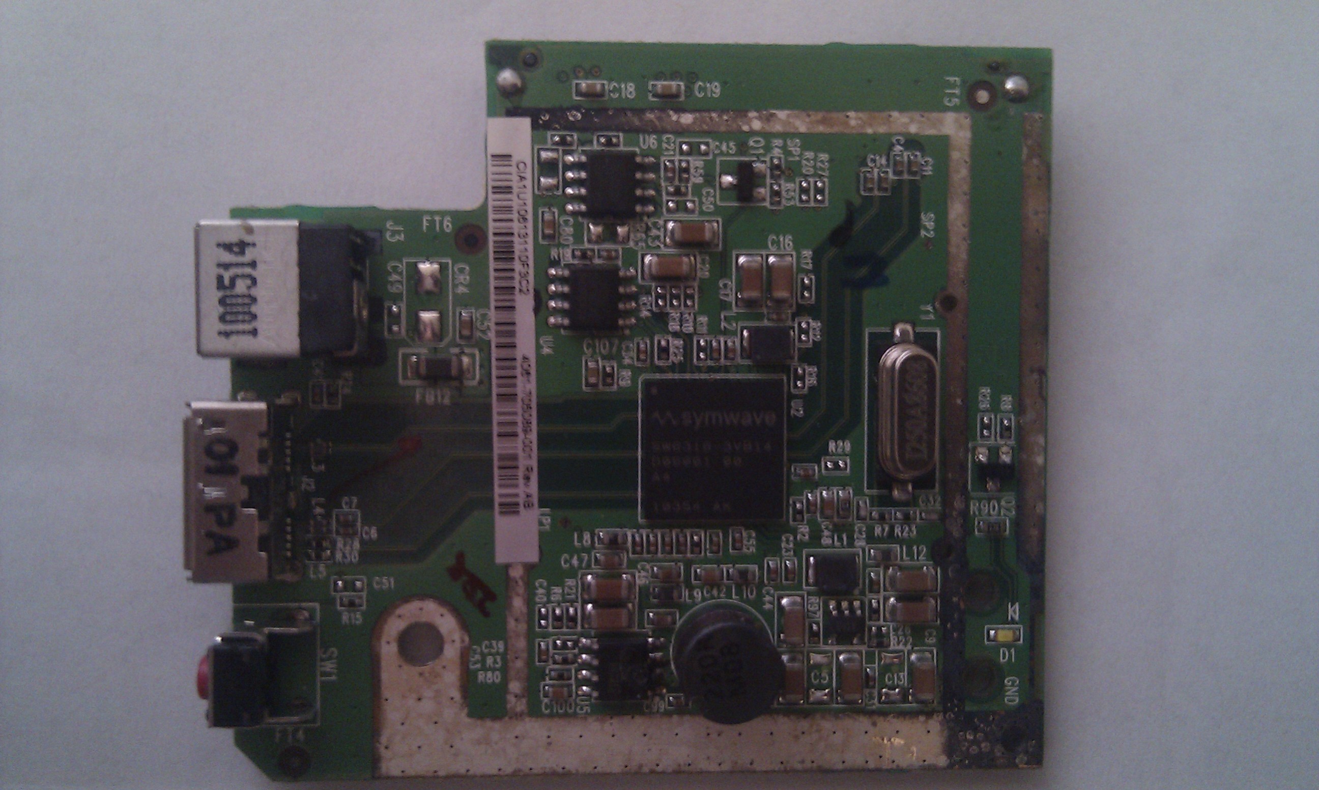

Thanks very much for looking :) My client will appreciate it. These WD enclosures are going to be the death of me....

I don't believe that you need an exact match. Any differences with a similar PCB should be accounted for if you transfer the bridge firmware to your replacement board. I can't see the markings, but the 8-pin chip at U4 appears to be the most likely candidate. If you could identify its markings, then I could confirm that for you.

Thank you fzabkar. How should I go about transferring the Firmware? will Ihave to physically switch out the chip? I am not as handy as I should be with an iron, so I would probably have to get a buddy to do it for me.

hogget wrote:
How should I go about transferring the Firmware? will I have to physically switch out the chip?
Yes, that's the most straightforward way.
Alternatively, there is PonyProg freeware, but you will need to construct a simple interface circuit:
http://www.lancos.com/prog.html
In both cases you will need to be adept at using a soldering iron.
