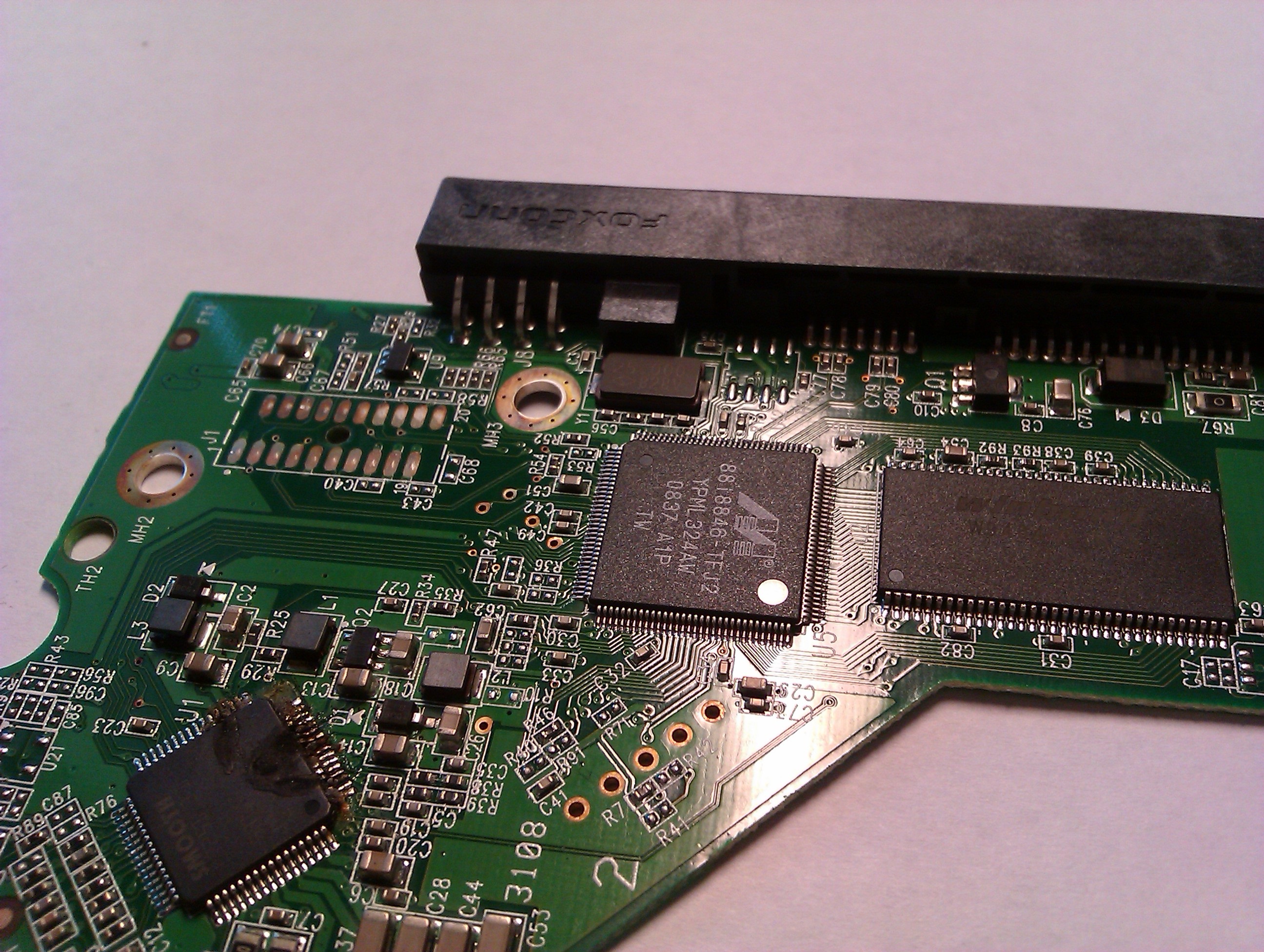

Here are photos of original pcb
http://www.vietcong1.cz/pcb/IMAG0172.jpg
http://www.vietcong1.cz/pcb/IMAG0173.jpg
http://www.vietcong1.cz/pcb/IMAG0174.jpg
http://www.vietcong1.cz/pcb/IMAG0175.jpg
Also i want edit the model of PCB firstly i wrote values from white label.
so i need 2060-701590-000 rev A

you do know that this pcb does not have external rom, right? You do know a straight board swap will not work, right?
It is not hard to find the pcb-it took me 30 seconds to find it for $39, but i don't know if you know what to do with it.

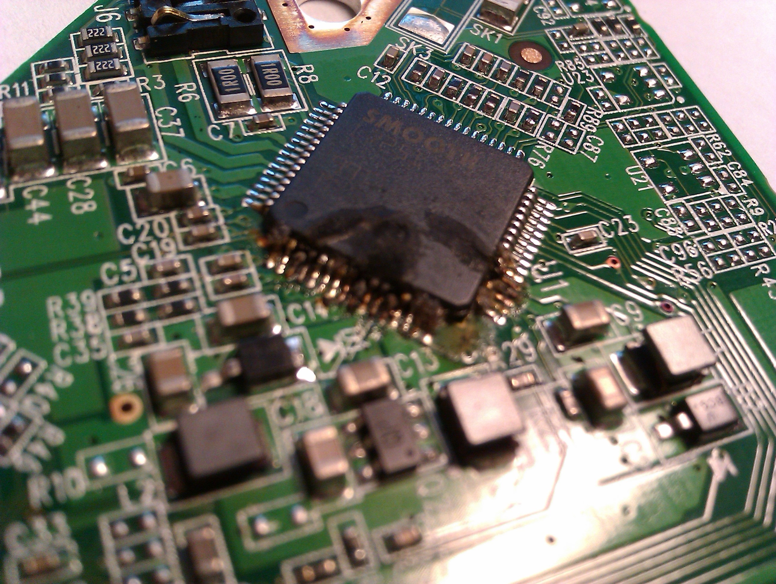

I was referring to OP, not porthas.
I presume OP should be aware that he/she should look for a solution that will actually work (ie. purchase drivedonor's service for rom transfer or someone elses) instead of throwing away their money on a pcb purchase.
Also, judging by the fried component in OP's pictures, i'd say the only way this can be done is by using professional services. I do not know if donor drives offer exactly this.
I would like to read your opinion about what cause fried this component.
Thank you for reactions could someone also give me a short brief how to transfer rom from one working pcb to another?

It is very hard to do this yourself, and in the end of the day you will find out that you have spent twice the cost of a new drive, just to achieve nothing.
Since you do not care about the data of this drive, i suggest you bin it (or send it for replacement if under warranty) and go on.
