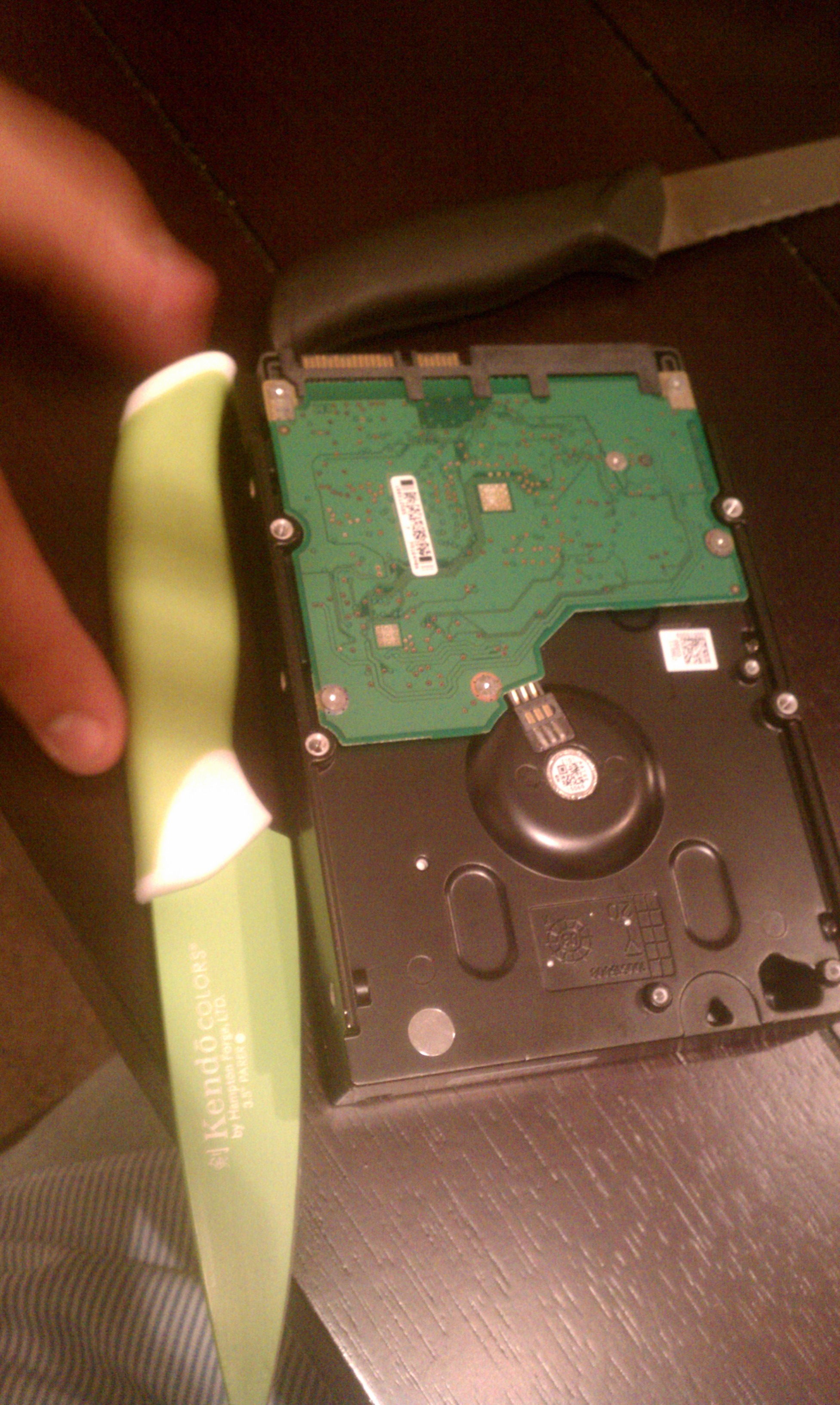

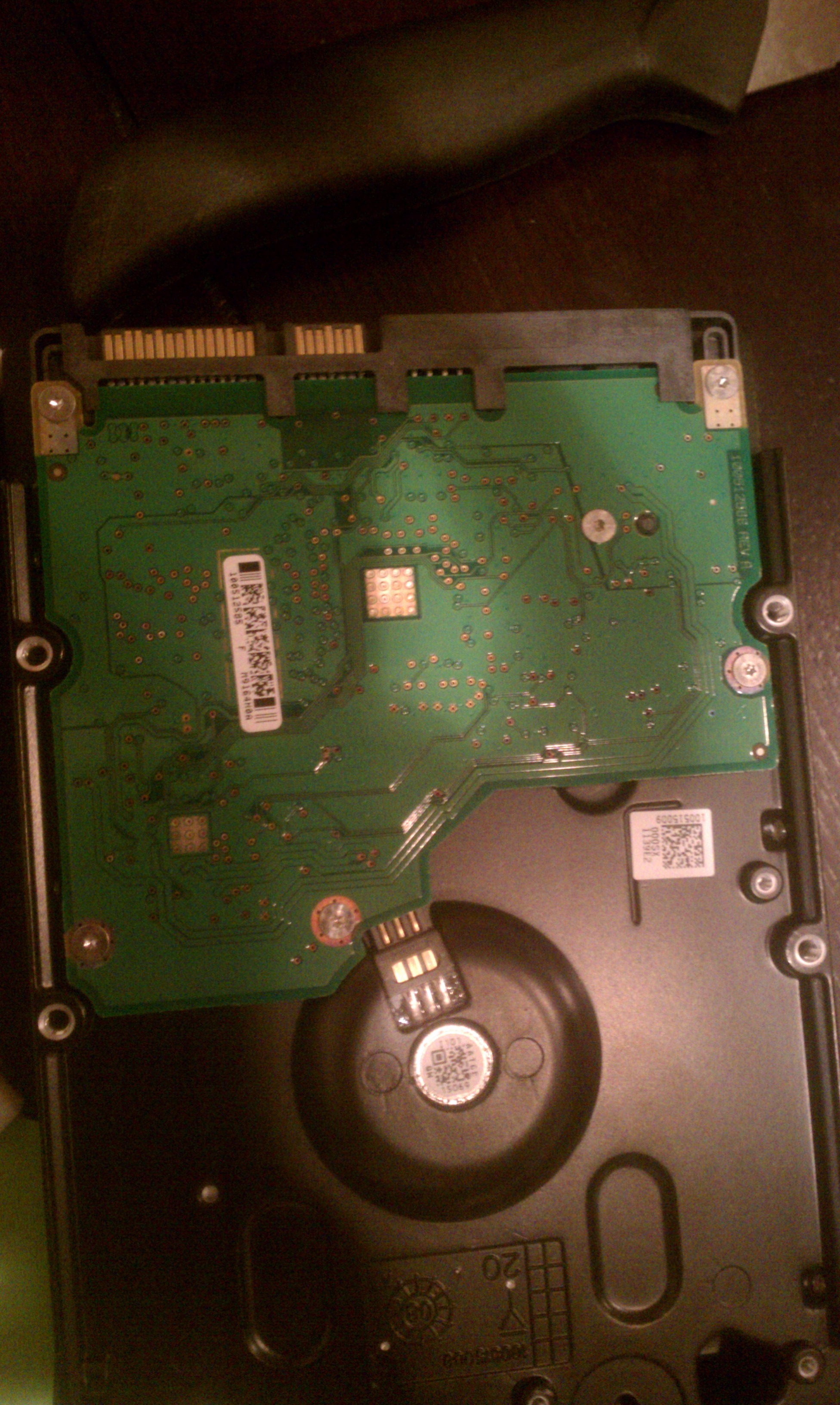

Need a board/pcb for a Seagate Hard Drive I have.
NEEDS TO BE ABLE TO MATCH THE ONE I HAVE!!!!
INFO ON MOTHERBOARD:
100512585 F M9164H0A
INFO ON HARD DRIVE:
S/N: 5TE0B7P9
ST 31000333AS
P/N: 9FZ136-568
FIRMWARE: SD35
DATE CODE: 09214
SITE CODE: SU
IF YOU HAVE A BOARD/PCB THAT IS IN WORKING CONDITION PLEASE CONTACT ME. I DO NOT NEED THE WHOLE HARD DRIVE JUST THE BOARD. THANK YOU!

Typically, these drives do not have PCB issues. Are you sure it is a PCB issue?

The PCB's donor PCB should have same board number - 100512588 as yours. When you get this PCB, you need move your original PCB's BIOS to the replacement PCB. The 8pins (4 pins on each sides) with 25P05VP、25P10VP、25F512、25F1024、25F1024AN、SST25VF512、SST25VF010, etc. are the BIOS.
