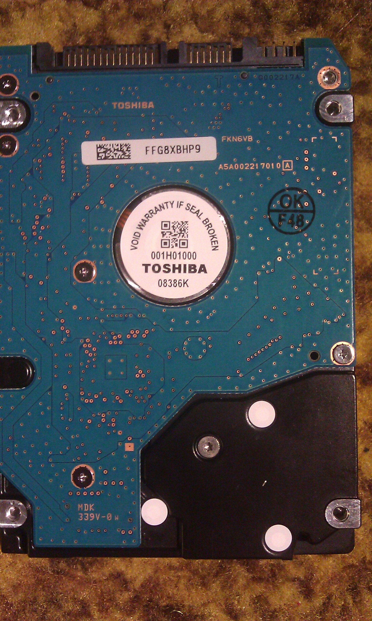

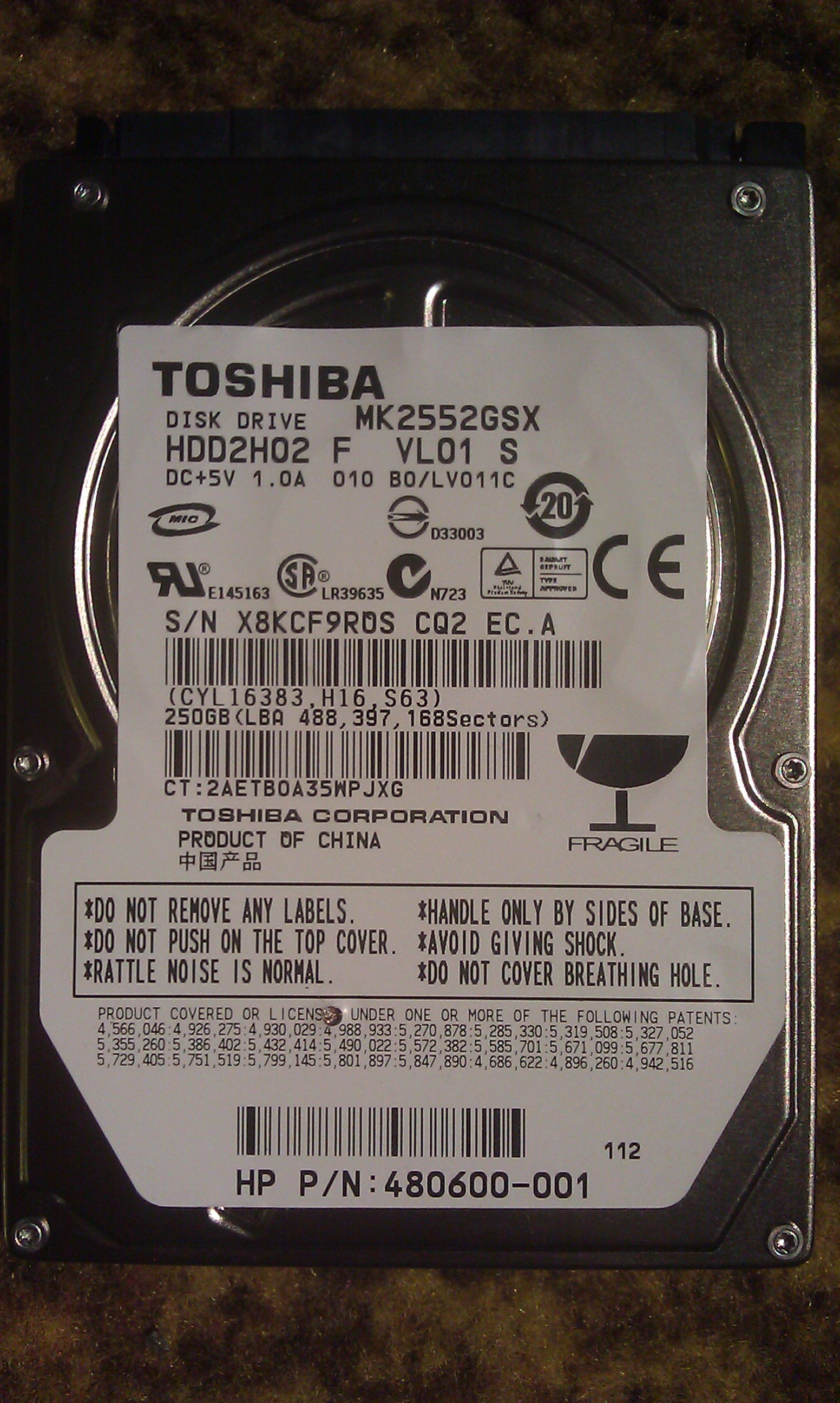

Hello, I am looking for this HDD. If anybody have whole HDD or PCB please send pm :) Thanks.
File comment: back
File comment: front

Donordrives.com has it and I'd be willing to bet they ship internationally: http://www.donordrives.com/catalogsearc ... q=g002217a
*The PCB number is etched in the top corner: "G002217A"

Thanks for your reply. I search this page and I found only some digits are same like on my PCB. Do you think, that this one could be used to my drive?
http://www.donordrives.com/toshiba-250gb-mk2552gsx-hdd2h02-f-vl01-t-g002217a-sata-2-5-pcb.html

Yep. You can also send them the bad PCB and they will move the ROM info for you. Otherwise, you'll have to solder or something similar to move that chip.

You mean this one?
Controller Chip: 88I6717-TFJ1
I think, that this numbers and letters is same like on one of the chips on my old PCB.

No, it's a small 8-leg flat chip.
