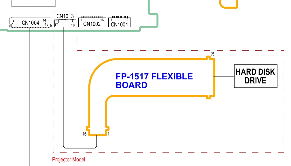

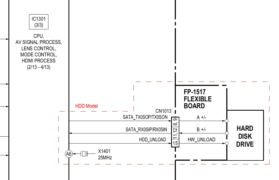

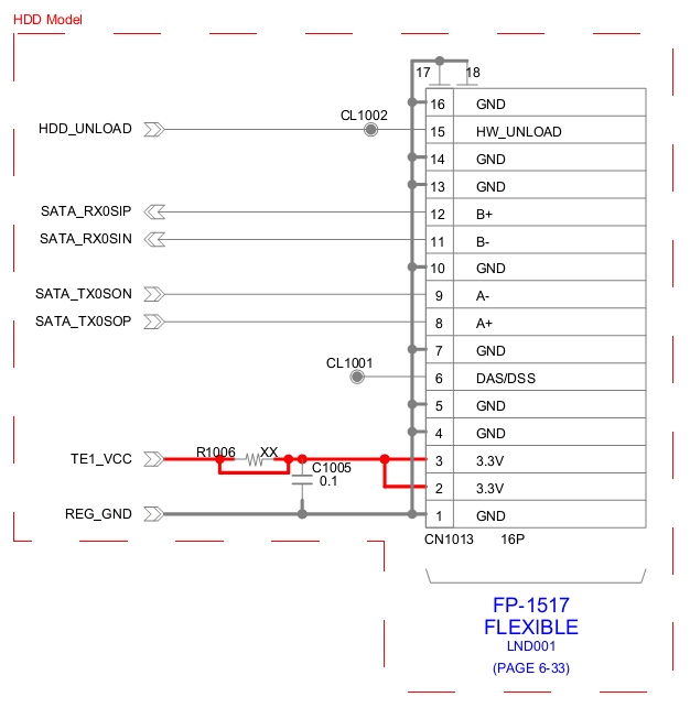

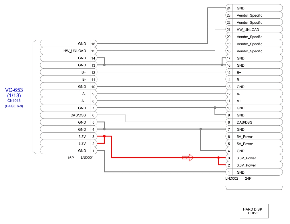

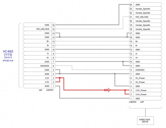

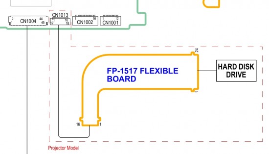

Larry, if you had researched the pinout, you have been surprised at just how little work would have been necessary. In fact the 24-pin connector reduces to 16 pins by via a special flex cable.
In addition to the standard SATA power and data pins, there are in fact only 2 additional pins. One is an output from the drive (DAS/DSS) and doesn't appear to go anywhere, while the second is a HDD_UNLOAD input. I can't tell whether it is active low or active high, but it would be easy to find out.
I found the following service manual (Level 3) which has the requisite pinouts:
Sony HDR-PJ260/PJ260E/PJ260V/PJ260VE/XR260E/XR260V Service Manual (Levels 2 and 3):
https://docs.sony.com/release/mdsm/983463634_sm.pdf (L2)
https://docs.sony.com/release/mdsm/983463611_sm.pdf (L3)
AIUI the camera accommodates the following HDD models:
    MK1639GSL
    MK2039GSL
    MK2239GSL
The HDD interface appears to have 6 vendor specific pins, only one of which has been utilised/defined by Sony (HDD_UNLOAD). The rest are left unconnected.

The DAS/DSS pin should be grounded to spin up the drive, at least for regular SATA models.
DAS/DSS = Device Activity Signal / Disable Staggered Spinup (standard SATA power pin #11)

It's always easy to be wise in hindsight, but ISTM that the customer's adapter should have given you a clue. Presumably it converts the drive's 24-pin interface to standard 22-pin SATA, so one would have to wonder what it does with the extra pins. I'm assuming that there are no electronic components apart from a 3.3V LDO regulator, so I'm guessing that the extra pins (eg the Vendor_Specific ones) would be left unconnected. This in turn would imply that repairing them would be unnecessary. A simple continuity test would have identified the DAS/DSS pin as pin #11, SATA power.

As I mentioned, pinouts were not thought to be the issue. It was the challenge of soldering so many mangled microscopic traces that I found daunting. One-to-one jumpers to the LIF connector was my proposed solution, but you've saved me much work by identifying what need not be jumpered. The most-mangled traces were the vendor specific lines and need not to be repaired, saving me much time. Thanks for illuminating that.
