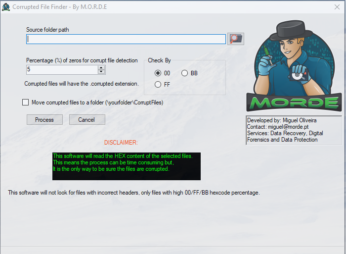

Dear DR expert,
Ever done a recovery to find out some files were corrupted? Even though MFT displays their name and size correctly? I did.
And it was frustrating to look file by file, just to have an estimate of good vs bad files to report to client.
So I decided to create a small software that will look for a determined percentage of 0's in the file hex and append a _corrupted label to the file.
Please let me know if this is something that you would use on your daily work.

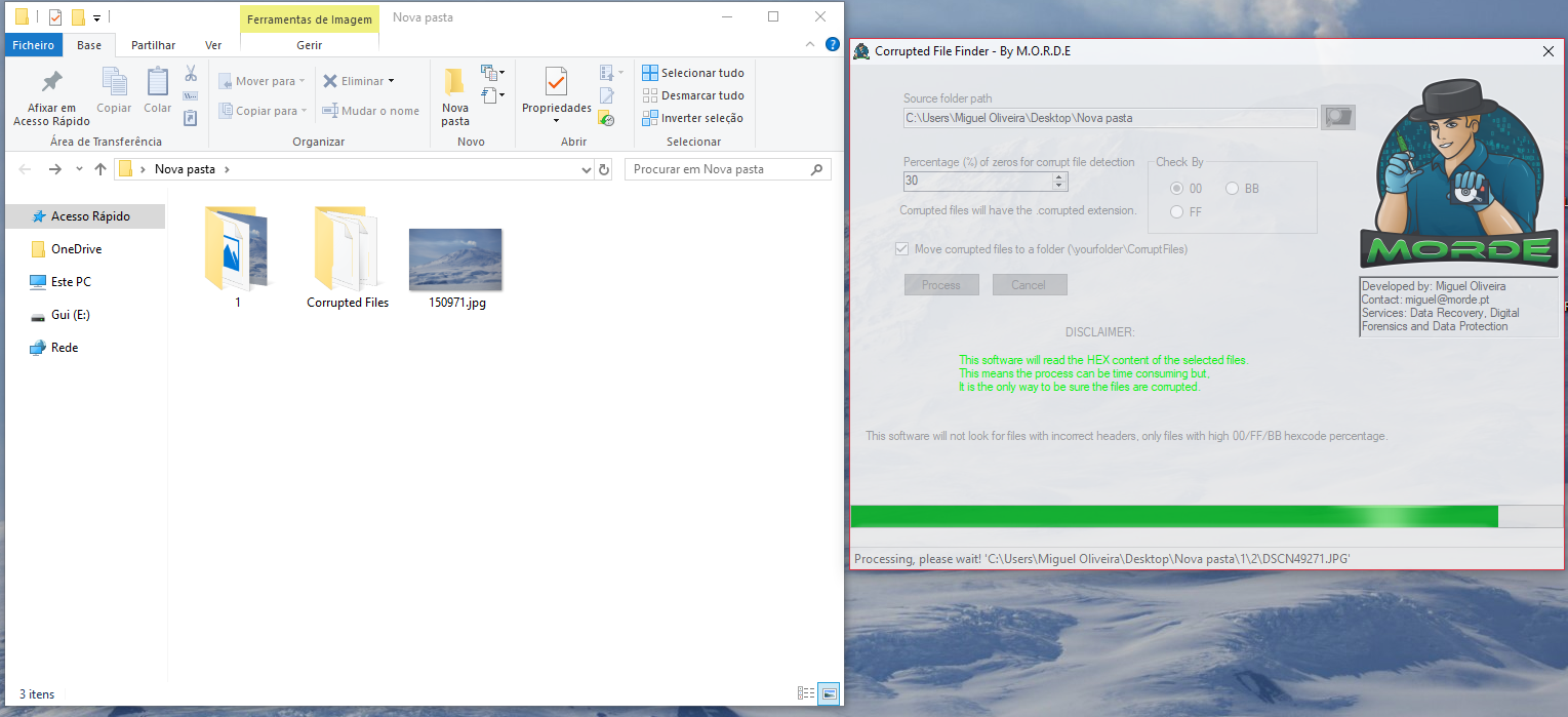

 Post subject: Re: Corrupted File Finder
PostPosted: November 8th, 2018, 8:34
Posts: 413
@LarrySabo @fzabkar
I'm still improving the inner features, but as most of the forensic software the importing and parsing of files takes some time.
If this is to be sold and not distributed freely (only will be sold if I have development costs it will be on a simbolic price)
This is how it works:
PostPosted: November 8th, 2018, 9:29
Posts: 738
Location: Ottawa, Canada
Thanks, @DRUG. Looks good so far. I would suggest allowing the "fill character" to be a user-definable variable, e.g., "B" instead of "0", and the tag to be an added extension of ".bad" rather than "_corrupted." An option to move all "bad" files to a separate folder would also be handy.
PostPosted: November 16th, 2018, 13:48
Posts: 413
@LarrySabo
I've ended up compiling and coding your sugestions.
