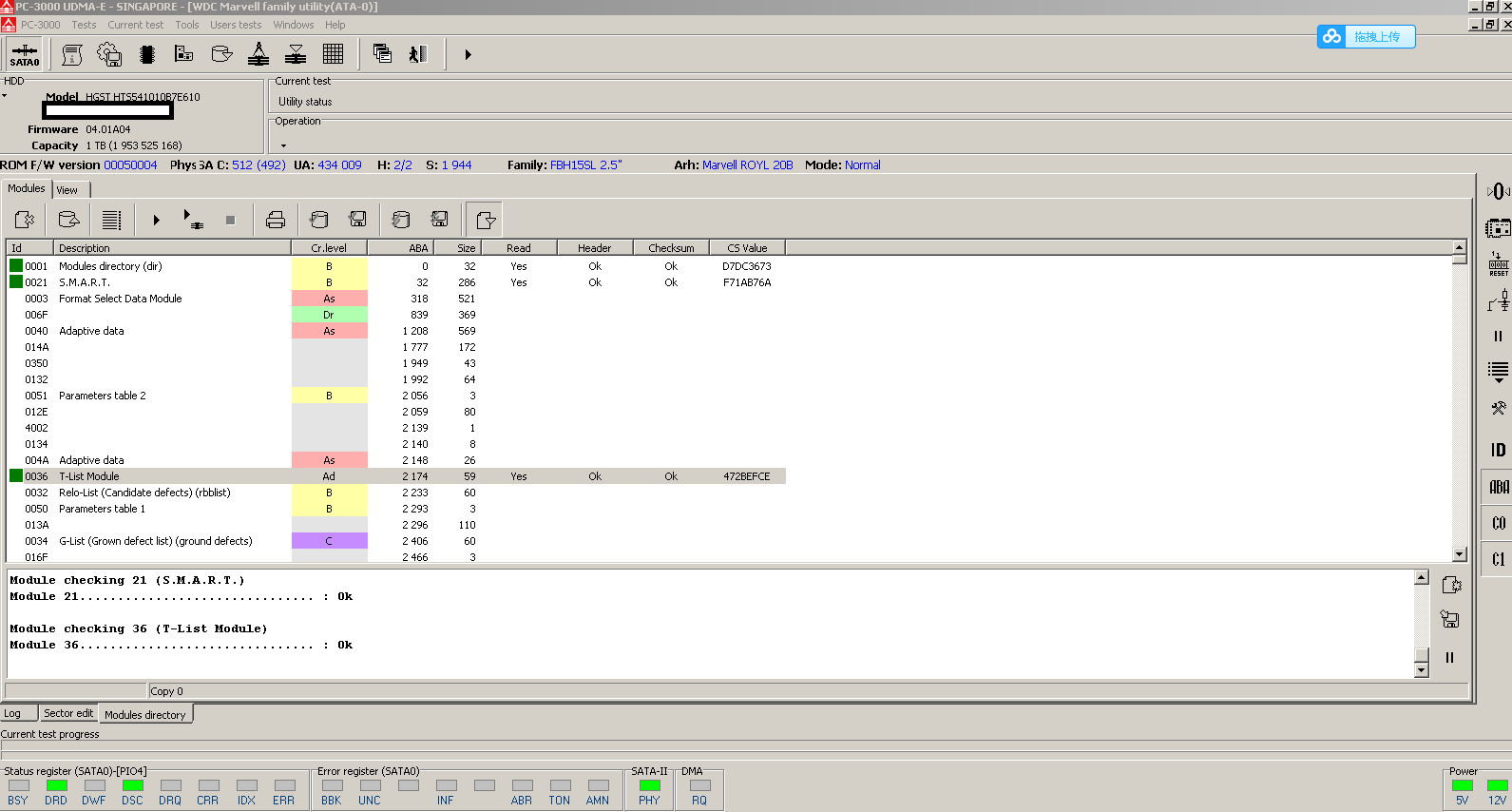

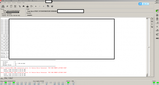

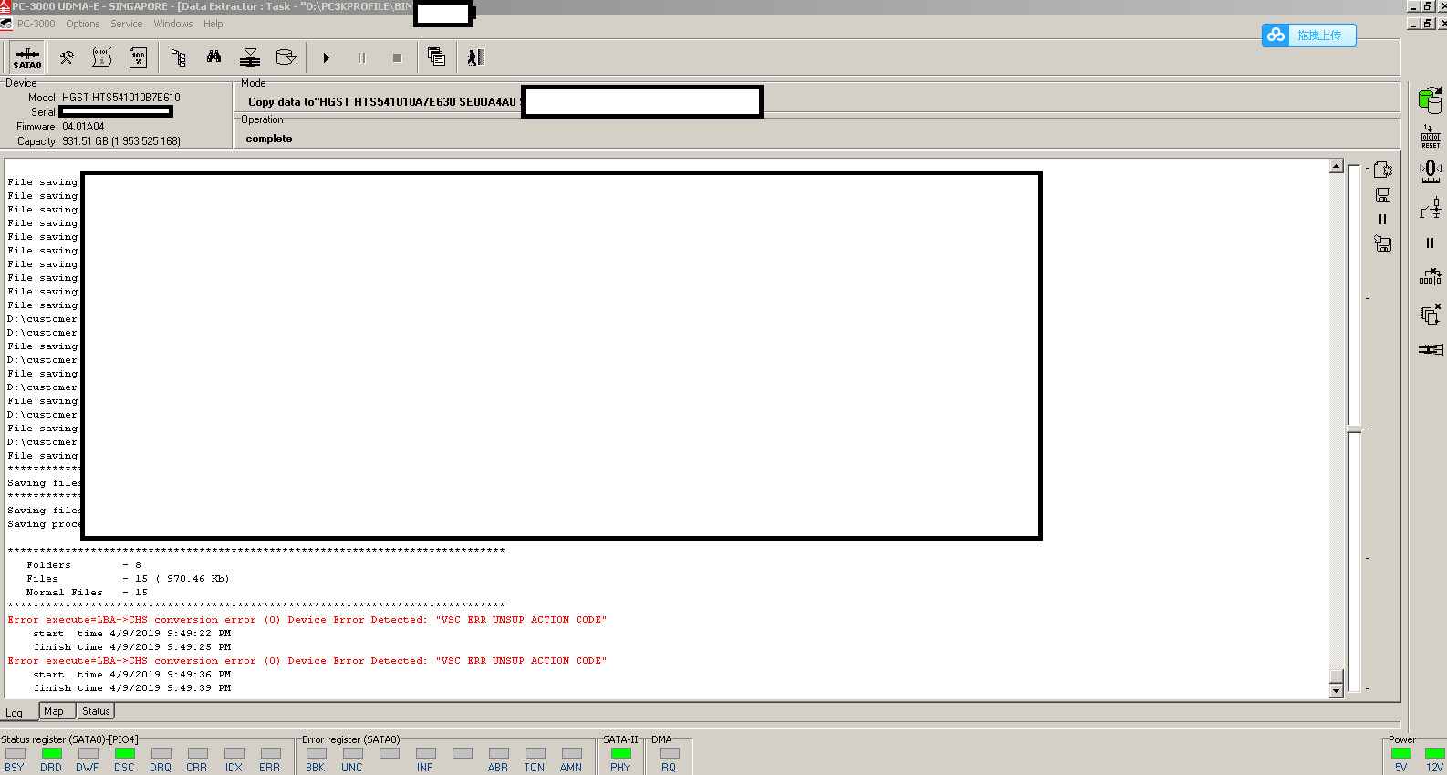

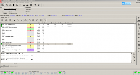

As a documentation that this thing works. somehow i can't get the head map in data recoverer.
