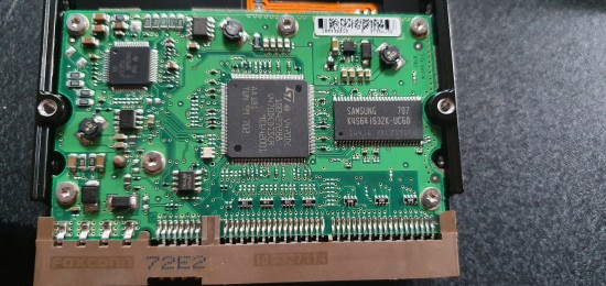

Hello
I was after some help please I'm trying to track down a pcb board for an old Seagate 320gb drive, There is no life in it whatsoever so I believe it to be a board issue although unable to see anything on the board to suggest this. When plugged into my external reader it switches it off and then when removed that turns on again. I have found similar pcb on Ali Express but not the number 100327114 any help appreciated.
You have a TVS problem.
search the forum for that issue and this will help you solve your PCB.
Good luck

Could be TVS problem, but if data on your drive is important you should stop here and "try" anything.
If data is important, you should seek professional help. If the fault is a TVS only, recovery should not be cheap.
If data is not important go ahead and fix it yourself.
For professional advice or a matching pcb, contact member here "pcimage" http://pcimage.co.uk/
Digitalsupport Data Recovery
https://digitalsupport.dk

It was in fact the TVS problem I removed the diode and it burst into life so many thanks for all your help.
