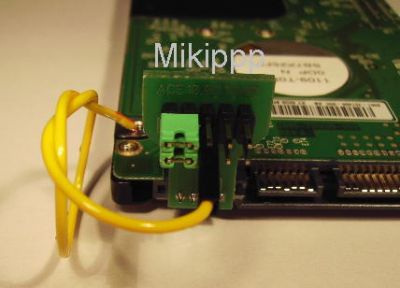

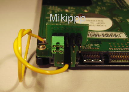

WDC 2.5" SATA HDD - PSV Mode...
[ '''''''''''''''| |''''''''' ] [....] ---> GND

Thanks Mikippp,
Your advice has helped me to solve issue.
