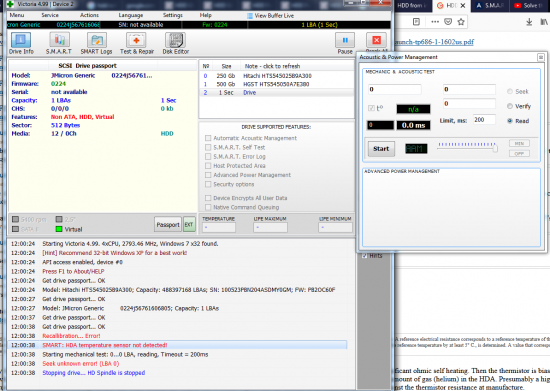

Hi guys
I can You help me to diagnose and repair my HDD WD10JPVX
It's been dropped and now it's cliking when I try to connect it to laptop.
Victoria show me me this information
11:39:09 : Get drive passport... OK
11:39:09 : Recallibration... Error!
11:39:09 : SMART: HDA temperature sensor not detected!
11:39:10 : Starting mechanical test: 0...0 LBA, reading, Timeout = 200ms
11:39:10 : Seek unknown error! (LBA 0)
11:39:10 : Stopping drive... HD Spindle is stopped
What can I do to get it working again
nothing "YOU" can do about that
send it to A "DATA RECOVERY" pro

that I know but data on it its worth 0$ so that's why I'm interested to take a look on it is this some pcb problem or internal ??
 Post subject: Re: Noise related to PCB in WD HDDs (Final Edition)
PostPosted: October 15th, 2019, 22:08
Posts: 17311
It's an internal problem. The OS is detecting the JMicron USB-SATA bridge IC, not the HDD behind the bridge.

It’s been dropped, and it’s clicking.
Zero chance it’s the PCB and it cannot be “fixed” by DIY.
