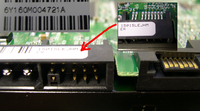

Does anyone know how to set Maxtor Calypso DiamondMax Plus 9 SATA safe mode? I got IDE diagram for safe mode but not SATA

Here is the hdd

hi Real_Jose_Pinto, the easy motherd is replace one IDE PCB, like pcba_pn lable is R5FYA. :wink:
wawalab
good luck

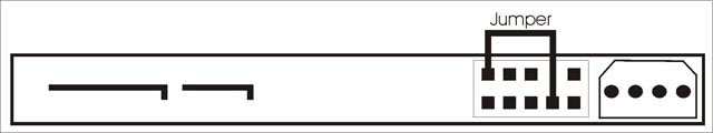

Like Starling said in another post....
It does work!

It does work for sabre not calypso :D

It does, I just tried it with a 6Y160M0 :-)
msn me for details ;-)

I could not get it working, i did set jumper as shown by Starling but the motor still spins.

Hmm, that's strange. I just tried it again. Works fine.
Electronic "noise" comes from the PCB, but motor does not start, for me.
Load loader (takes up to 1 minute), then motor starts and all OK.
Check the pins again, I see your pic is upside down from Starlings drawing.

i have tried replacing the sata pcb with ide pcb both having same processor chip works good for me .
