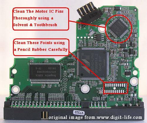

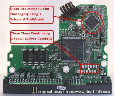

2- The Continuous Noise
sometimes there is a continuous noise come from WD HDDs mainly with L-shape PCBs
with motor ICs ( Smooth 1.3) , (L6278 1.7) & (L6278 1.2).
the noise is like : Trrrrrrrrrrrrrr or Trrrr....Trrrr...Trrrrr
so all we have to do for fixing this problem is:
1- clean the connection points which connect the head stack pins with the PCB using a pencil Rubber ...carefully.
2- clean the motor IC pins thoroughly using a solvent & Toothbrush then wipe it with a piece of smooth handkerchief to remove the dust & dirt from it.
-Note- the two steps mentioned above solve the problem in few cases.
3- if the two steps mentioned above didn't fix the problem , you have to replace the motor IC cause it's damaged.
-Note- in case of Motor ICs (L6278 1.7) & (L6278 1.2) first try to desolder them then resolder them again before u decide to replace them with a new ones ... this sometimes work , but if it didn't work ... replace them directly.
- in case of Motor IC (Smooth 1.3) you must replace it directly.
The image below Shows you where to clean.

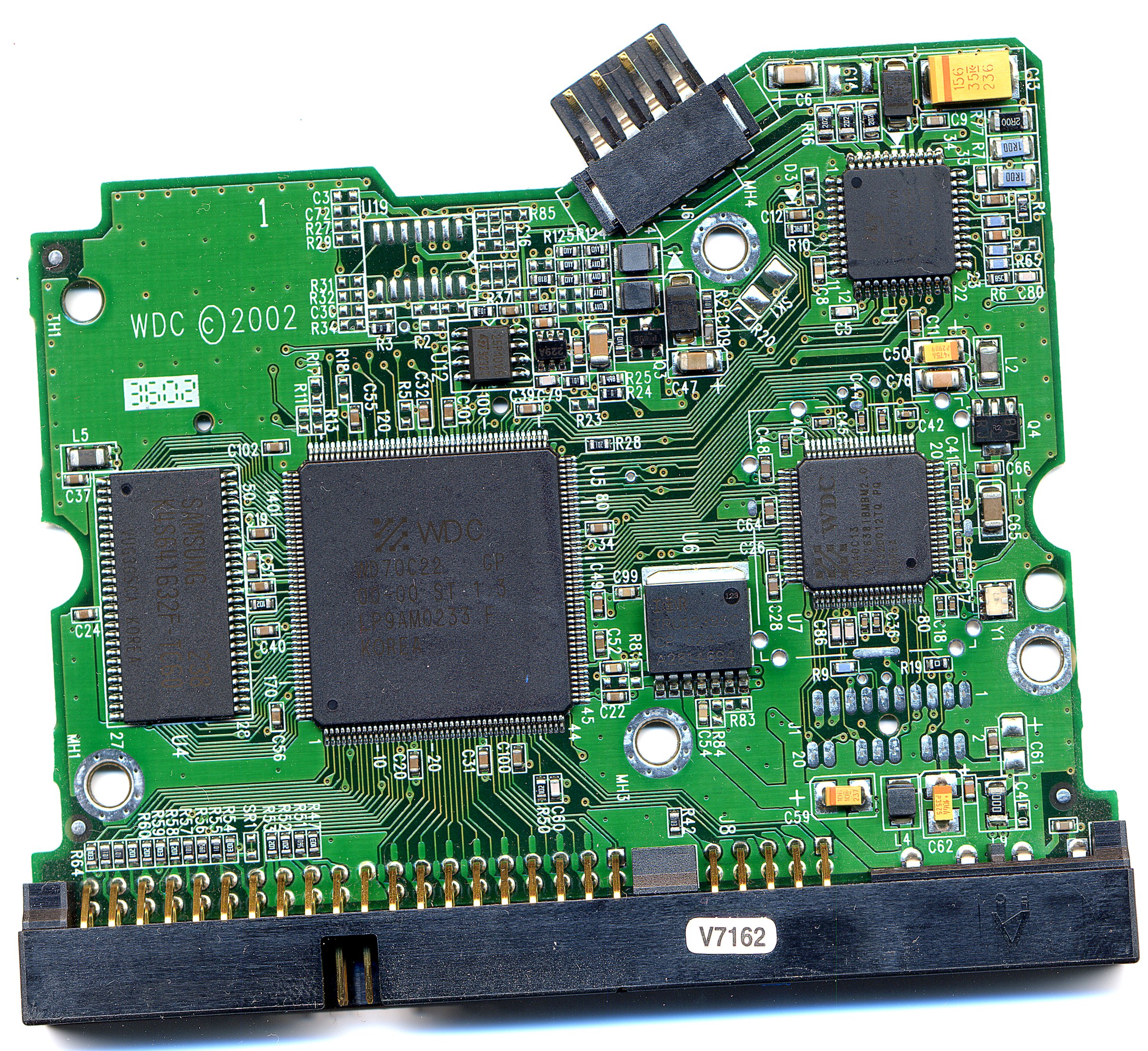

Hi Ahmed,
Thanks for your fantastic article. However, I do not have an L-Shaped board and I'm having trouble finding some of the components you referred to. I have put a picture of my board at the following link; I'd be grateful if you could highlight the components on it and email it back to me. I will repost it there so that other people can refer to it too.
http://www.leapbeyond.com/ric/WD1200JB%20board.jpg
Also, do I have to desolder the components to test them, or can they be tested directly on the board?
Thanks!
-Richard

your board is a different model - most of the components i have mentioned above
belongs to WD L-shape PCBs.
just tell me what is the problem with this board , so i can help you :) .... is it a clicking noise issue ??
about testing the components , you can test them directly on the board with the multimeter without Desoldering them.

Thanks for the fast response! Yes it is a clicking noise. When I power on the drive, it spins up and goes "Click, click"... pause... "Click Click". It does this about 10 times then spins down.
-Richard

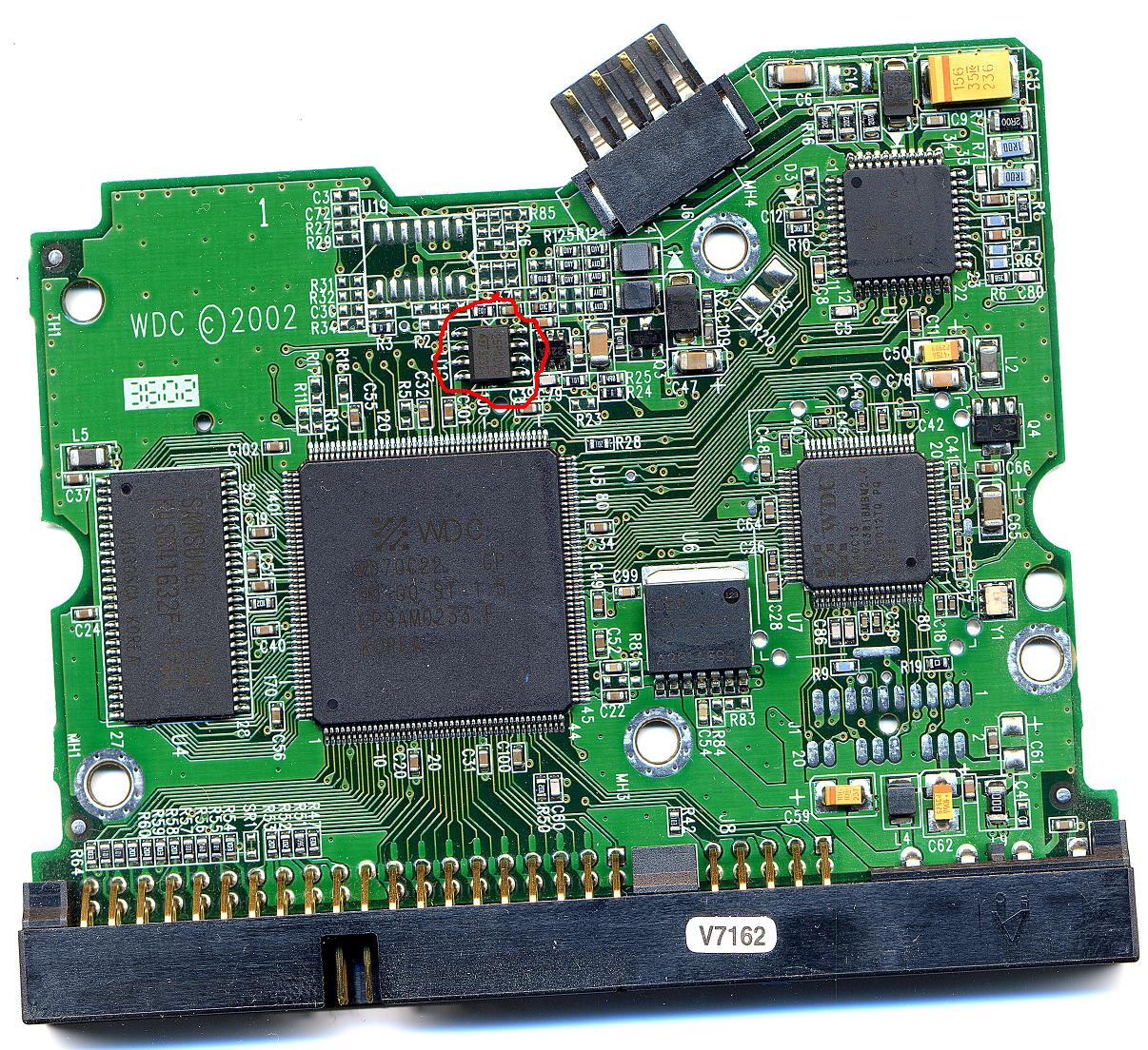

Hi Richard,
The clicks in your drive can be 4 tings: faulty Pcb, Firmware, preamp/heads or scratched platters.
You should try the Pcb first, that you do by:
1.Buy a new/used drive or Pcb of the same harddrive model you got (WD1200JB).
2.Desolder the ROM chip (U12, red ring in the picture) on your old board.
3.Replace the chip on the new board.
4.Start up the drive and access your files.
If your drive still knocks or clicks after that, the problem is further down the line and not so easy to do without special tools.
Regards/ Bosse
