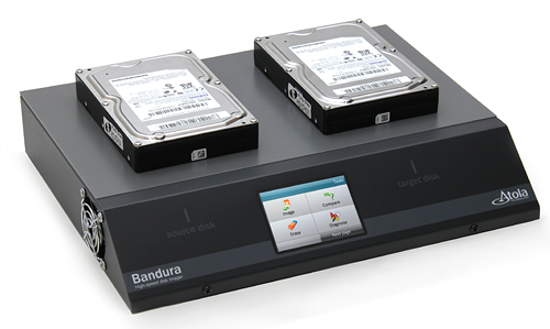

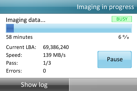

Hello Everyone,
I would like to quickly introduce our new product Atola Bandura. It is a high-speed 1:1 multi-pass SATA disk duplicator that can image hard drives with bad sectors. It reads most of the data as quickly as possible on the first pass, then reads the rest. As a bonus, it can also automatically diagnose, wipe and compare drives.
It is so easy to use that we even had a trouble shooting a video of an imaging session :mrgreen:
Have a look: http://www.youtube.com/watch?v=K3wM0U9-3qI (it is a 40-second video)
Bandura specs
Bandura vs other imagers
Screenshots: Duplication, Wiping, Diagnostics, Comparison.

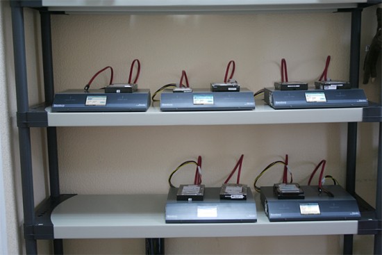

5 Banduras :)
