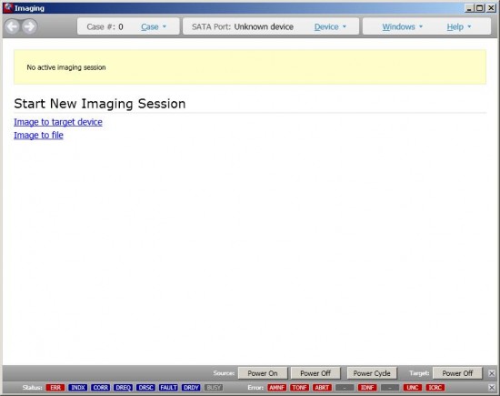

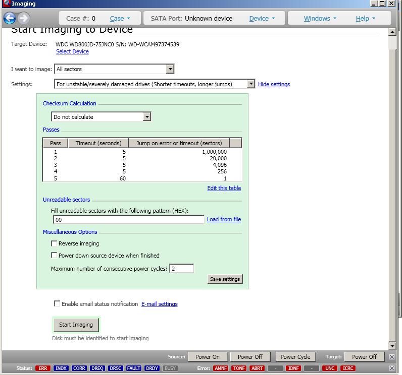

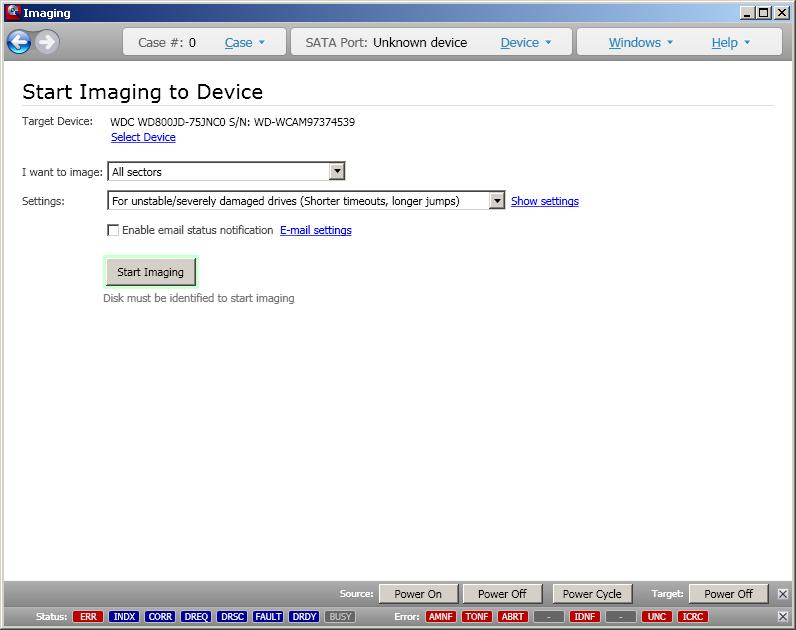

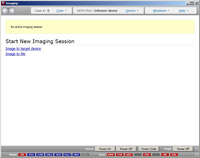

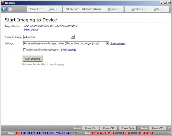

Outside mirroring a blank drive to the destination, I cannot find any way to wipe a drive on the Atola Imager. If there is an option to do this, please let me know how.
 Post subject: Re: Deepspar V Atola Imager - actual comparison
PostPosted: March 26th, 2010, 11:35
Posts: 249
come on dude!! the "prepare destination" window. What version of Atola do you have?
http://www.atola.com/products/insight/d ... ation.html
PostPosted: March 26th, 2010, 11:51
I thought I got the most up-to-date version from the Atola website. However, my screens don't have the sidebar option that shows on your screen. Perhaps I somehow managed to get an older version. What version is it at? I've been running 1.4.4.31437

That's the full Atola product that mediaman is referring to. Luke, my screens are the exact same as yours.
Data Recovery Ireland
PostPosted: March 26th, 2010, 13:28
Thanks...I just want to be sure that I'm comparing the correct product. Now that we have the confirmed...where is this "prepare destination" window found? I have a drive connected to the destination side and no drive connected to the source and would like to wipe all the sectors on the destination.

Prepare Target function is available only in Atola Insight at the moment. But I think it may appear in the next release of Atola Imager.
