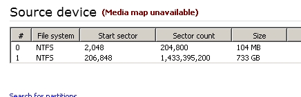

Dmitry, thanks, I think I have found a solution: use a NEW imaging session with custom range starting one block up from previous session.
If you could show us the MBR code and boot sector code, then that will tell us which OS was responsible for each sector.
As for the "NTFS boot sector at: 63", that appears to be a FAT boot sector. The sector count of 61448562 corresponds to about 31GB at 512 bytes per sector. That's about what you would expect if you tried to create a FAT32 partition in Windows XP and later.
Sector 2048 does appear to be a standard NTFS boot sector, but its size amounts to about 104MB (= 204799 x 512). That's the size of the reserved partition in a Windows 7 system. There must be a second NTFS boot sector at about the 104MB mark. You should also be able to locate its backup by reverse searching the drive.
In short, it does appear that the drive's owner is not telling you the truth.

The curios thing is that the File recovery feature of Atola appears to use a different logic to the "image all partitions with data" as it produces the result shown attached. Showing an initial 104mb partition, as Part 0 and the correct 733Gb rest as Part 1.

I don't see anything wrong with Atola's interpretation. Atola simply examined the partition table and reported what it found. It is up to the operator to make sense of the report. To this end one would expect that the operator would examine the usual suspects, namely sectors 63 and 2048.
IME users often repartition (aka "initialise") their drives and/or format them in some desperate attempt to recover their data. In fact it's obvious that your drive was repartitioned and formatted at least three times in its life.
Since the drive was in a laptop, it would be reasonable to expect that a user would attach it to another machine, either directly via SATA, or via a USB port. This seems to be the standard advice in the user forums. Unfortunately your customer appears to have encountered a 4KB sectored enclosure. Windows most probably reported nonsensical partition sizes, and the user has then compounded the original problem by repartitioning the drive.
