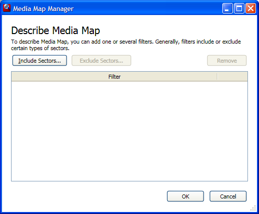

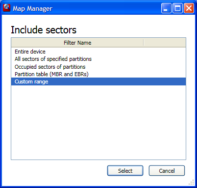

It is possible to set random ranges. Here's how:
First, select "I want to image: Custom...", then click "Create or load media map"
Then click "Create new map"
Click "Include sectors..."
Select "Custom range"
Enter first range. You can add as many ranges as you want.
