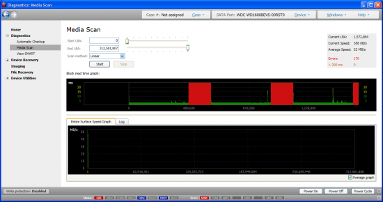

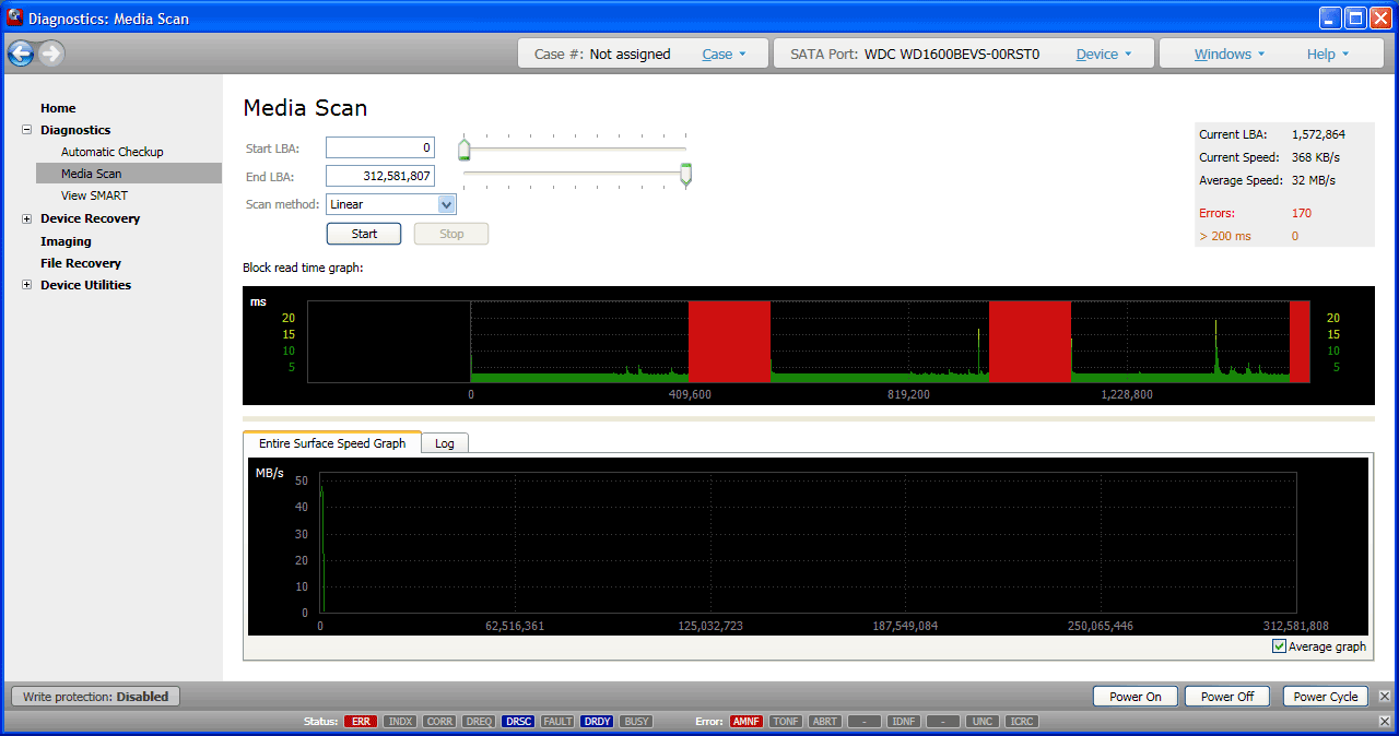

1: At this time this is achieved via LBA scan. Here's an example (click to enlarge):
Atola Insight Damaged Head example (head 3 damaged).png [ 25.37 KiB | Viewed 22957 times ]
There's also automatic diagnostics that uses LBA scan to watch for timings. It will let you know if there's an issue with any head.
We will add functionality to test heads with vendor-specific commands at a later date (at this time this is a low-priority task, mainly because no one requested such feature).
