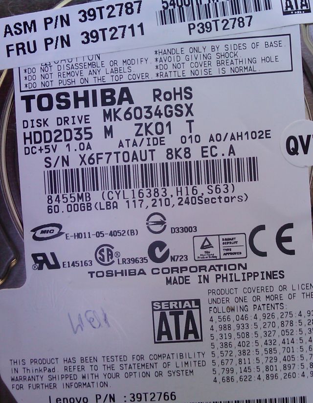

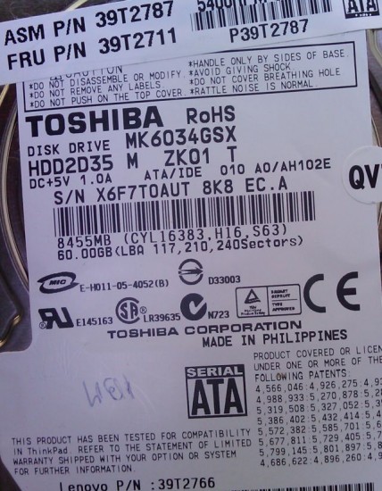

 Post subject: TOSHIBA MK6034GSX COD reported as bad PCB?
PostPosted: November 24th, 2009, 23:48
Posts: 249
The disk has classic HSA symptoms but Atola 1.4 reports circuit board.
Any ideas?

(furiously looking for donor) thanks Dmitry, will try and feedback results. What does that register value mean?
