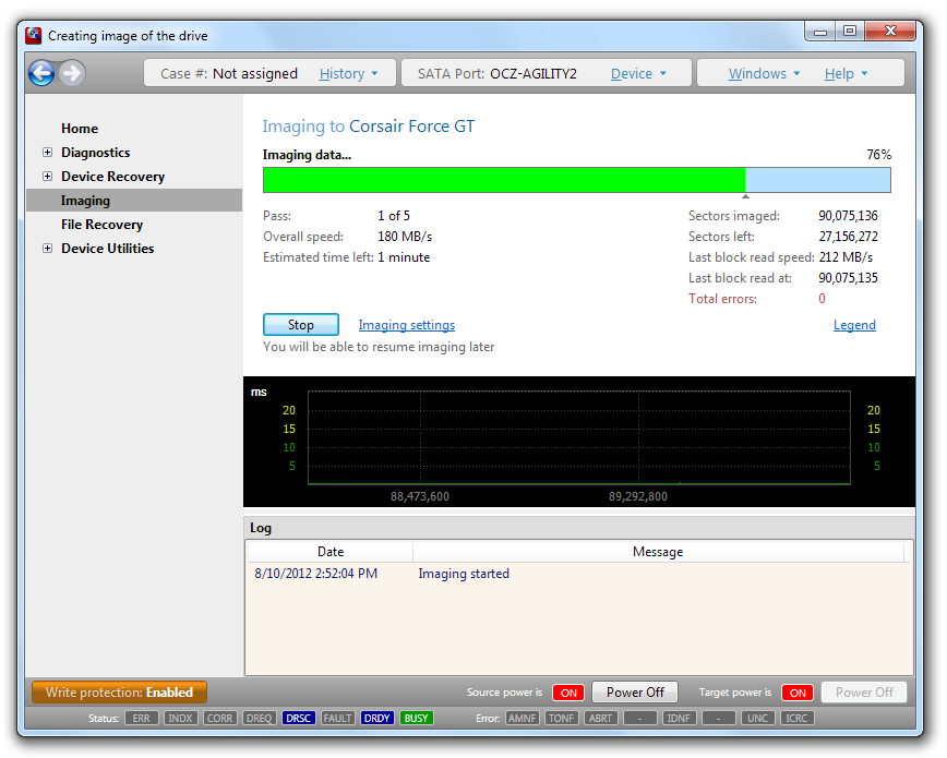

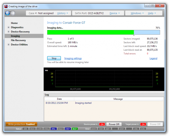

Dear customers,
We have released Atola Insight 2.6 recently spending much time over its features during the development process. The most noticeable of them are:
  • Improved handling of damaged drives on DiskSense Ethernet units;
  • ExFAT support;
  • Files now have an integrity indicators showing what their parts Insight actually copied during the imaging process;
  • File list generation in File Recovery;
  • Disk-to-Disk imaging is sped up to 180 MB/s on DiskSense Ethernet units (see the attached screen shot below).
Pay attention you may learn more detailed release information with screen shots or check out the full Atola Insight 2.6 change log.
It would be great to get any feedback from you. If you want to tell ask/complain/praise the latest Atola Insight 2.6, please do not hesitate to write it here! Every your opinion is really valuable for us.
What do you like or dislike in the latest release?
Did you feel any speed increase while imaging via DiskSense Ethernet unit?

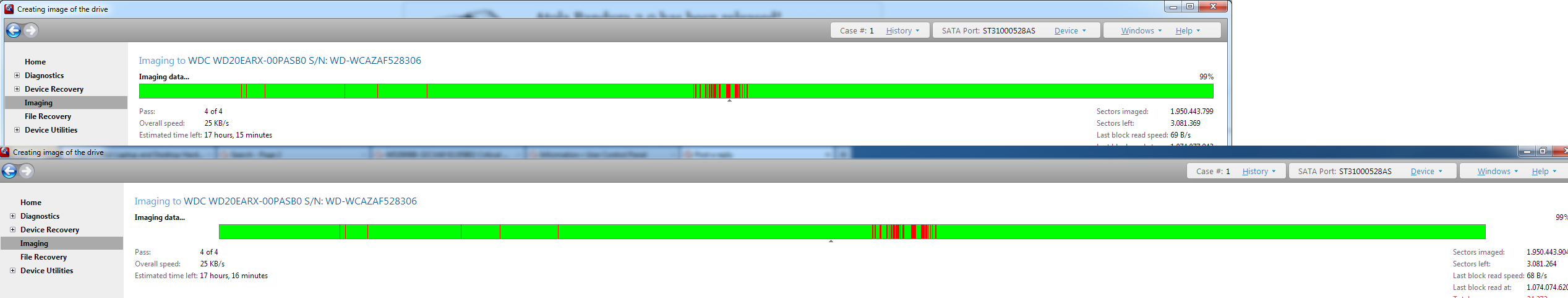

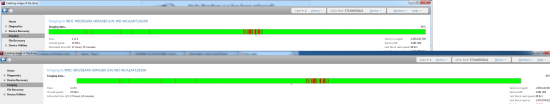

I have Atola Insight 2.6.4595.29524 running:
1) In "Imaging"
When I maximize the window - I have screen resolution 2560 x 1440 - then the little triangle in the "progress bar" has an offset (see screenshot)
2) It would be nice to have a "line per head" in the "progress bar" in the head map mode to see the errors per head immediatly
3) A zoom functionality to zoom into the error patterns would be nice (if it is like the one in the screen shot)
File comment: Screenshot of triangle offset
Thanks a lot for informing us about this bug.

A bugfix for maximised window issue you described will be included to the next Atola Insight release.
