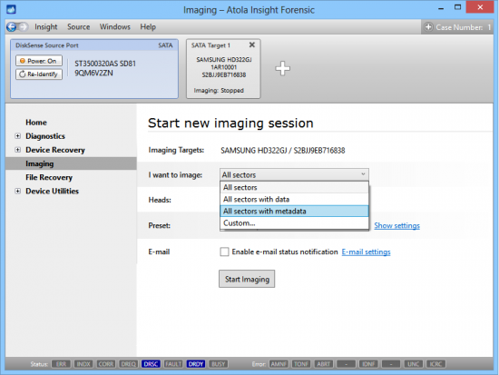

  • Imaging: new Metadata-only imaging mode allows copying of absolutely minimum amount of data for file browsing to work, this allows for imaging of specific files

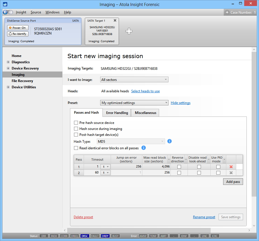

  • Imaging: Settings can now be saved into custom presets

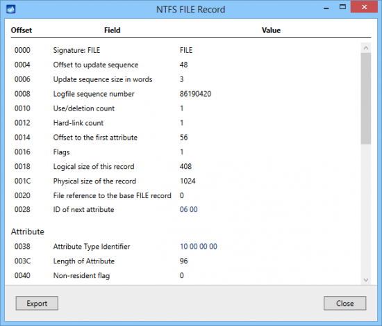

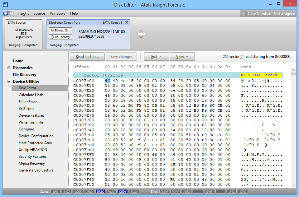

  • Imaging, Disk Editor: when viewing sectors, known metadata will be automatically parsed into a human-readable form

File comment: Automated sector analysis for FS structures

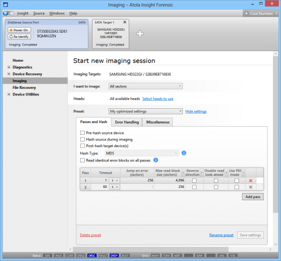

File comment: Imaging presets

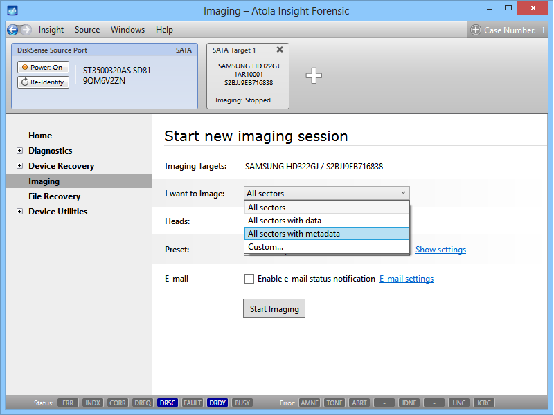

File comment: Imaging all sectors with metadata
