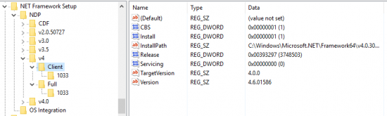

I'm trying to install Insight 4.4 on a fresh windows 10 and it keeps trying to install .net 4.6.1 and it fails, win10 has a newer version already install and I can't past that step to install the sql,hasp and insight. how can I bypass it?

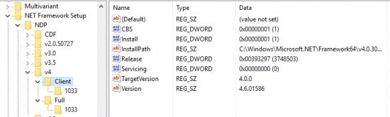

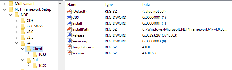

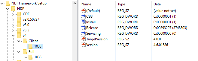

Thank you for the answer Vitaliy, I made the changes but still have the same issues.

Spildit wrote:
Release value 393297 should be DECIMAL and NOT HEX
On your picture you have set the value as HEX (0x) and not as DECIMAL.
Thank you Spildit for pointing my mistake :oops: I got it installed , thank again
