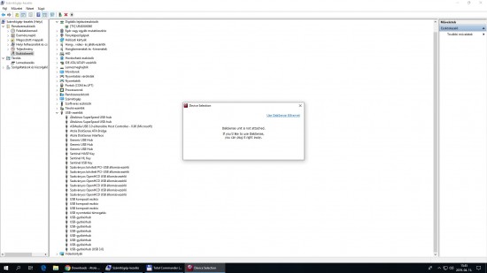

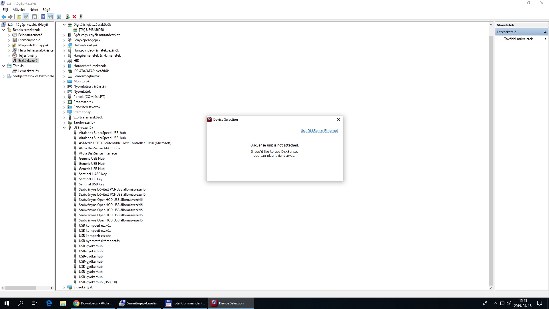

 Post subject: Re: Atola Insight USB device drivers for Windows 10
PostPosted: April 15th, 2019, 9:51
Posts: 330
Hi!
I have an Atola Insight USB, with program version 3.4
I updated my system to Windows 10, installed drivers, and the Atola Insight software does not find my Disk Sense Unit.
What did i wrong?
PostPosted: April 15th, 2019, 13:13
saltwater wrote:
What did i wrong?
You bought Atola. That's what :lol:
