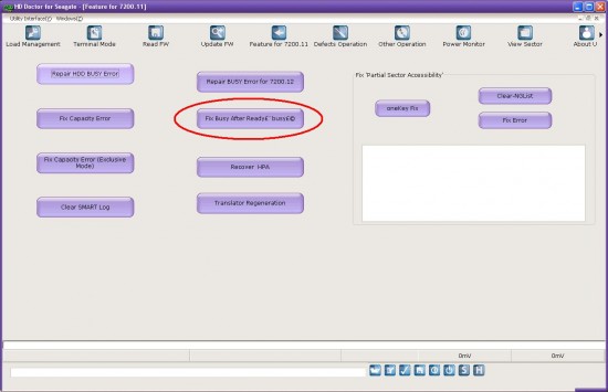

"Fix Busy after Ready" is the new function of Seagate Doctor.
Salvation is not even able to write correctly the script on the button :lol: :lol:

Hi guys, use this "ini" file to fix this problem.

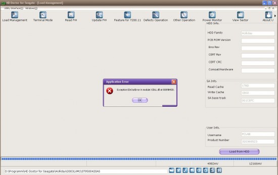

Why do i get this error when loading "load from hdd" since i updated to version 7.0?

I can't even save mods because when i try it appears appears always this error.
I tried to install again version 6.0 but it doesn't even boot anymore 6.0, i receive "soft. version error".

I did some more experiments!
I have found that i receive this error only on 2.5" drives, on 3.5" i don't get EInOutError.
I tried on 2 2.5":
1) Momentus 5400.6 ST9500325AS (Wyatt family, fw 0002BSM1) ----> i backup SA mods of this when i had version 6.0
2) Momentus 7200.4 ST9500420AS (Holliday family, fw 0003LVM1)
on both this 2.5" i get EInOutError in module XJDDL and is impossible to backup SA mods, it's possible only to work in terminal.

Problem solved!
I installed a new fresh XP 32 bit, now Seagate Doctor is working again properly.
I guess this is a bug of version 7.0, if your operating system is not clean it might interfere with usb Seagate Doctor communication and you will not able to use it.
Also, when you install version 7.0 for the first time, it automatically updates the firmware inside Doctor hardware, then you will not be able to use again version 6.0 or previous versions.

I just found out that there are 2 different .exe files for the Seagate HD Doctor 7.0.
HaQue posted the download link of first .exe version which is not good
The second version of 7.0, which worked good for me, you can find here:

Now i'm sure, the first release of Seagate 7.0 linked by HaQue is not good.
This is the good one:
down.xlycn.com/download/HD Doctor for Seagate 7.0.rar
