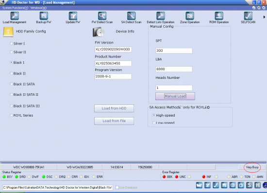

hello friends
how can solve this problem
i am change the pcb & rom swap.hard disk very slow detected

Have you checked the firmware modules?

I THINK YOUR HEAD IS WEAK SOME TRICK TO HEAD IS ALIGN NOW
Re: very busy
May 23rd, 2013, 15:20
Abdul you need to perform more diagnostics or gather more experience using the WD SD Doctor.

moiz h/d wrote:I THINK YOUR HEAD IS WEAK SOME TRICK TO HEAD IS ALIGN NOW
What is your evidence?

lolxx thats dell guy i am not say thead problem is 100% sure isay i think this is a head problem i hav fix lot of drive for this issue r u understand????

Try giving soft reset every time it gets busy .
Did u regenerating translator before this happened ?

Hi Dear Friend Abdul
Check The Modules. And Glist.
