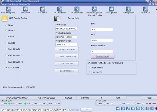

I got wd 1600aajs-75mqa0 data not show.

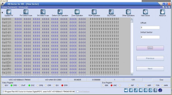

What i did : I checked all moduls are ok and translator regenaration ok (completed).
View sector see pic.
Pls your advice to access the data .

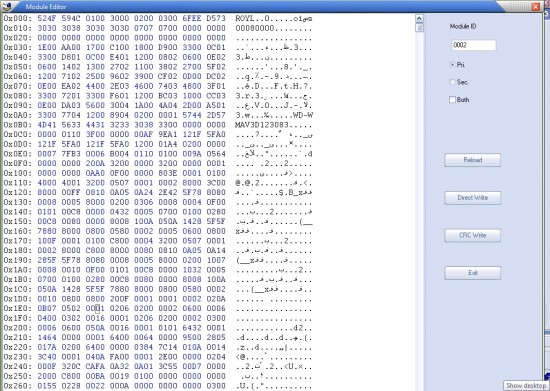

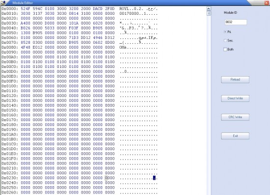

can you post MOD 02 and 32 here ?
Re: wd 1600aajs-75mqa0 data not show
June 11th, 2015, 4:29
Mod 2& 32
June 11th, 2015, 7:05
i'm sorry to tell you, but when someone ask to upload some file/s you don't upload them as a screen shot you upload them as a file
June 12th, 2015, 13:50
Verry sorry miss anderstand.Pls find the attachment files.
