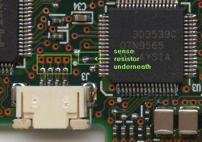

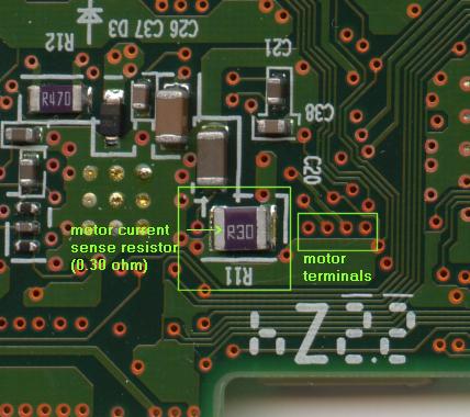

FWIW, here are photo clips showing the location of the motor current sense resistor for a Hitachi HDS722580VLAT20 drive:
http://www.users.on.net/~fzabkar/HDD/HD ... ense_R.JPG
http://www.users.on.net/~fzabkar/HDD/HD ... r_cont.JPG
The sense resistor is on the underside of the PCB.

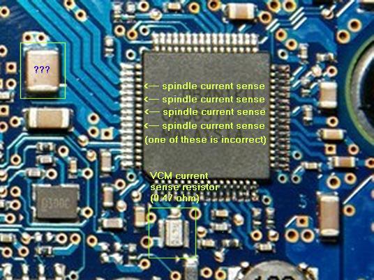

I have identified several points on your PCB:
http://www.users.on.net/~fzabkar/HDD/HU ... _sense.jpg
I believe the R470 (0.47 ohm) resistor is the VCM current sense resistor.
I believe that three of the four pins that I have identified as "spindle current sense" would be connected together somewhere on the circuit board. That "somewhere" should be one end of the current sense resistor, assuming it exists. The other end would be connected to ground.
The component that I have identified as "???" looks like a capacitor, but I'm not certain.

fzabkar wrote:The component that I have identified as "???" looks like a capacitor, but I'm not certain.
This element is a capacitor. I've made some measurements of voltages on almost whole 2TB PCB.
All measurements where made with multimeter GND connector connected to GND of PCB.
On this resistor as You mentioned "I believe the R470 (0.47 ohm) resistor is the VCM current sense resistor."
there is 6.46V when powered on, and when bzzz comes, it drops to almost 0V.
Also I've noticed that on NVRAM chip during bzzz time, there are several 2.5V on pins, and some 0V pins. But after bzzz
stops 0V pins becomes 2.5V pins. And the another thing, during voltage measurements on NVRAM chip, I've discovered
that PCB starts to bzzz again, if measured on pin 7.

I've looked at your results several times, but I still can't see how your board senses motor current. I would have liked to see the voltage on each of the spindle sense pins, but probing these points with a multimeter has a very high risk of catastrophic damage. If your multimeter's probe tip is too large, you could try affixing a sewing needle to the end. At the very least, it would be useful to know the resistances between each pin and ground.
The R470 resistor does appear to sense the VCM current. When the voice coil is stationery, the voltage at R470 should sit at about the midpoint of the supply rail, ie 6V. The following diagram depicts the H-bridge configuration of the four MOSFET drivers (Q1-4) inside the motor controller. When Q1 and Q4 are switched on, current flows from left to right through the VCM. Conversely, when Q3 and Q2 are switched on, current flows from right to left. The voltage, V, across R470 reflects the VCM current as follows:
Ivcm = V / 0.47 ~ 2 x V

Your observation in regard to the NVRAM pins suggests to me that the motor controller may be responding to an overload condition by sending a Power-ON Reset (POR) signal to the MCU.
As for your other voltage measurements, the 1R1 coil and XY/XZ MOSFETs constitute the +1.26 Vcore regulator for the MCU.
The 100uH coil to the left is the +2.6V Vio supply for the MCU, NVRAM, and SDRAM.
The two 100uH coils at the bottom constitute a Cuk converter that supplies -5V for the preamp.
The two white rectangular components are piezo shock sensors. The adjacent ICs appear to be op-amps that amplify their signals.
The 18V capacitor is associated with a charge pump. It appears to be working correctly.
I believe that the IC near the motor terminals may be a quad op-amp. I suspect that it may provide second stage amplification for the shock sensors, plus two additional functions (?).
LTC6079, Linear Technology, Micropower Precision, Quad CMOS Rail-to-Rail Input/Output Amplifiers, 16-pin SSOP, 2.7V to 5.5V:
http://cds.linear.com/docs/Datasheet/60789fa.pdf

fzabkar wrote:I've looked at your results several times, but I still can't see how your board senses motor current. I would have liked to see the voltage on each of the spindle sense pins, but probing these points with a multimeter has a very high risk of catastrophic damage. If your multimeter's probe tip is too large, you could try affixing a sewing needle to the end. At the very least, it would be useful to know the resistances between each pin and ground.
Hi, I've measured sense pins according to GND, ad all seems to be direclty connected to GND.
As for voltages on those pins they look like this:
Looking from top:
1. 0V
2. 12.47V
3. 0V
4. 12.47V
The R470 resistor is 470 Ohm or 0.47 Ohm cos I'm confused because, when I tried to measure R470 resistance between R470 and GND the resistance was different on different setting of scale in Ohms on multimeter:
1. in scale of 20k - it showed 6.7kOhm
2. in scale of 200k - it showed 15.2kOhm
3. same R470 measured on both end shows 0.47 Ohm
Weird thing.
Re: FW for Hitachi hua722020ala330 - 2TB Hdd needed
April 10th, 2012, 17:24
The "R" in "R470" is a decimal point.
R470 = 0.47 ohms
470R = 470 ohms
47K = 47,000 ohms
4K7 = 4.7K
4R7 = 4.7 ohms
Your resistance measurements confirm that R470 is "floating", ie it is not connected to ground. My ASCII circuit diagram illustrates this. Perhaps ASCII is not the best format for such diagrams ...
Anyway, the R470 resistor is now just a distraction. We have already eliminated it as a suspect.
That said, I confess that I'm out of ideas. I don't understand how the motor controller senses the spindle motor current, except perhaps by some internal means. BTW, the voltage across a motor sense resistor would be zero when the motor is not being driven, so your static voltage measurements would be inconclusive.
All I can suggest now is for you to measure the voltage across the motor sense resistor in your DeskStar drive, both during spinup and in run mode. That should give you some insight into how this part of the circuit works.

Sorry, it appears that those pins are in fact supply pins, not sense pins as I suspected.
Test point #3 does not stand out as a sense pin, either. I would think that if your board did have a spindle current sense resistor, then it would be of the order of 0.5 ohm or less, in which case the voltage during spinup would be about 1V (assuming a startup current of 2A), and about 0.5V during normal running (assuming a run current of 1A).
I really don't know where else to look. :-(
